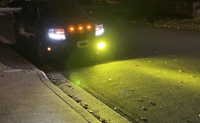

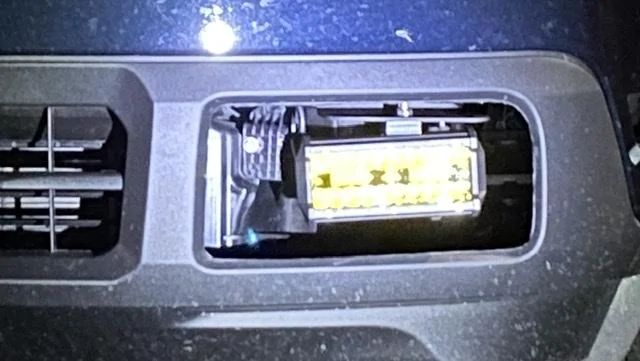

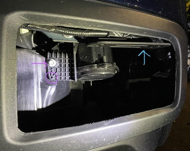

I found out why there's no readily available fog light kit. Because the Hybrid at least was not meant to have fog lamps, or tow hooks. Took me all afternoon to put in one lamp. And I discovered a surprise. The artificial engine sound speaker is behind the driver's side panel that looks like a place for a fog lamp. Those of you looking at grille mounted lamps, I'll tell ya now.... that's probably the better option. I'm half-way in so gotta finish now. Hopefully no surprises on the passenger side.
I got a metal bracket off Etsy.
I cut the plastic out with a Dremel like tool. Started small then enlarged the hole. BEWARE there is a wire bundle running along the TOP edge of the rectangle "cut outs". Then I smoothed the edges using a file.
BEWARE where the tow hook would be, there is the engine sound speaker about an inch or two behind the plastic. More space to the tire side. But then my lamp would not be centered. Alas, I still cannot get it absolutely centered because the sound speaker is in the way.
Lastly I will need to fabricate some kind of bezel to go around the light. While functional as-is I don't like the open look, and the sound speaker should probably have a layer of protection.
The Etsy brackets work, but you'll need to remove the sound speaker, bolt in the bracket, then reinstall the sound speaker.
The Etsy brackets work, but are a tad too long. They sit "proud" beyond the edge of the truck bumper. Not in love with that. MAY shave them down later. First photo shows bracket a little proud.

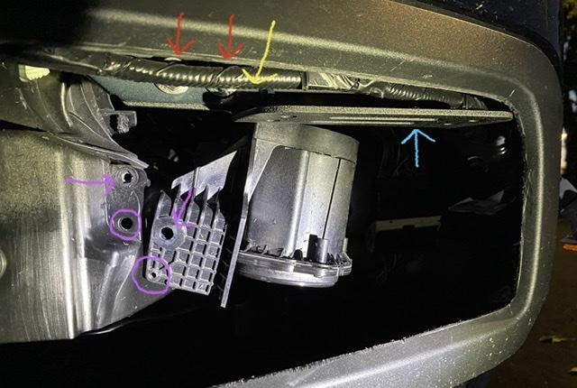

Ford Maverick Fog lights for Maverick ? 7E11B572-2742-4E5E-BA42-BAD2B296EFE9
Yellow = cable bundle to be aware of.
Pink is speaker screw hole with solid pin.
Red = bracket bolts
Blue = bracket
Ford Maverick Fog lights for Maverick ? D6359572-3E83-435F-9A1C-F399A2718771
Speaker and Bracket in position
Ford Maverick Fog lights for Maverick ? 5208ECA9-2804-4EAB-AF55-63F5EF4A5A52
Never-mind the crookedness. Everything just finger tight for a test fit.

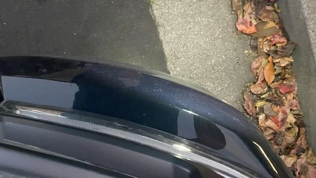

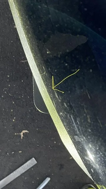

After "sleeping on it"....
The bracket is a little proud because the bracket is square: parallel to the license plate, as any designer would make it. Make sense.
But the bumper is curved.
Maybe instead of shaving the corner I can just put a washer or two under one of the bracket bolts to make the bracket not parallel. 🤔
Ford Maverick Fog lights for Maverick ? 62123E60-7F36-460B-A3A7-F3629B39B698
P.S. they also make wedge shaped washers.
Edit: P.S.
Three flat washers under ONE bolt on the passenger side makes the braket angle flush with the plastic bumper. I will go back and do the same on Driver's side. Slow progress. No time last week. Always dark when not working!
Passenger bracket not visible with "slanted" install.
Ford Maverick Fog lights for Maverick ? 78F1AF93-37DC-41F4-AD02-EB2C31F4D747
Ford Maverick Fog lights for Maverick ? 28D80E22-FA2F-486E-8B3E-EFBDE2DD374E

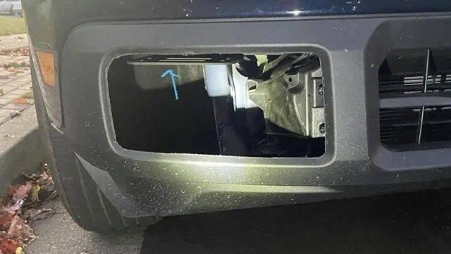

No surprises when cutting out passenger side. Also there is a wire bundle just above the cut-out to be aware of. Arrow: newly installed bracket with 3 washers under one bolt to make it flush with front edge.
