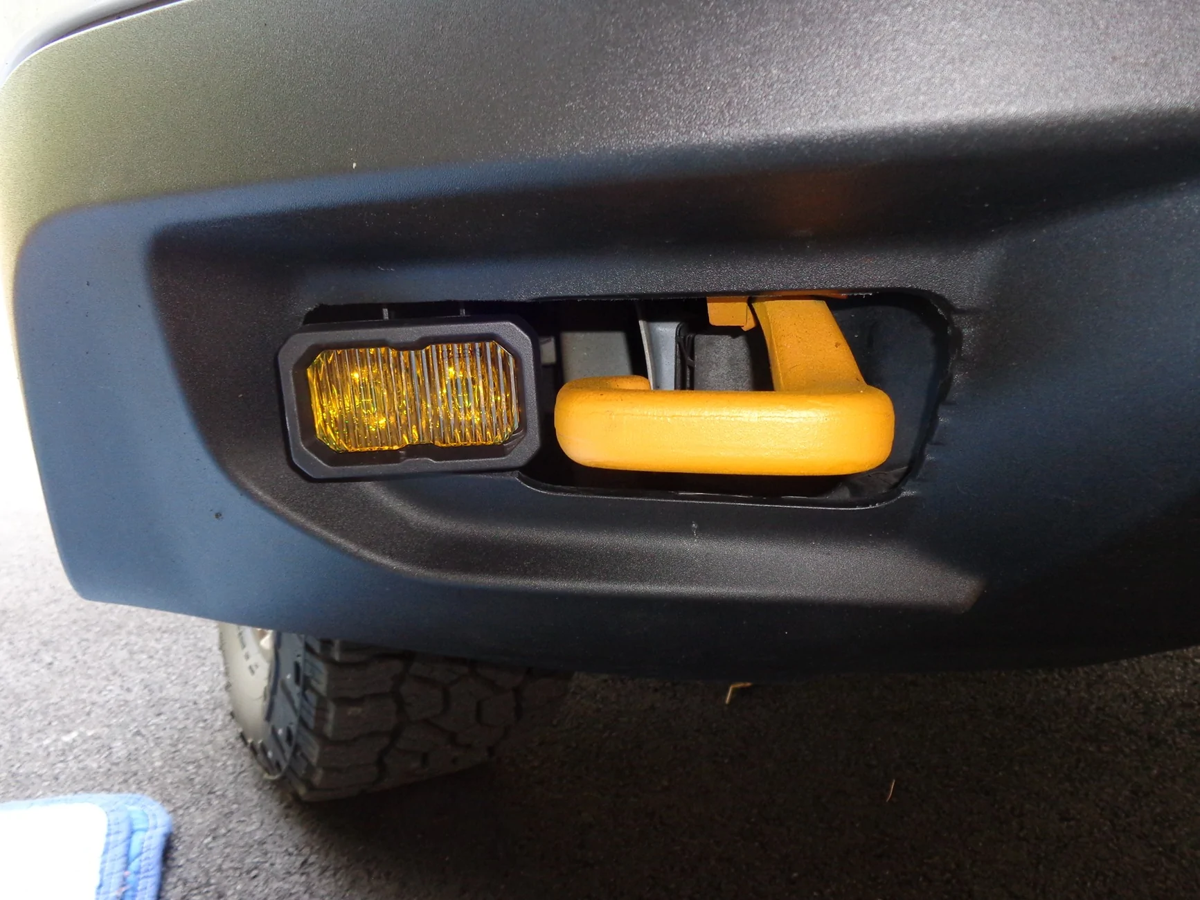

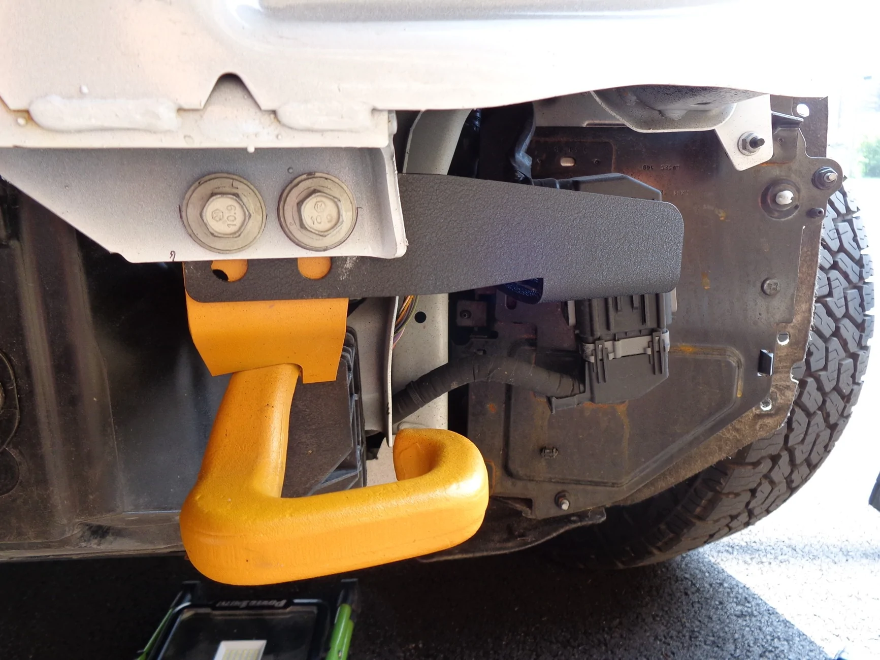

I have the 2024 Maverick XLT Tremor. Has anyone found a way to install fog lights and leave the tow hooks in place?

The real trick is going to be the brackets. I got one of the last sets of the JJC Tremor bracket sets. I'd reach out to Justin and see if you can get on a list; I heard a rumor that he might do another run if he gets enough interest. I used his brackets and a set of Diode Dynamics' SSC2 fog lamps. Then it's just the matter of trimming the lower valance to get the proper fitment. There is quite a bit of adjustment built into the JJC brackets, then it's just trimming a bit at a time until they fit how you like. Tow hooks fully-functional.
Ford Maverick Fog lights DSC00746
Ford Maverick Fog lights DSC00740
