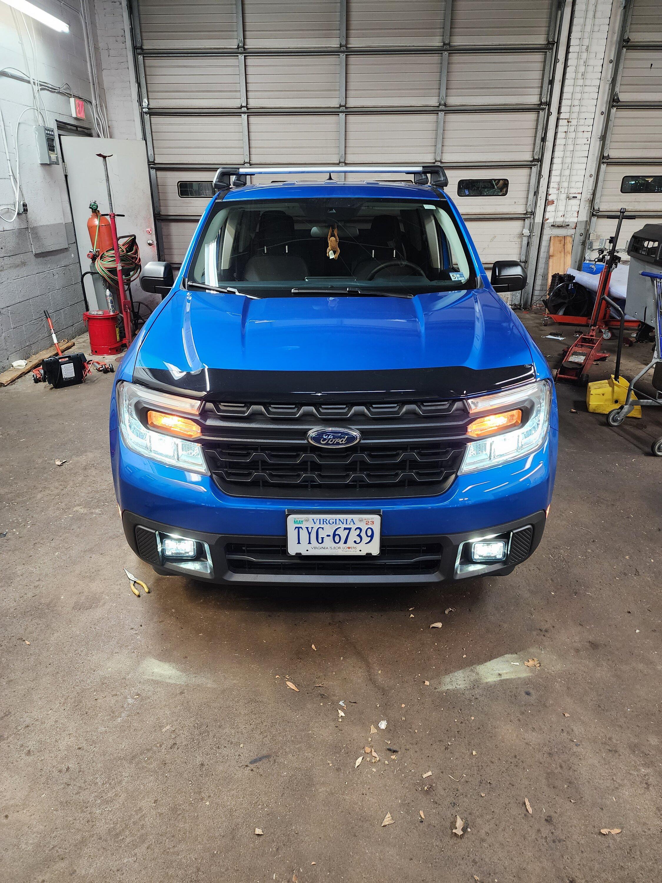

I’m forced to have a front license plate, fog light mounts off of those are commonlace and will work for me without giving up the tow hooks of restricting the inter cooler.

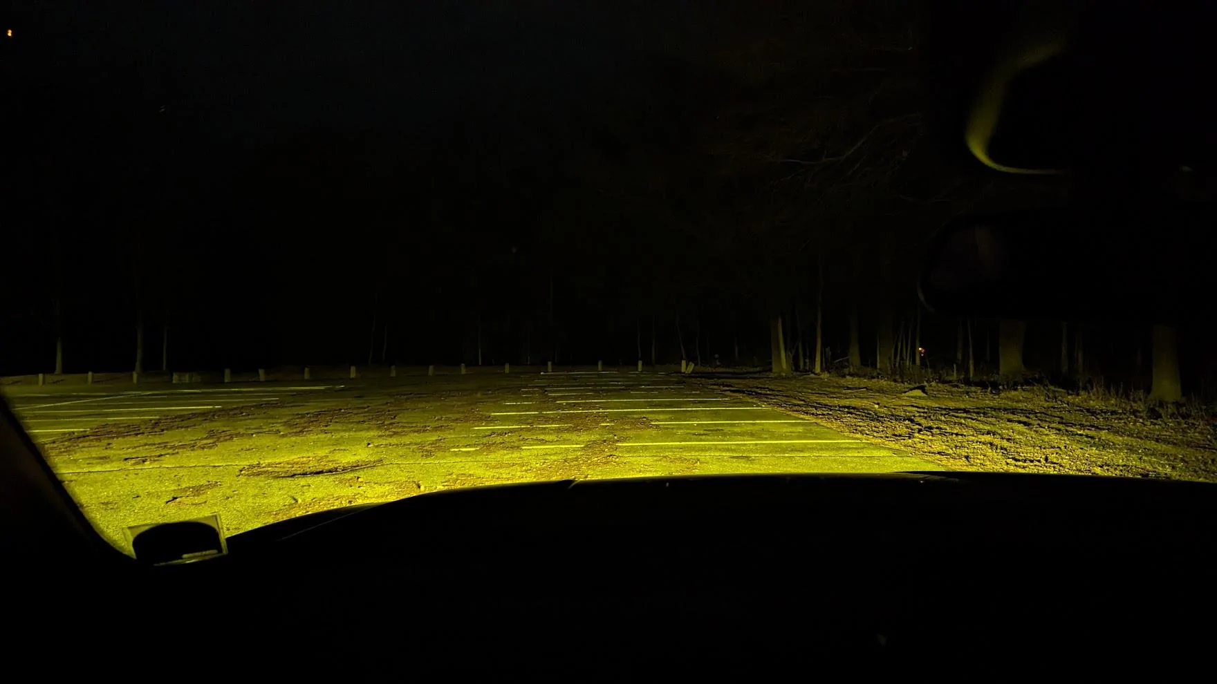

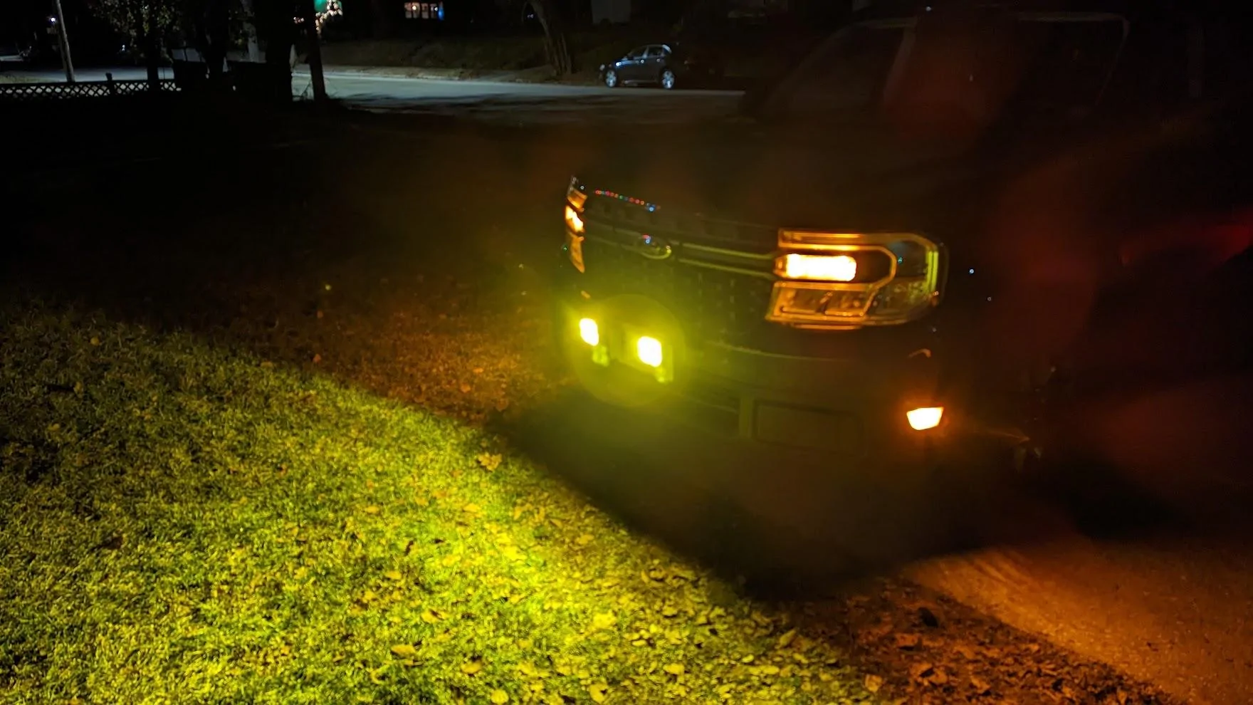

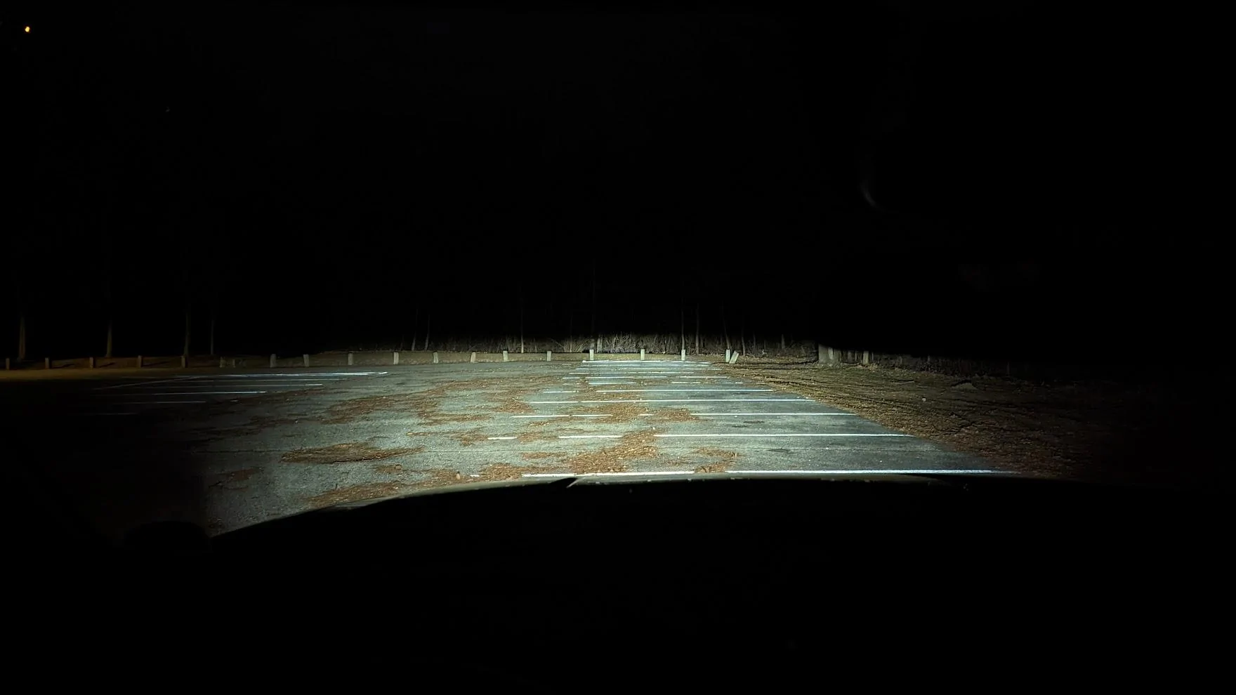

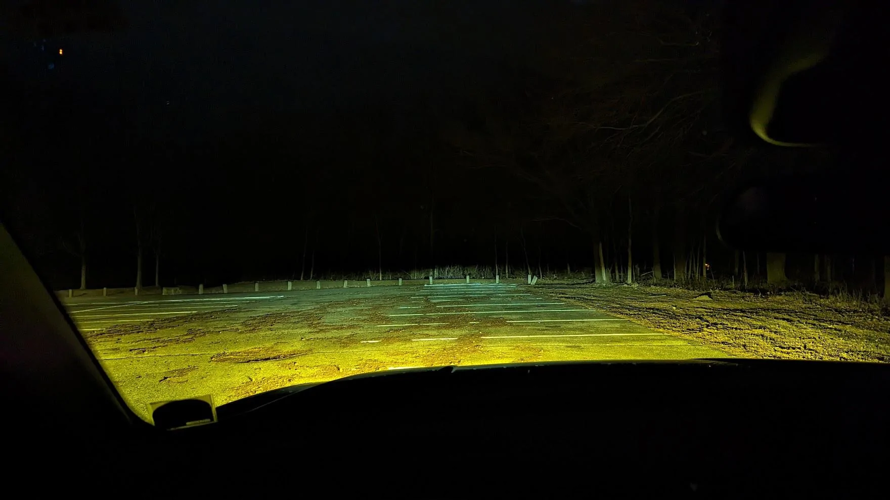

well i did a thing after I got home from work this evening.
bracket: https://www.amazon.com/dp/B075CHHWXY?psc=1&ref=ppx_yo2ov_dt_b_product_details
I have another bracket to try on the way: https://www.amazon.com/dp/B09ZDDXQ1B?psc=1&ref=ppx_yo2ov_dt_b_product_details This one will allow me to mount the lights a tiny bit lower & wider - which is obviously better for a fog light application
I may also end up modifying the plastic license plate holder so I can mount the first bracket upside down, which will allow the lights to be mounted at the same height as the intercooler opening. Wasn't going to mess with that tonight as I did this all in the dark and its 25°F
Lights: Diode Dynamics SS3 Pro in SAE Fog beam pattern - https://www.diodedynamics.com/stage-series-3-sae-yellow-pro-led-pod-pair.html
Headlight only
Fogs only
Both
I walked out to the tree line that can be seen in the photos and I was pleasantly surprised that there was not any distracting / blinding glare. Even ducking down so my face was in the beam pattern of the headlights - the glare from headlights was worse than the fogs. I still may end up aiming these down a smidge. As is though, these do a great job of filling in the blank spots to the left & right of the stock headlight beam pattern
Headlight only
Fogs only
Both

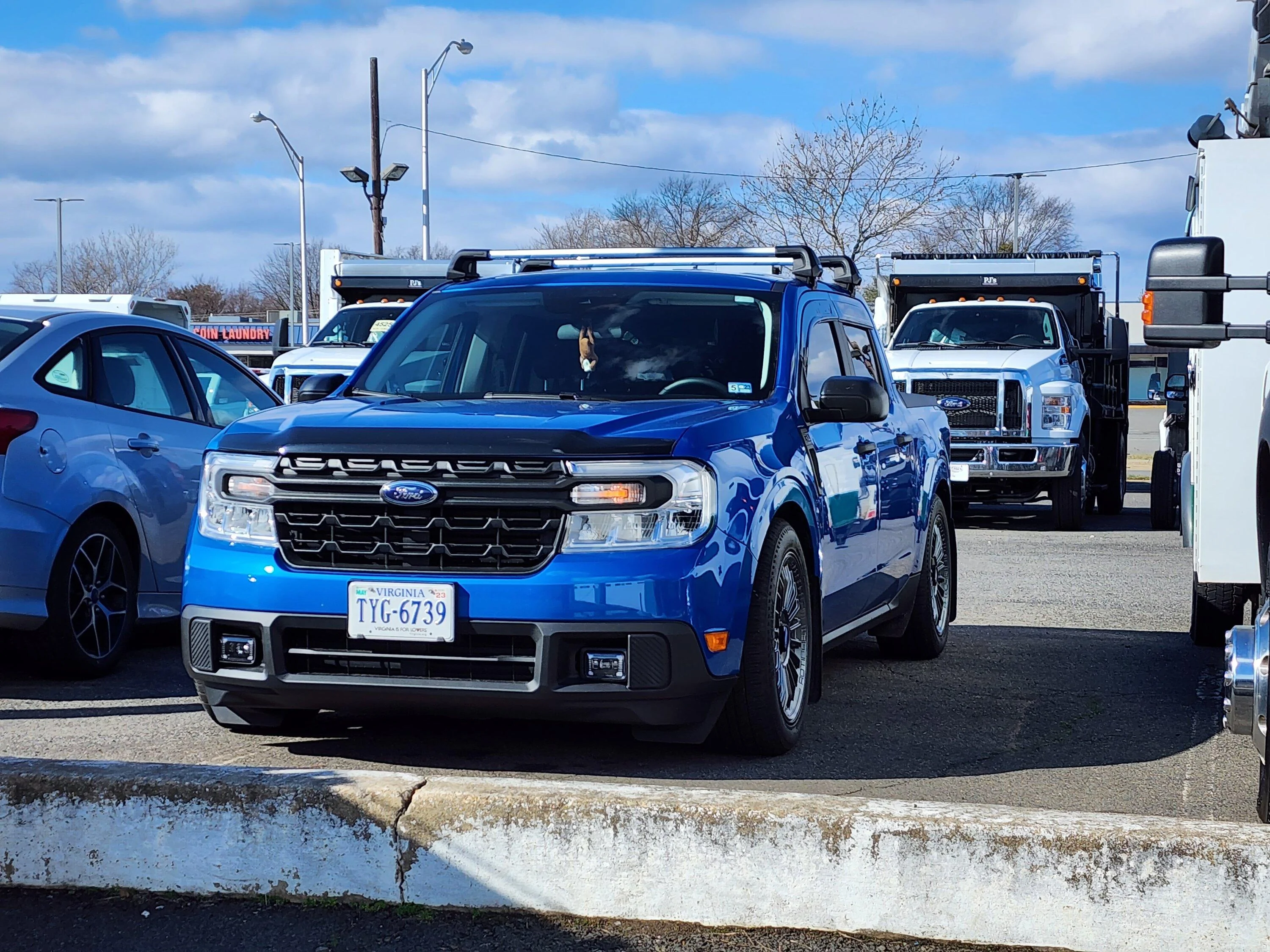

Heres my XL with front FX4 bumper and f150 aftermarket fog lamps
Have any up close photos? Ive been thinking of doing something similar with the f150 fogs
