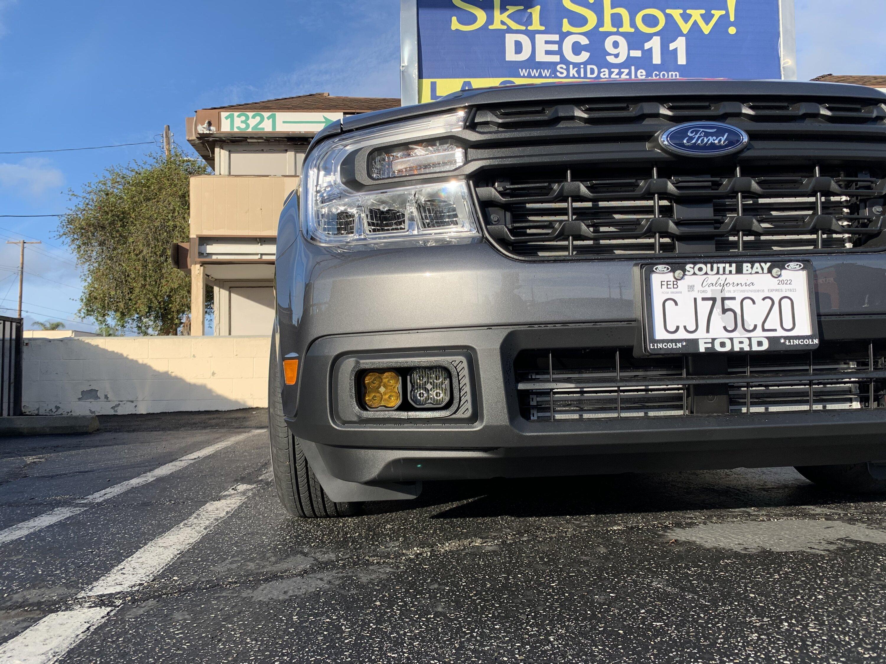

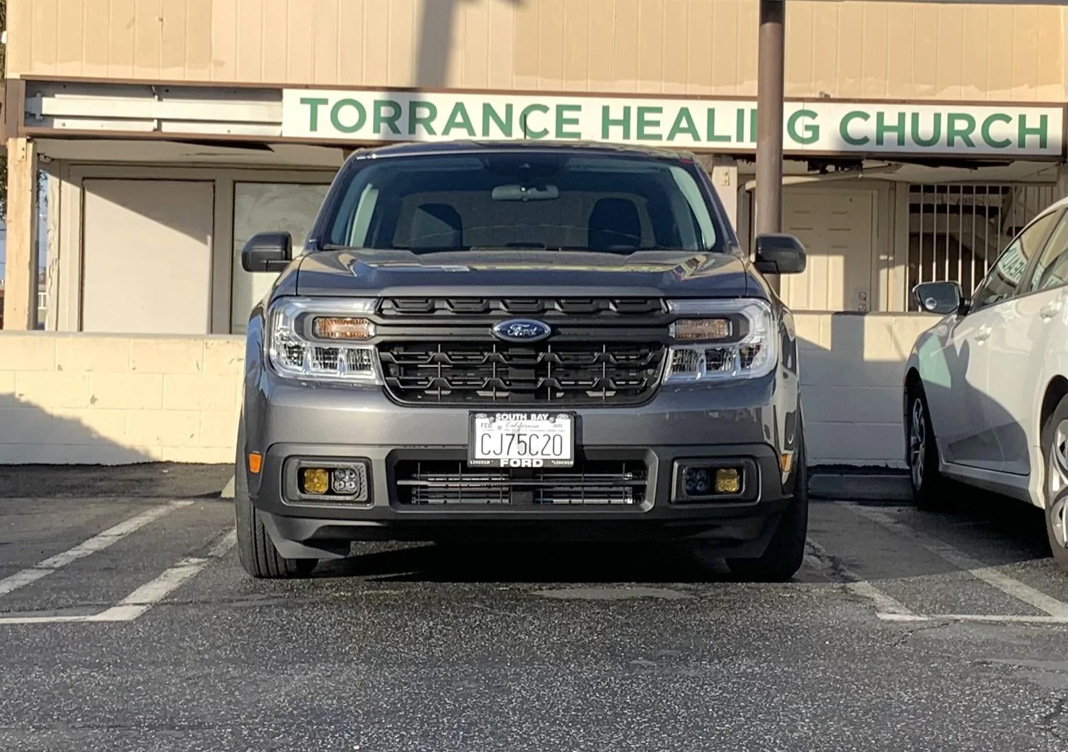

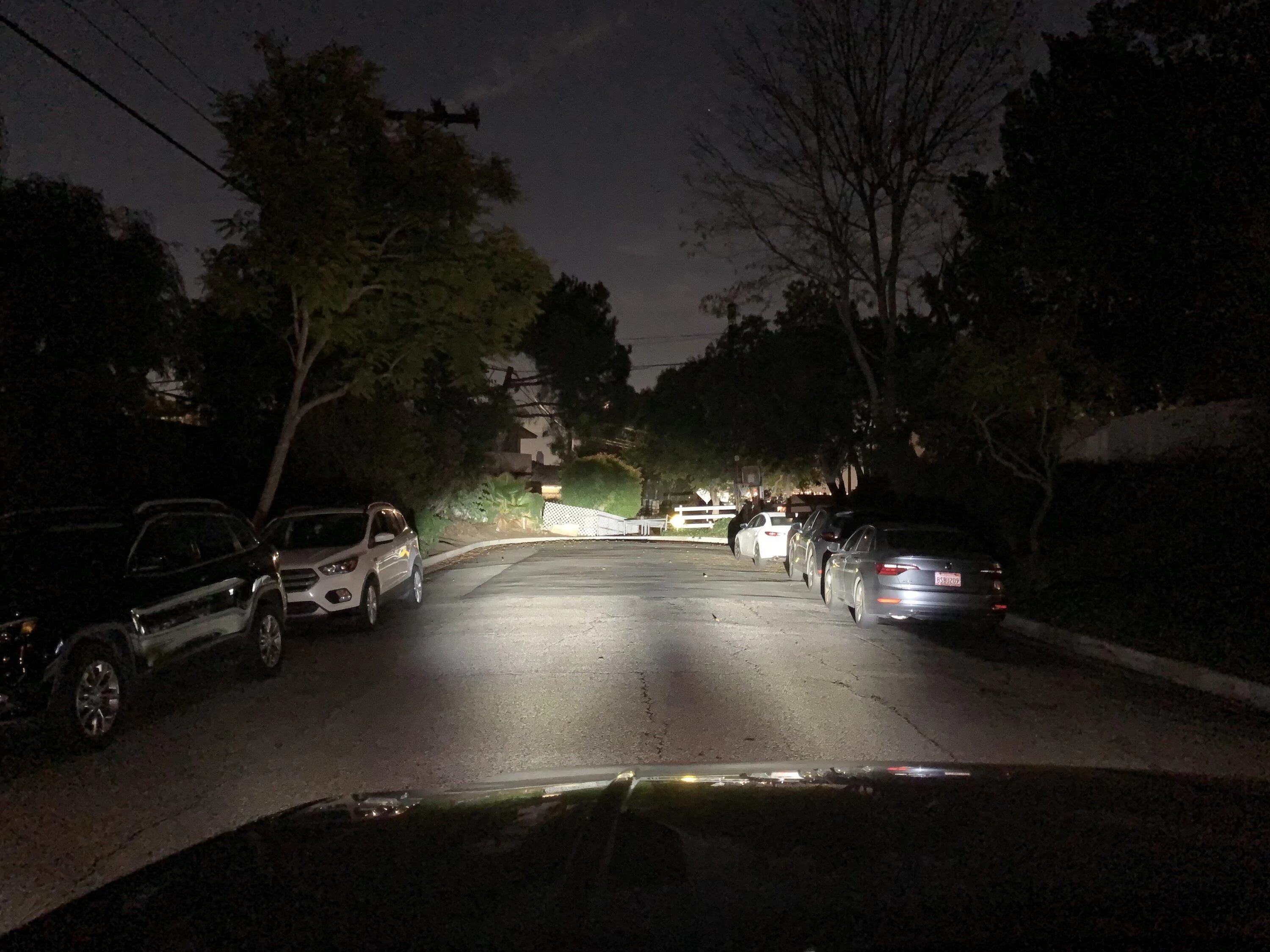

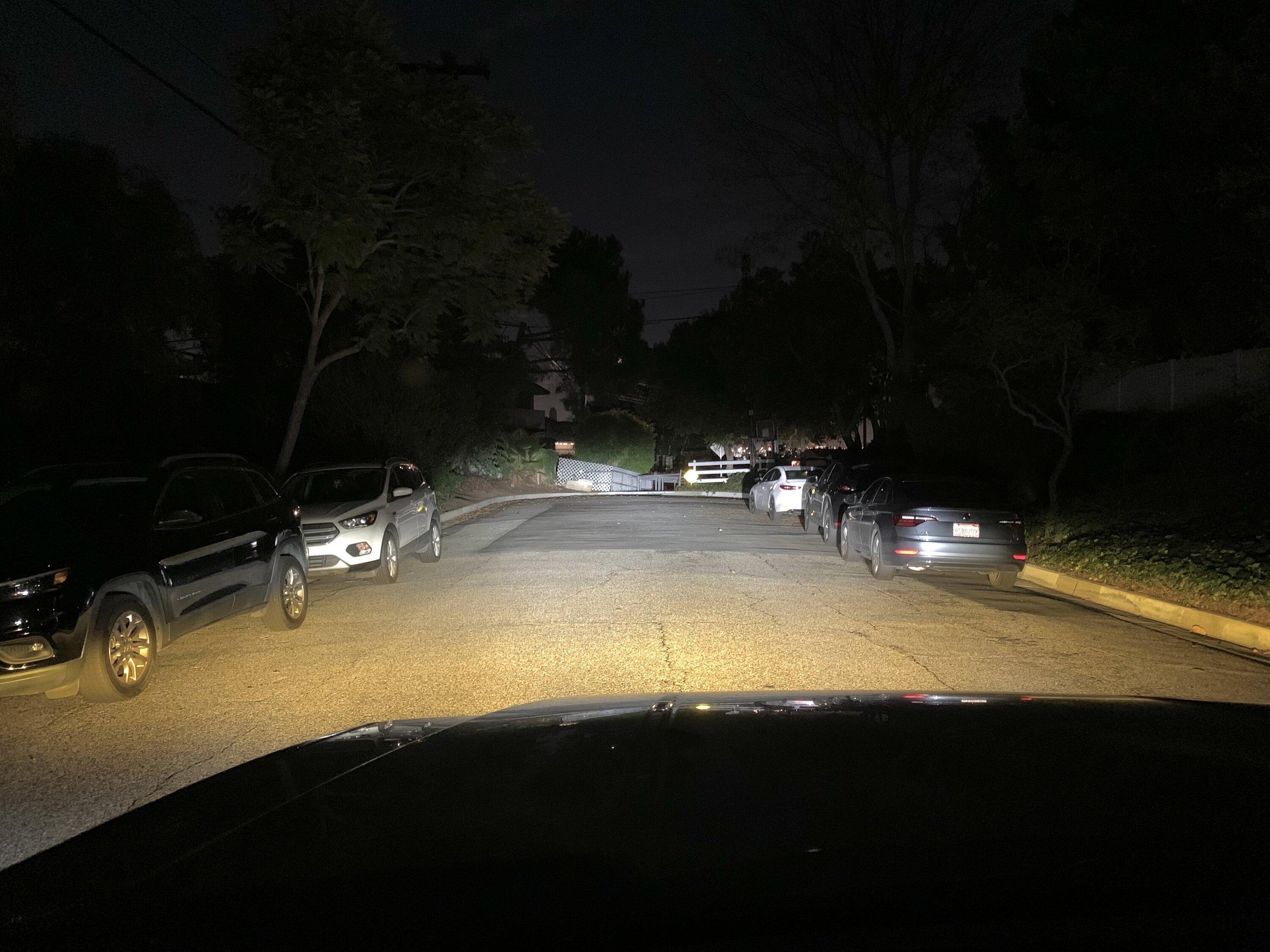

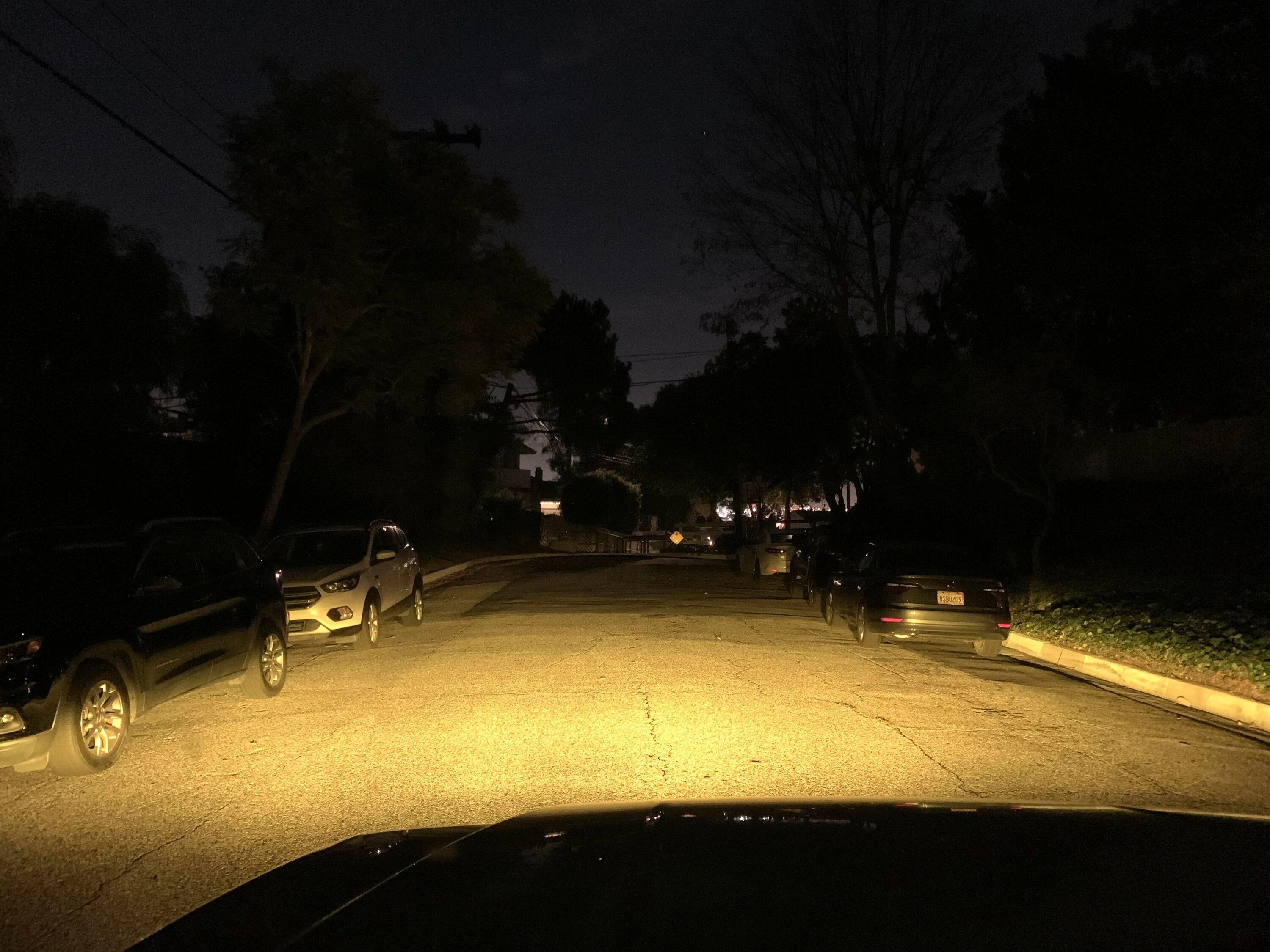

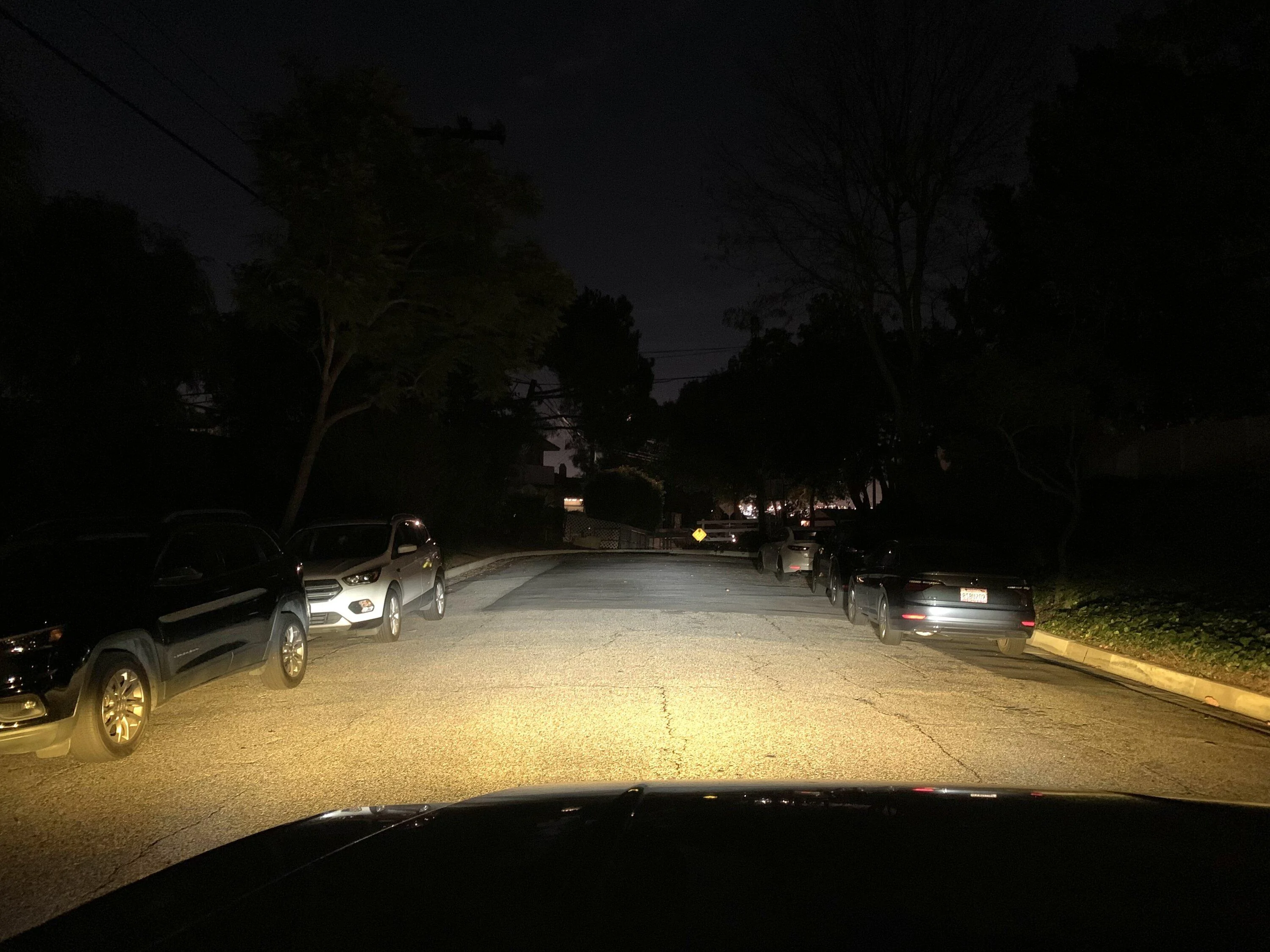

Got mine installed this weekend! Diode dynamics ss3 sport fog and driving lights using jjc mounts.
Ford Maverick Fog lights for Maverick ? 65B0EAF2-EE06-4209-BE36-9AFEF9E8426B
Ford Maverick Fog lights for Maverick ? 823CFD78-2132-48C0-A6F4-81A34E209015
Ford Maverick Fog lights for Maverick ? 1CF72BA3-4BB7-45EB-A852-FEB1E4F9126B
Fogs only
Ford Maverick Fog lights for Maverick ? 841DB2F3-D8BE-490A-BB1E-C815CC4AFAD3
Fogs and headlights
Ford Maverick Fog lights for Maverick ? EC711C93-A9C6-4F6F-9AF0-86530F1CBDA9
Fogs, driving lights, and high beams
Ford Maverick Fog lights for Maverick ? 38993EE9-FBC1-4FD0-B94D-214AF734544E
Driving lights only

Nice install. Did you take the bumper off?
Where did you put the switch(es)?
Dodeboost
Nov 25, 2022
224
321
Southern California
2022 Maverick XL ecoboost AWD
I understand the terms.
But shouldn't headlamps be driving lights?
haha you have a point. Thanks. Did not take the bumper off. I removed the fender liners which gives you access to the back of where the lights are mounted. However on the drivers side there’s a computer in the way so I had to work through the cutout to mount them. Probably would have been easier if I cut the whole window out but I prefer the look of the smaller area cut out. Haven’t decided on the switches yet, still hanging under the steering column

I know you put a lot of effort and thought into getting this done! Looks great!

Thanks guys! I don’t love the rubber molding so I may look for something else but I’m happy with it for now.
You're welcome. If we hadn't been following along, I would have guessed from your last picts that the Torrance Healing Church was also in the business of installing accessories. LOL.
