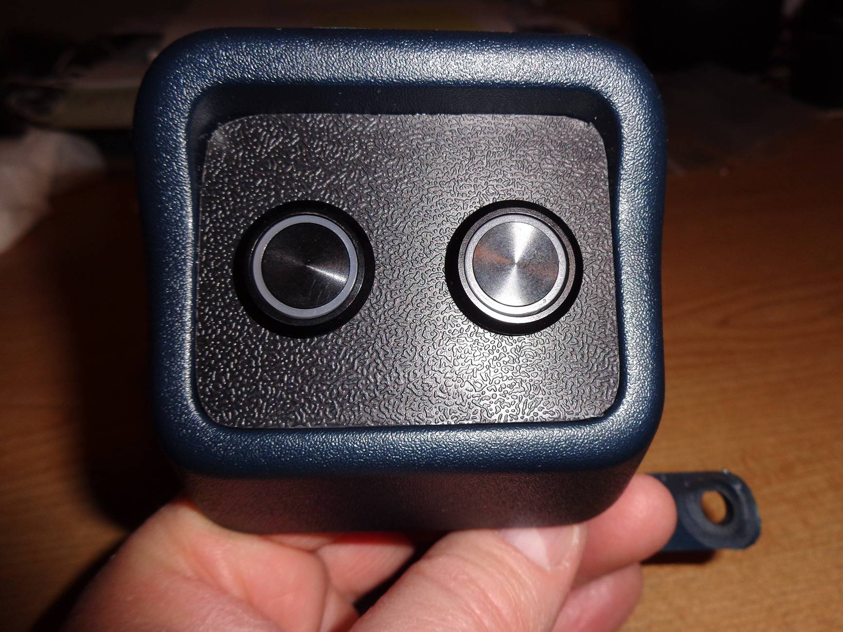

As mentioned above, the F150 switch is the most OEM and elegant solution.
Another option is to get the trailer brake control lower dash panel, cut an insert out of textured plastic, and install a couple of Apielle lighted pushbuttons from Amazon. These will work great for your Hellas. I have this setup for my Diode Dynamic ditch lights and grille lights; I'm saving the already-installed F150 switch for when I can get a fog light setup to work with my Tremor lower valence.
This looks neat I was thinking of doing something like this, i knew about the panel, so do you also but the trailer control and take those plus and minus switches out, would mind helping me out sir?

You'll get the whole lower dash panel with this piece. The actual brake controller switches are not included. You'll need to make an insert and epoxy it into this piece to hold your switch(es). Part number is listed earlier in this thread.
