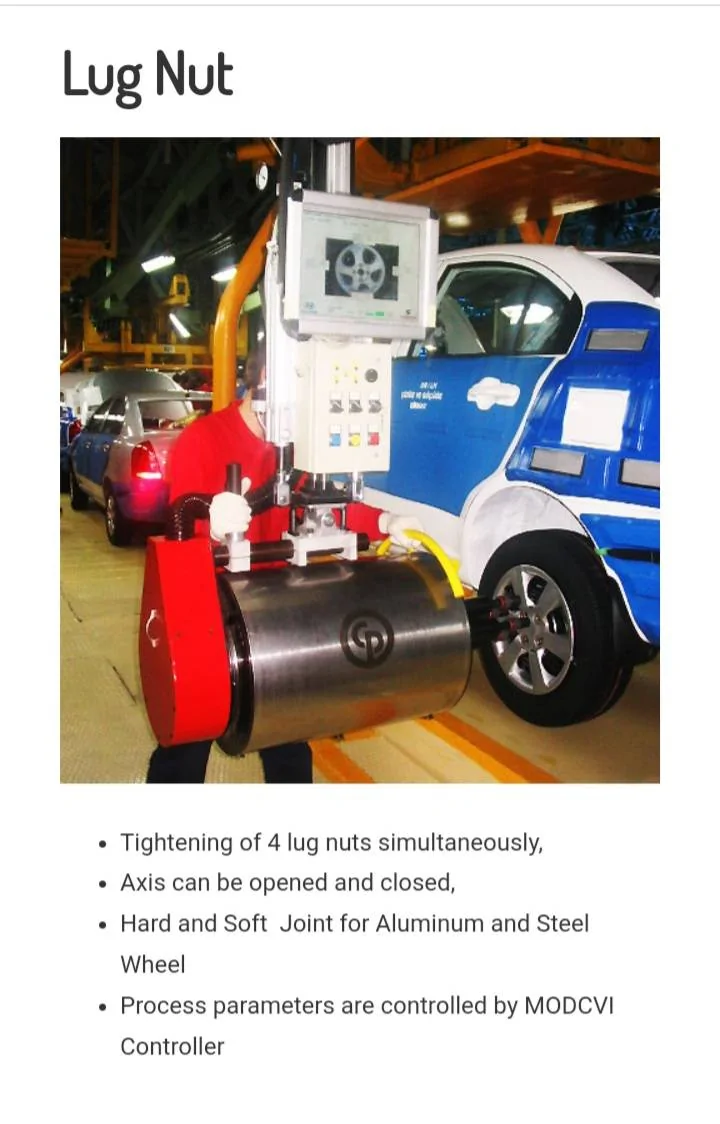

just a fyi, they don't use air tools on critical fasteners in auto assembly and haven't for decades, even in Mexico. lug nuts only one of many many critical fasteners.
computer controlled electric tools are the standard. no noise, no air tool oil in the air and every aspect of the fastening process is digitally recorded, assigned to the vin and must pass specifications before your Maverick can leave the factory.
hell even the air pressure in each tire, amount of fluids/oils are all recorded and tagged to a vin.
it's largely CYA and Ford has a rather large ass.

Made by Chicago Pneumatic. Interesting.
