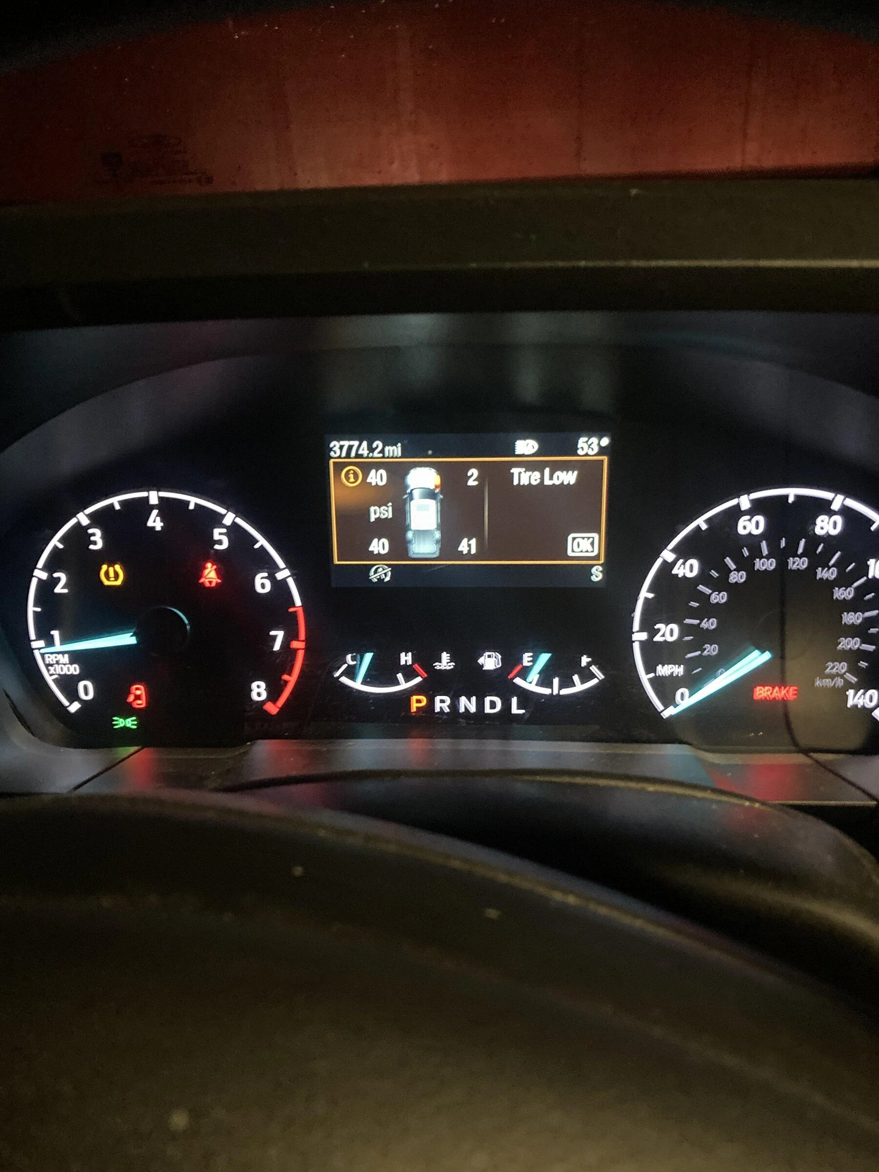

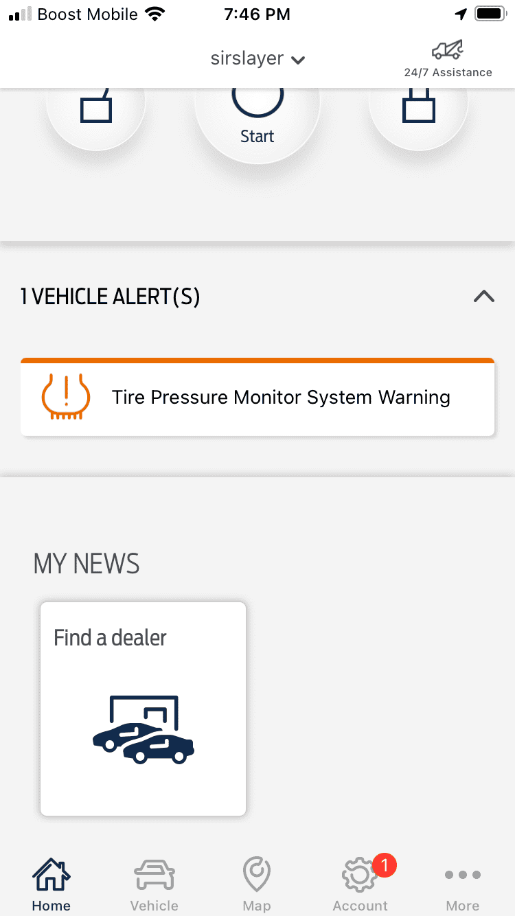

Well, I jumped into my 2022 Ford Maverick XL trim and turned on the engine and got greeted with an alert Low tire pressure . So I jumped out and checked my front passenger tire and yes, I do have a flat tire! I’m impressed that the tire pressure system works and if I wonder how does this technology works? I’m going to use the spare tire but it’s night time and it’s raining. So I’ll do this tomorrow morning. I’m just curious how the tire system will recognized the full size spare tire !! .

I don’t believe the spare has a TPMS. TPMS sends a wireless signal to your car telling it the tire pressure. The car turns on the light if the tire is out of tolerance. After you change your tire the light will probably stay on until you get the tire repaired/replaced. It’s entirely possible the car is smarter than I think. Let us know!
