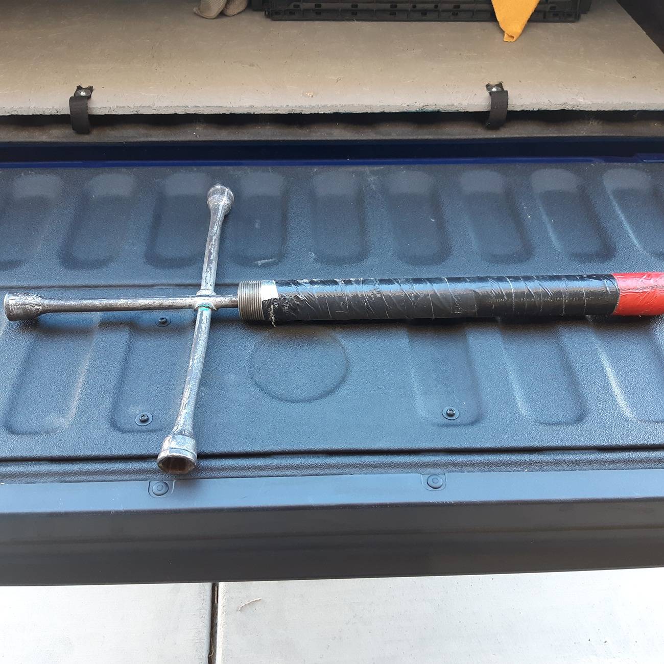

Just sharing a flat tire experience.
I've done this before, picked up a staple causing a leak in a rear tire. First time to remove a tire on the Maverick so pulled out the "Toy" tire tools from the back seat. "Are you kidding me". But what's included is pretty typical in all new vehicles.
I've changed many tires so I had already added the "4 way lug wrench" tire tool that will fit pretty much any nut. The 4 way tire tool gives a lot of leverage over the "toy tire tool" wrench under the rear seat. But to my surprise there was no way the 4-way tire tool would come close to turning a lug nut....not a one of them. So went to my backup plan and that is a "chain link fence post" I had added to my tire tool box years ago for leverage. Even adding the 4 foot long fence post for leverage it took brute strength to finally break loose the first lug loose.
Just a suggestion, you might want to try this exercise on removing just one lug nut before heading out on a long trip, or trip to the grocery store. The "toy set of tire tools" and 4-way Tire Tool would have left me stranded on the side of a road.
No doubt, the lug nuts from the factory were put on by air wrench and probably applied with way more power than those put on by hand. Since I had my handy "chain link fence post out" I continued to loosen each of my lug nuts on all four wheels and retightened them to human strength, so I don't have to haul around a fence post in my back seat. Every single lug nut took brute "fence post" strength to break loose.

I went ahead and I checked my lugs they were pretty tight. It also reminded me to put my four-way lug wrench and well used homemade breaker bar in my truck.
