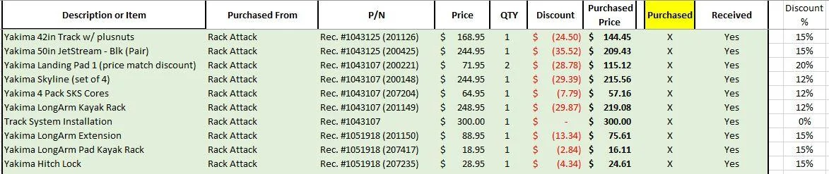

I assume you are referring to the Track or Rails and NOT the assorted Roof Rack items / options. So, what I paid (not including military discount):
1. Yakima 42" Yakima Track w/ plusnuts (201126) = $168.95
2. Track System Installation = $300.00
BYW, installation meant putting everything together (out of the boxes), aligned and leveled on the truck (Landing Pads, Skyline, JetStream, SKS Cores, & LongArm). Complete and ready to drive off.
I would add that as confident as I am in my DIY'ing abilities I didn't have a problem paying to have this professionally installed. I say this primarily b/c I have ZERO experience in this type of critical install.
I just got a quote to do this job from RackAttack in Canada. I was kind of sticker shocked when I saw the quote. I don't have for the price you paid to have this job done, even if it was a 100 more. I'll have to get back with them have them explain each line item.
More to come on this from me and I don't really need this done until spring.

Hi Bear, my Rack Attack shop has a price match policy &/or a military discount... check with yours. Since you have the time check with others in your area and get quotes; especially now during sales time. The only problem is you might have to purchase earlier than you want to get best price. I've provided what I paid as reference / comparison, but understandably economic inflation and supply chain issues have impacted the price of everything. Also understand that Yakima has had inventory problems for some time now. Keep updating, would luv to know how this works out for you!
