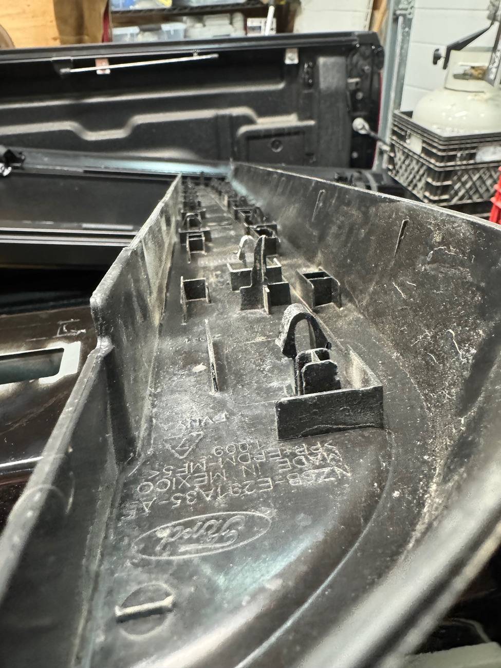

I should have mention that I do have a tonneau and want to keep,also I have a Rhino Rack that I will try and put on but it will be a challenge.This is an image of the under side rail plastic that will need some spacers and rivet nuts to hold it on because of the tonneau cover,lol

Are trying to mount the rack onto the plastic bed rail, or am I misunderstanding you?

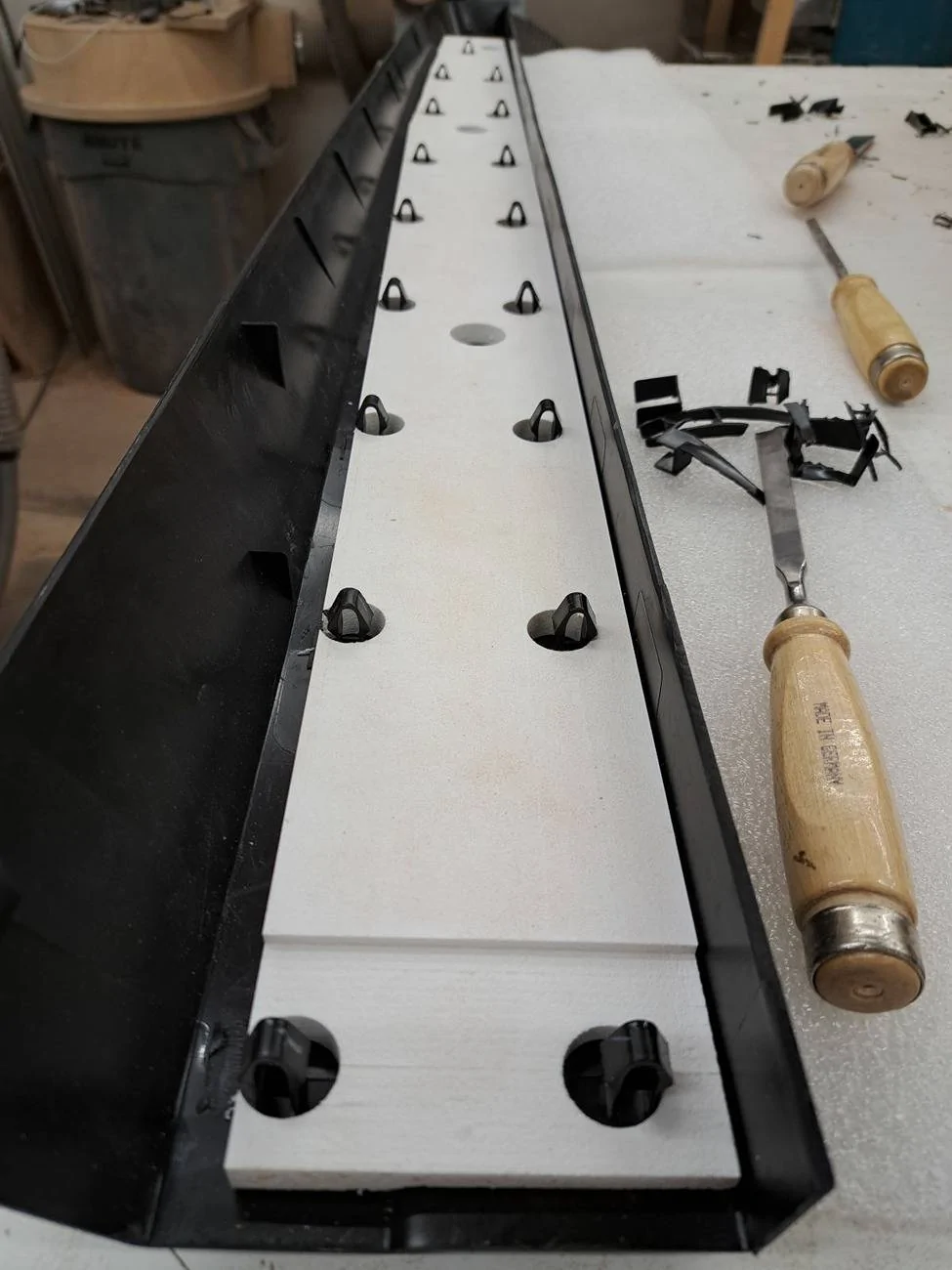

What I did with the plastic trim piece was to remove all of those plastic tabs from the underside and fill the cavity with some PVC trim from the home center. But I have the woodworking tools to thickness and shape the PVC so that won't work for everyone. But lots of people have just put T track on top of the plastic trim and not had any issues. The way the rack I used mounts it squished those tabs long before I got to the right torque.

No,through the plastic cap and into the metal truck rail with Rivet Nuts because of the tonneau cover I have no access to bolt it down so will be using Rivet Nuts,hopefully lol.
