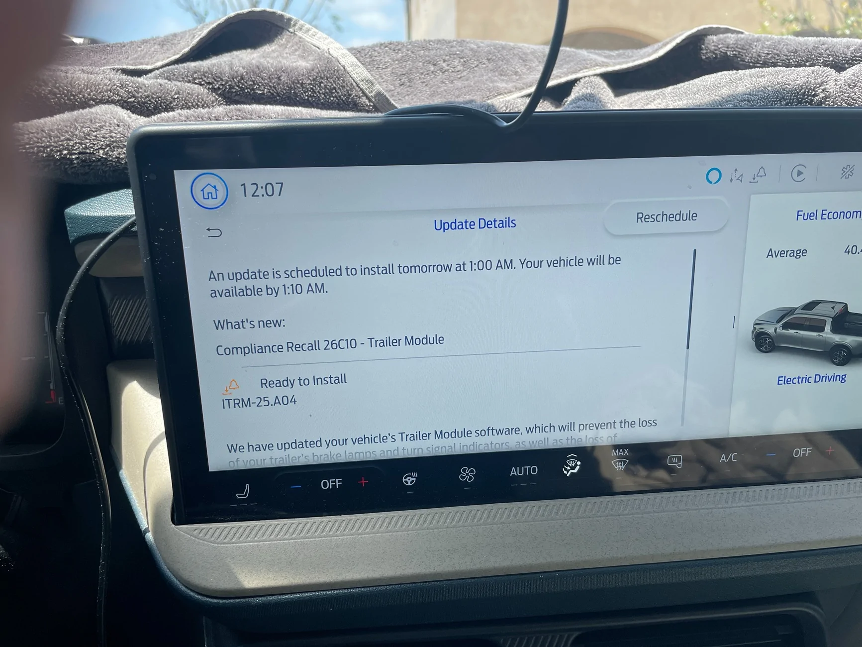

i turned my car on this morning and got notification that this Trailer recall would be updated OTA at 1 am this morning and my car would be unavailable for 10 minutes. it was giving me the option to reschedule if i wanted too. i will follow up if its done.
edit. just out of curiosity, i went down to my Maverick to see if the notification would show up again, and sure enough it did. i attached a pic. since i dont have a trailer...this is 1 recall that could wait.

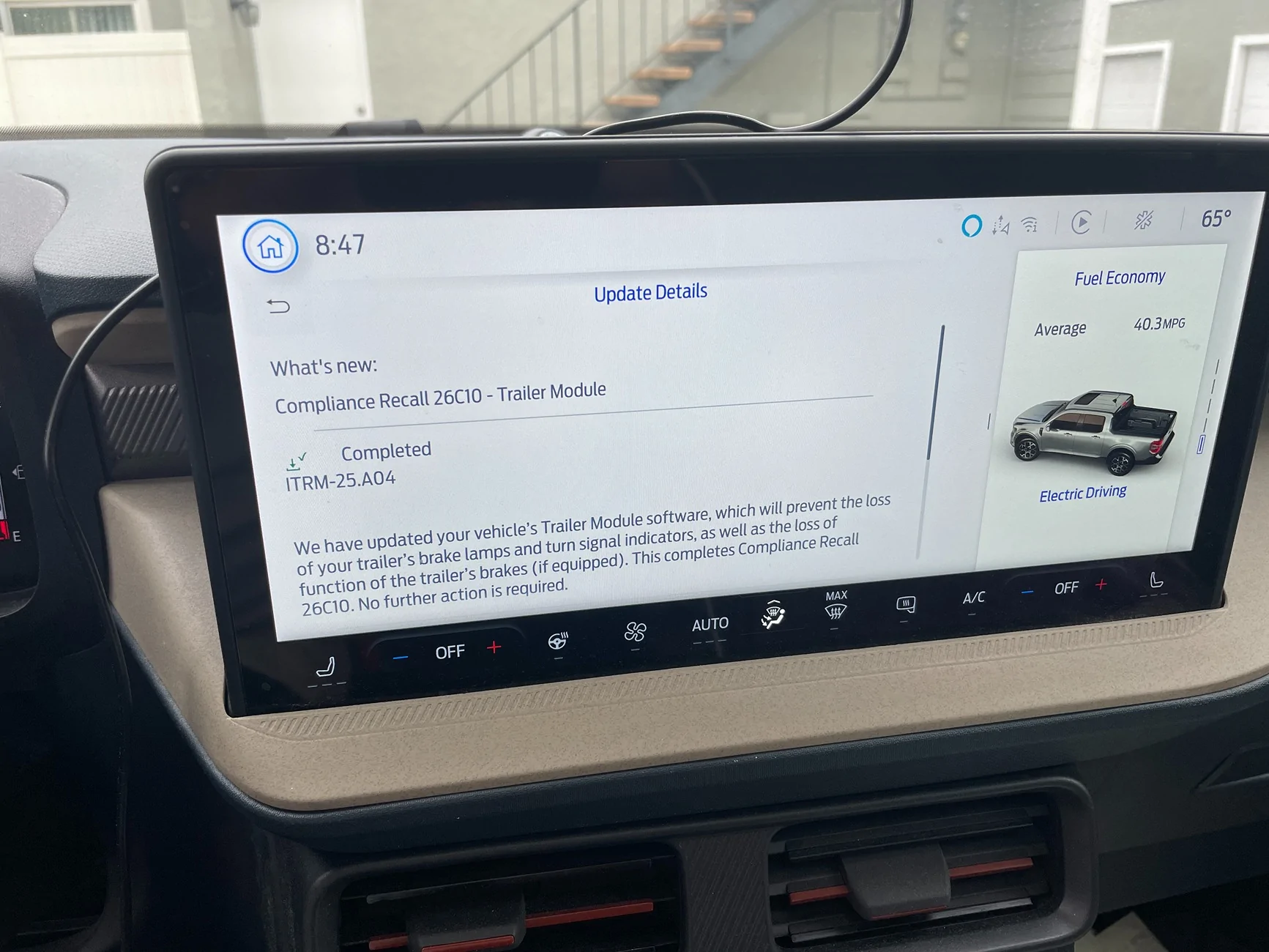

good news...heres the followup. recall updated without a hitch. my MyView settings were reset. i havent checked to see if all my manually adjusted options were reset. my Am?FM Radio presets were still how i set them. my wireless Apple Carplay worked normal. here is todays pic
Ford Maverick First Recall - Trailer Module- Anyone Else? IMG_0095
