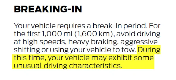

What constitutes “high speed?” I’m assuming driving around 75-80 should be fine, right?
I made a break in thread and no one has said what they consider “high speed”. I need to drive it home on a 75MPH highway so hopefully that is fine. I would avoid cruise control (change your speed a bit), and go easy on the RPMs.
Others have said “drive it like you stole it”. If I stole a car I would drive it cautiously to not get pulled over. That probably isn’t what they meant.
My1stTruck
Sep 23, 2021
Louisiana
2022 Maverick FX4 AWD
Hopefully, it is just this.....
I seriously doubt it. Computers and electronics don't require a "break-in" period. After all... They literally run on "Ones and Zeros". They are either on or off. This break-in period, which I'm following b.t.w. is for the engine and transmission and other mechanical components.

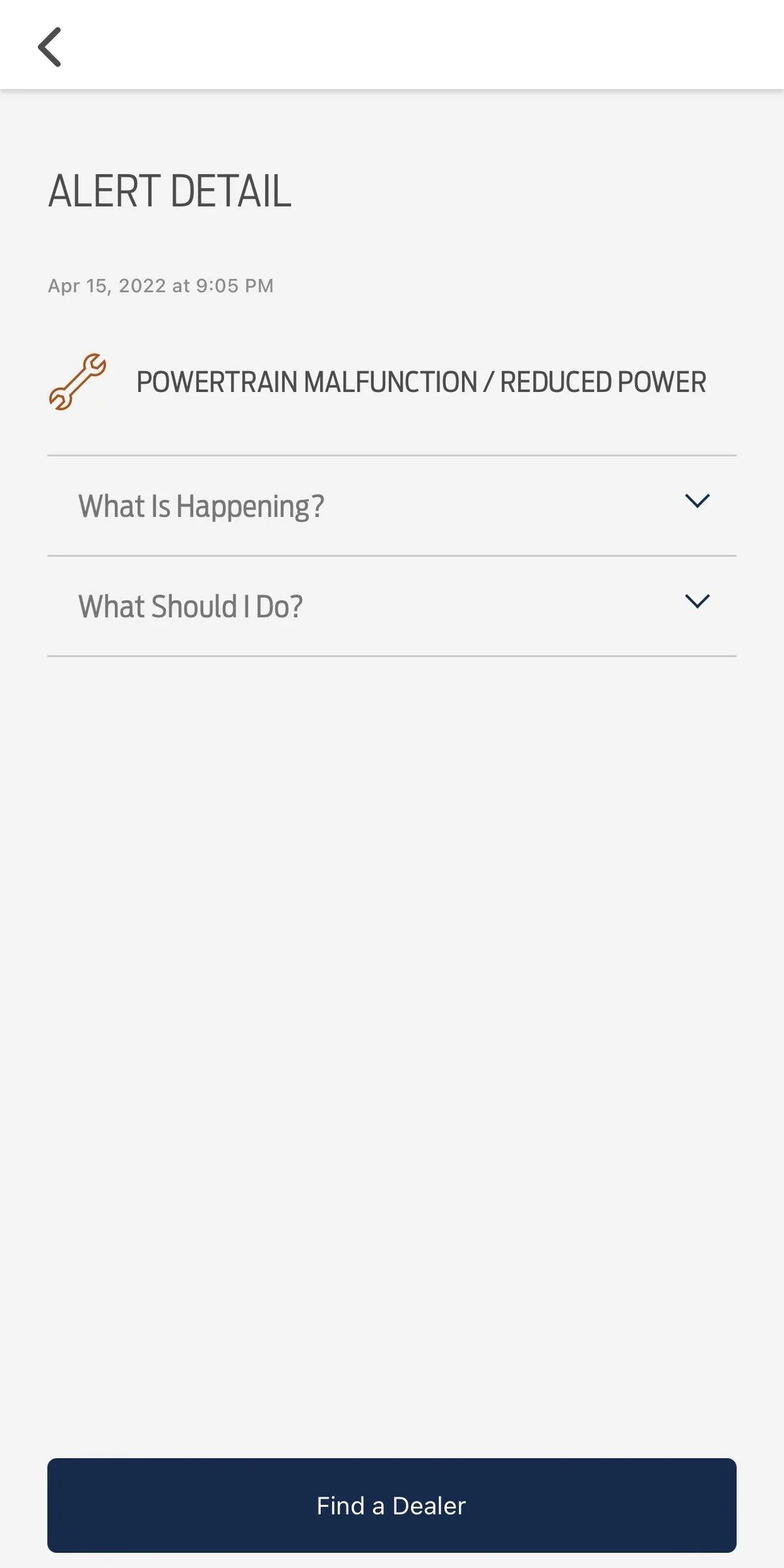

Chiming in to say I just got this same error code on my Hybrid. 1 month old 1400 miles. Garage kept and used for commuting on paved roads.
Wrench popped up on the dash when I turned it on this afternoon. I had already driven it in the morning with no issues.

I wanted to ask if you had the same problem again or if you took it in and they found the problem. A couple weeks ago the dash went all crazy and then one day the car just wouldn't start. Left it sitting for a week and only then did it turn on. I has now been at the dealership for a week and they have not found anything.
