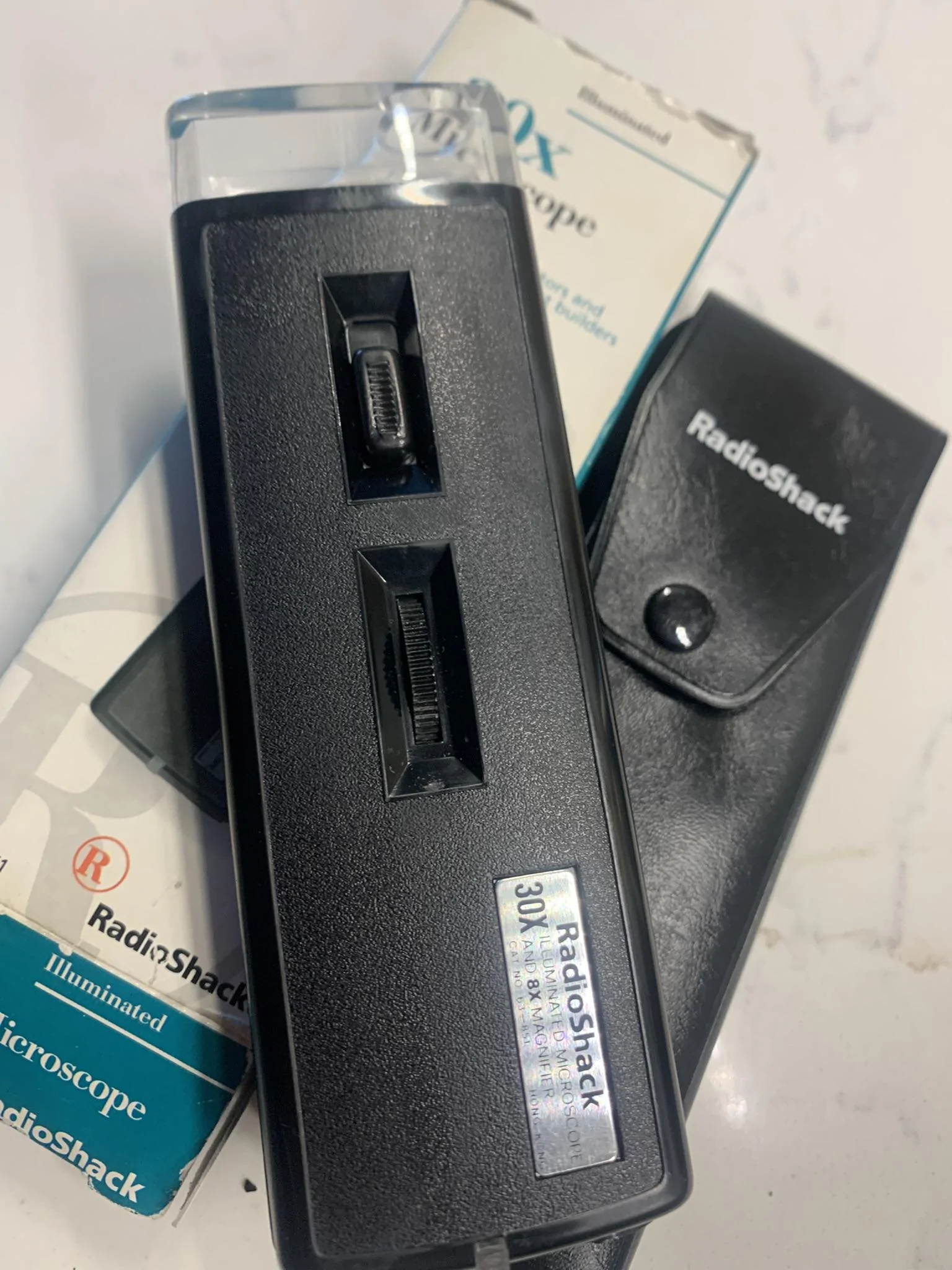

@Akmaverick : I was a former District Service Rep for different auto manufacturers. The pics of the following tool are what I used to view client complaints about paint chips and scratches. I used a 30Xs Microscope (Radio Shack).
What I looked for was which direction the paint chip/scratch edge was pointing. IF it was pointed UP or outward, then it was considered a paint defect. IF it was pointed DOWN or inward, it was considered caused by external event, like a rock or something abrasive.
(This is my way, but it is not the ONLY way. Body shops use other methods.)
You can request to meet with the District Service Manager to inspect the paint to determine if the cause is defective paint through either Ford Motor Co Customer Service OR your servicing dealer.
I strongly suggest seeing if a friend or neighbor has a tool like this to view it before meeting the DSM. It will give you a leg-up if the paint chip is pointing up or outward.
Original kit bought years ago from Radio Shack

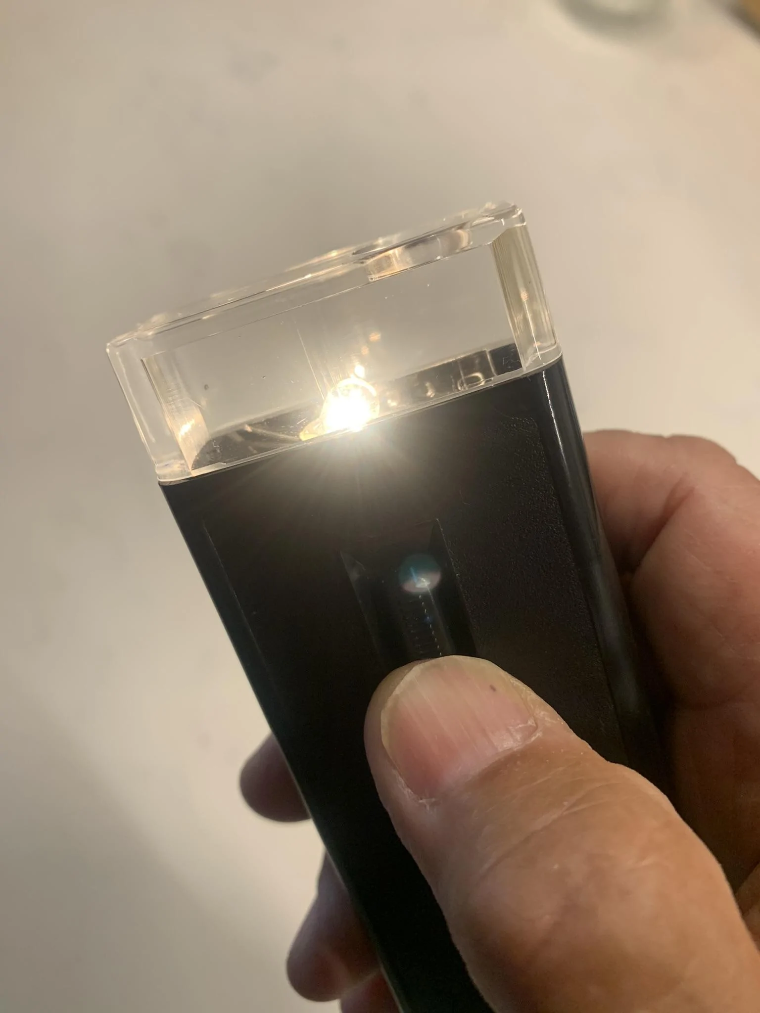

Ford Maverick Paint Problem MicroscopeKit
Flip the switch to turn the light on. Next to the switch is a dial to focus the microscope.
Ford Maverick Paint Problem MicroLightOn

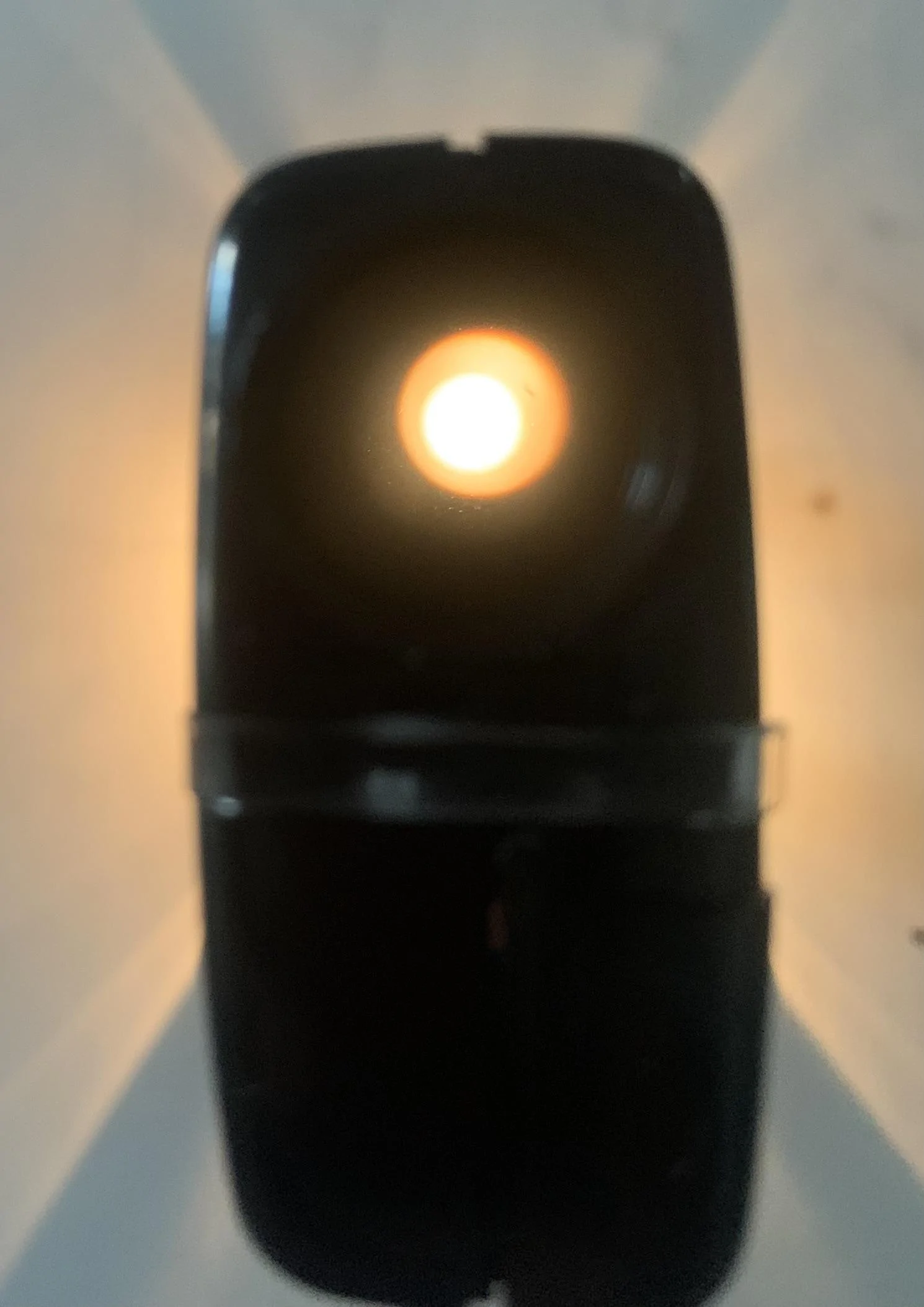

Looking through the eyepiece. Focus using the dial.
Ford Maverick Paint Problem MicroEyePc

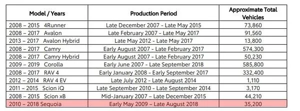

My sister-in-law is working with Toyota to get her Highlander repainted. Pearl white paint that is pealing off in sheets. Toyota told her the sun is doing this to the paint. Look at the list of cars and tell me that's not bad paint.
To: All Toyota Dealer Principals, General Managers, Service Managers, and Parts Managers
CUSTOMER SUPPORT PROGRAM ZKG LETTER ---- PLEASE READ
Phase 4 - Customer Renotification and Repair Phase Repair is Now Available
Multiple Models and Model Years Vehicles Painted with Blizzard Pearl (070) or Super White (040) Paint Color Coverage for Peeling of Factory-Applied Paint

General comment not directed at you. No offence. Just making a point that vehicles built at different factories, with different painters, on different vehicles, gets back to paint supplier.

Gotcha. Yes things like that do happen for sure. Your comments actually reenforce my thoughts that in the OP's post that the paint is at fault is wrong, I'll bet your sister-in-law's fascias, mirror housings etc are fine, (again different paints). If fact Toyota states in the attachment that it is the sheet metal paint. The OP has three separate substrates with odd looking scratches or whatever you want to call them.

Your correct about the sheet metal paint. Her roof and hood have lost most of the paint. All plastic and vertical surfaces look good.
