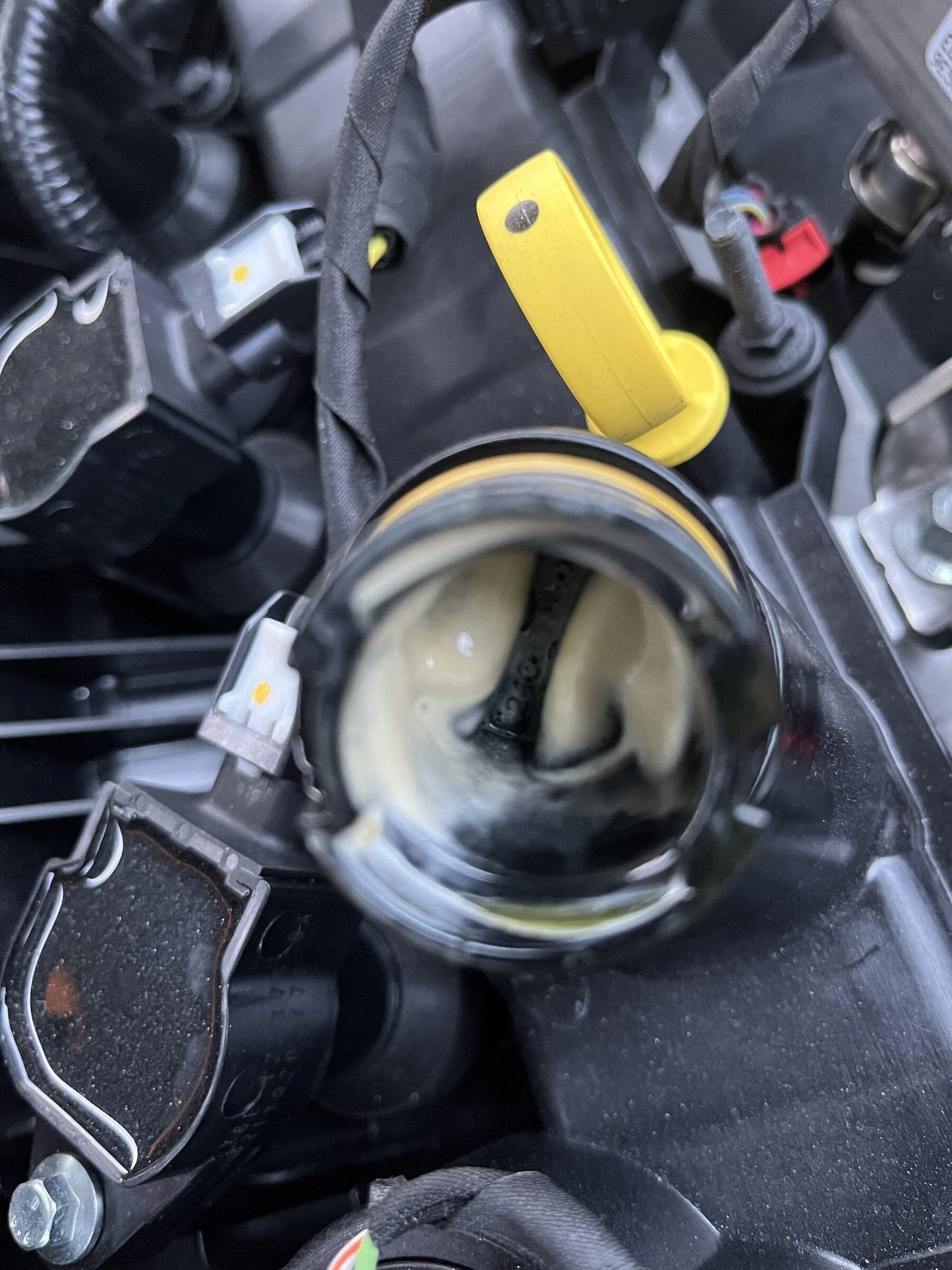

contaminated oil?
Coolant breach?
picture of inside oil cap
XL Hybrid
Sure looks like water or coolant in the oil. Seems like a LOT of condensation in your engine over 205 miles if that's what is causing the issue. Low(ish) coolant, over full oil, and a milkshake in the oil fill neck on a really low mileage engine would give me pause.
I have learned some good tips from car care nut's youtube channel over the years. A lot of information pertaining to Toyota hybrids applies to Fords. At 9:09 in this video he makes a strong case for not overfilling an ecvt hybrid's oil compared to a regular gas engine.
Hope it's all ok, please keep us posted.

If your oil is overfull, the coolant is low, and the oil looks like a milkshake, do not run it and have it taken to the dealer. That is not just condensation.
