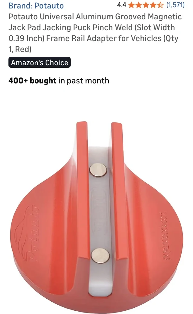

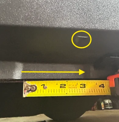

I find this metal puck more durable than the rubber ones. Magnet in the grove to hold it in place while I position the jack…
Thank you. The Potauto puck looks good being that it is aluminum and having that magnet feature. I read that it has a 3 inch diameter which looks like it will fit perfectly in the pinch weld.

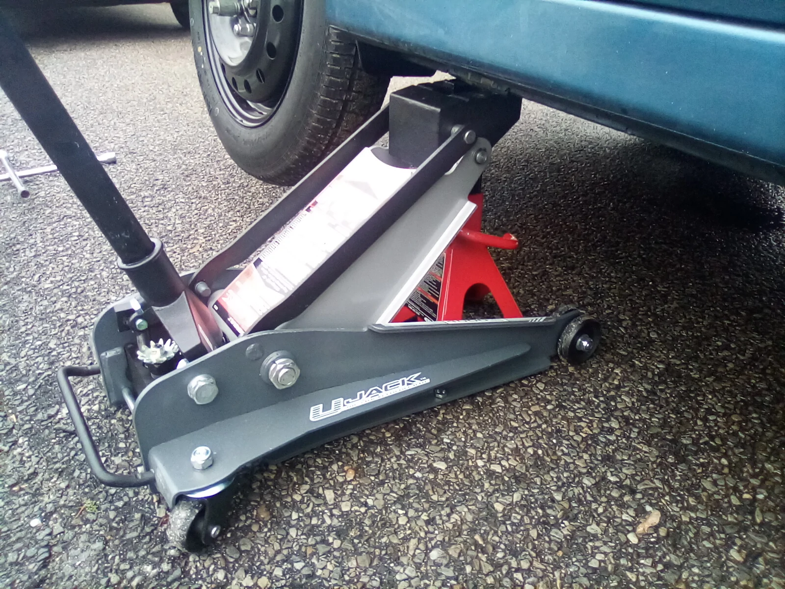

Just curious about the type and weight rating of your four jack stands that you have as I need to get some also. How do you support the pinch weld using the jack stands? Is there a pinch weld support/adapter that fits on the top of the jack to make it secure?

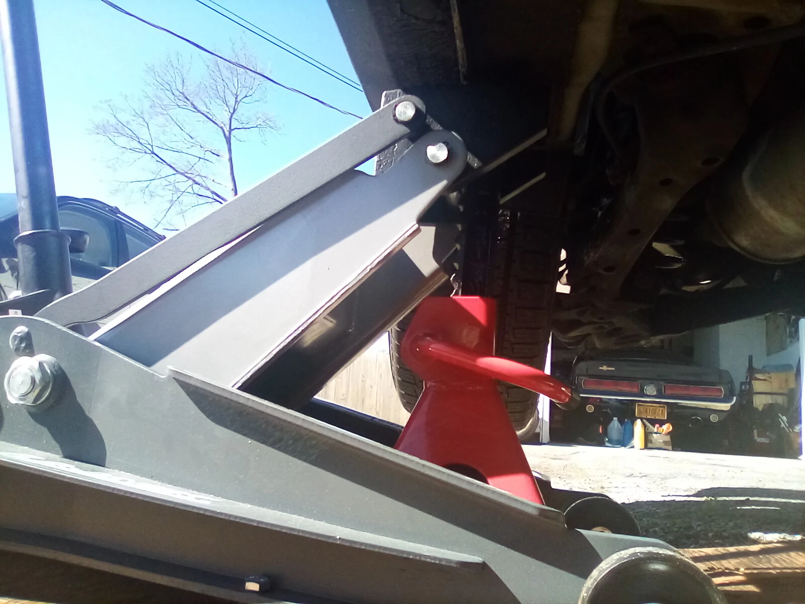

I needed a new jack anyway so I bought this one along with the jack stands. Works well.

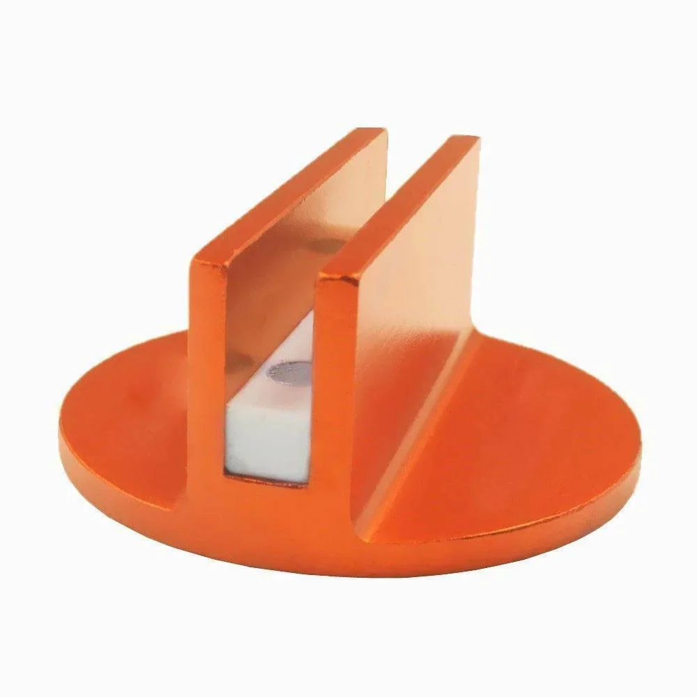

I got this one:
https://www.walmart.com/ip/imUfer-U...lamp-Weld-Frame-Rail-Adapter-Orange/575120091
Ford Maverick Finding the elusive jack points on a '25.  (pictures? and getting it on jack stands)) 1774229715721-fk
It was $9.99 delivered (now $12!), and was already in Walmart's inventory for delivery.
I'll use it for the jack, and jack stands at the jack points.

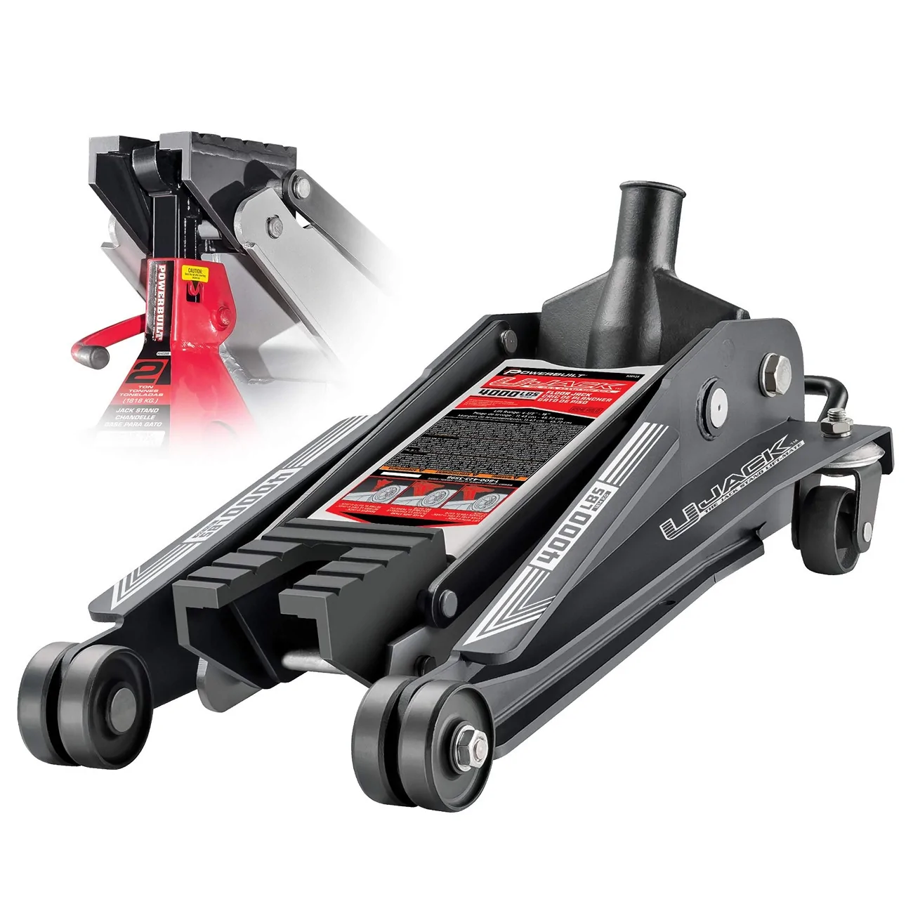

If I weren't already overrun . . . I have my 3 ton Pittsburgh, my father's venerable 3 ton craftsman, a three ton low profile, a small hydraulic jack, and a pile of cadillac scissor jacks!

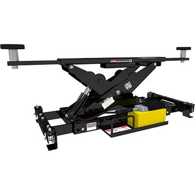

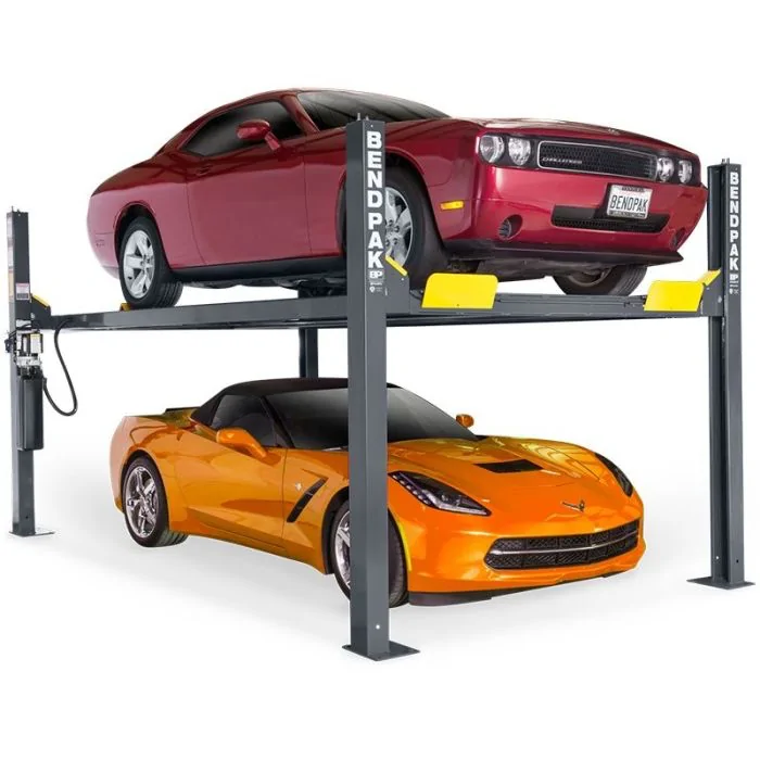

Yeah, I'd say that, but my expected permanent solution is a pair of these:
Ford Maverick Finding the elusive jack points on a '25.  (pictures? and getting it on jack stands)) 1774230026522-hj
Bendpak RJ45LP
riding on one of these:
Ford Maverick Finding the elusive jack points on a '25.  (pictures? and getting it on jack stands)) 1774230185418-1c
Bendpak HD-9
Pricey, but cheaper than giving up a garage slot once it's built!
:crackup:

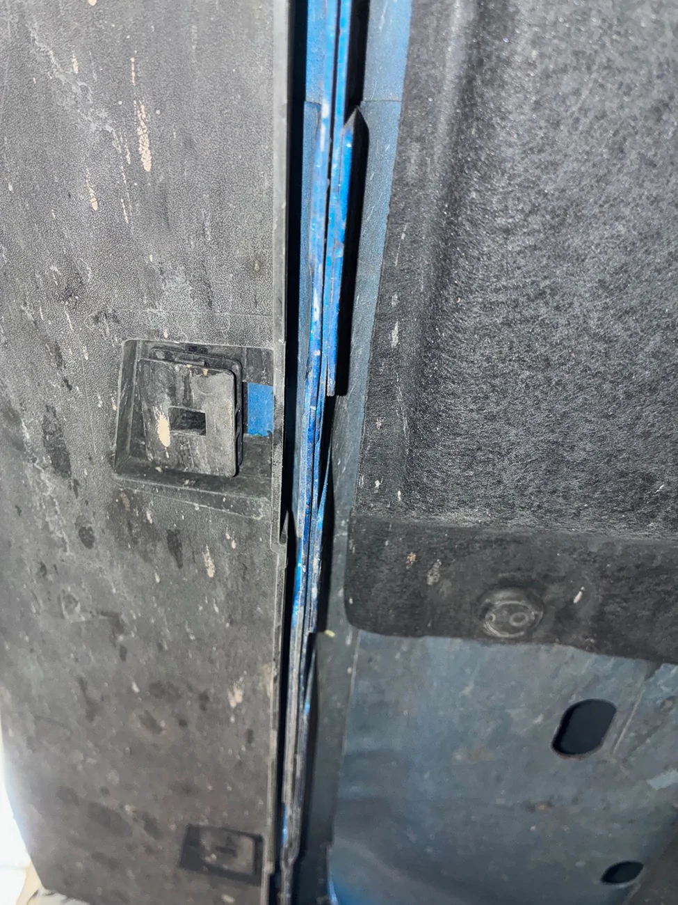

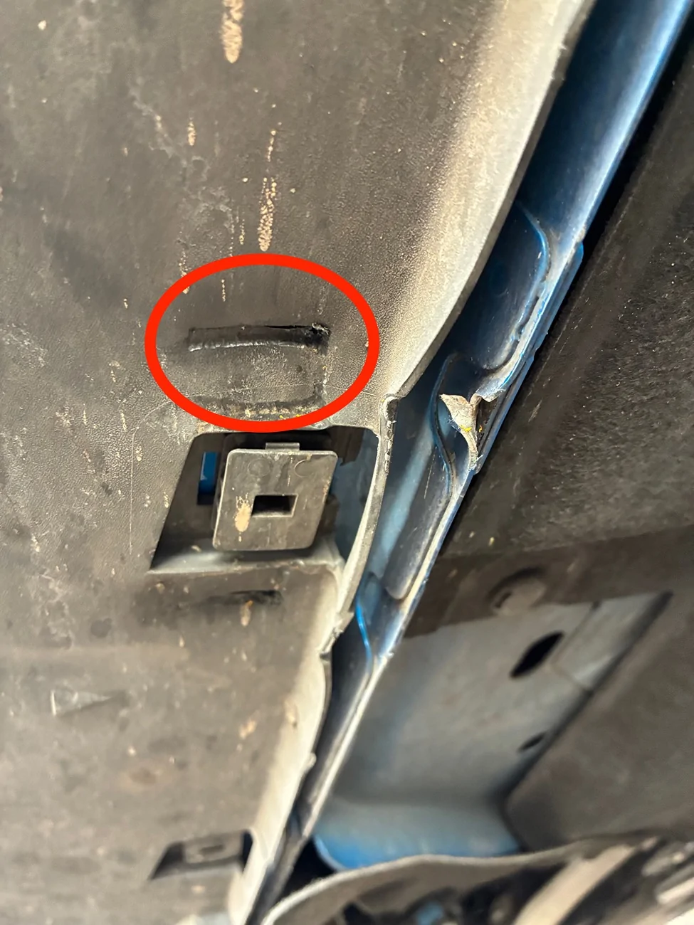

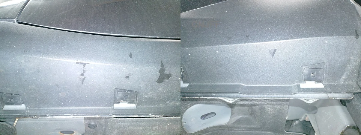

apparently, my 25 Lariat has plastic panels where these others don't, obscuring the arrows:
Ford Maverick Finding the elusive jack points on a '25.  (pictures? and getting it on jack stands)) IMG_1094

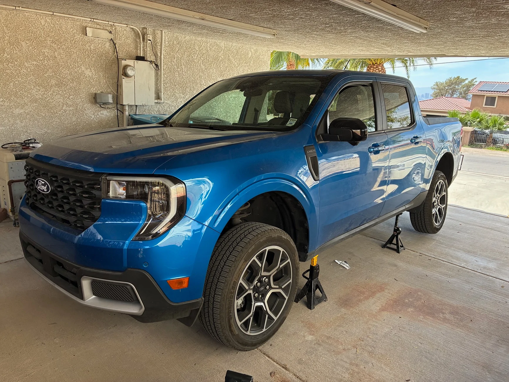

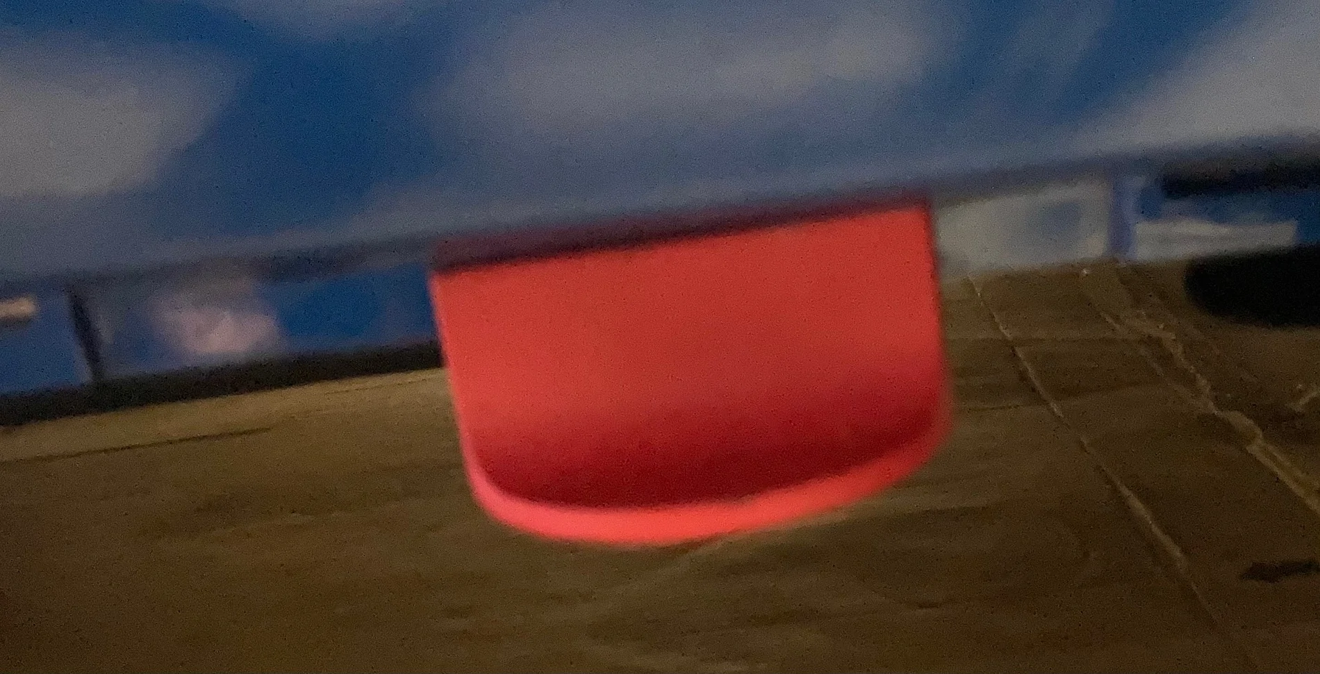

So I used the puck below where the doors meet on each side, the larger jack stands in the front, and the smaller in the back:
Ford Maverick Finding the elusive jack points on a '25.  (pictures? and getting it on jack stands)) IMG_1098
This generally worked well, except that:
1) Cheap Chinese manufacturing on the puck. One of the magnets was so weakly bound to the puck that it stuck to the first pinch weld it touched instead of the puck when it was pulled away!
:rolleyes:
2) I lowered the back wheels after rotating the tires, so that I could get the front wheels higher (the smaller back jacks were at the the furthest extension I felt comfortable with). I'd had to use the front ones sideways, as the plastic panels were in the way of the reaching arms. Apparently a bad idea; as the right front was lowered, it slid and punched a hole.
Ford Maverick Finding the elusive jack points on a '25.  (pictures? and getting it on jack stands)) IMG_1117

I can't convince myself that that the left circle has an arrow and not a dirt smudge!
:crackup:
but I can see the one on the right now.
I had both "wings" of the rack under triple pinch weld, as I couldn't find a position with the slot at the weld that wouldn't have the wings punching through plastic.
When I first set up, I lay on the ground to align. I foolishly didn't do that when I lowered the Maverick back down after removing the rear jacks.
If I ever do this again, I'll get pucks for at least the front. Hopefully, though, all future changes will be on a rack.

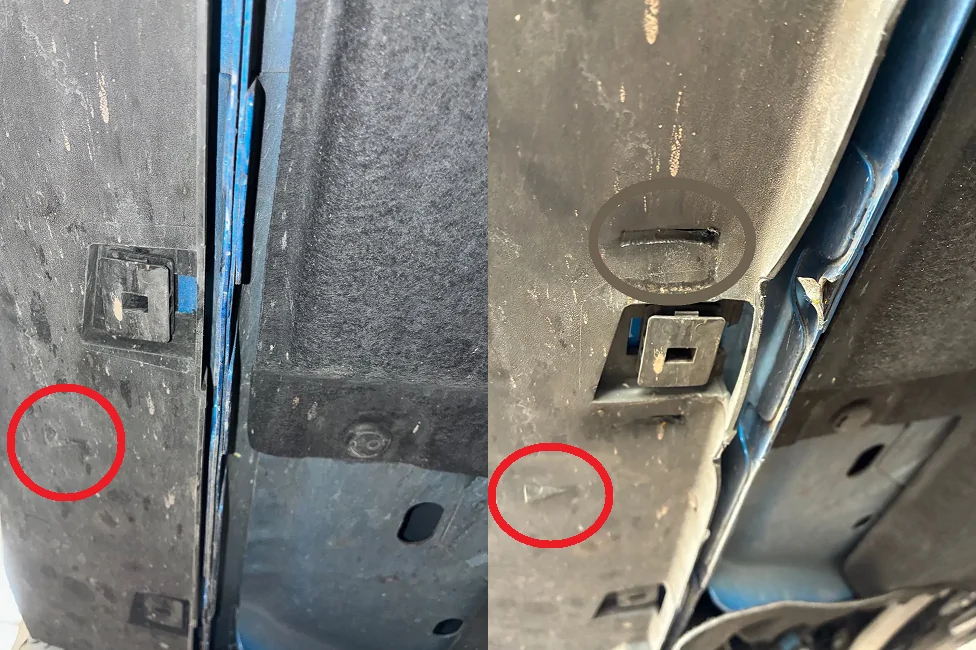

They are in your pics. 😬
Ford Maverick Finding the elusive jack points on a '25.  (pictures? and getting it on jack stands)) {filename}
May not have helped reduce that damage, though.
Don't those look like indents?
24MY is an outdent - pretty easy to feel it sticking out from surface around it without looking.
CNJFF
Jul 14, 2025
210
365
NJ
Nah they are definitely out. In the pic on the right the brightest light comes from the left for both the triangle and the pinch weld. Plus the far side of the triangle is visible along the bottom but thin as the camera is almost level with the surface.

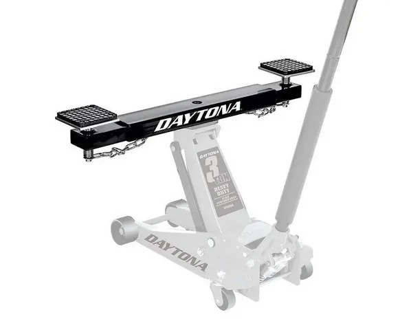

How do you use that with your Maverick? Do you jack up the whole side of the truck?
Yes, you place it under the front and rear jack points on one side.
It makes tire changes a lot easier, and it doesnt torque the truck at a weird angle so it requires less effort then jacking up one point.
