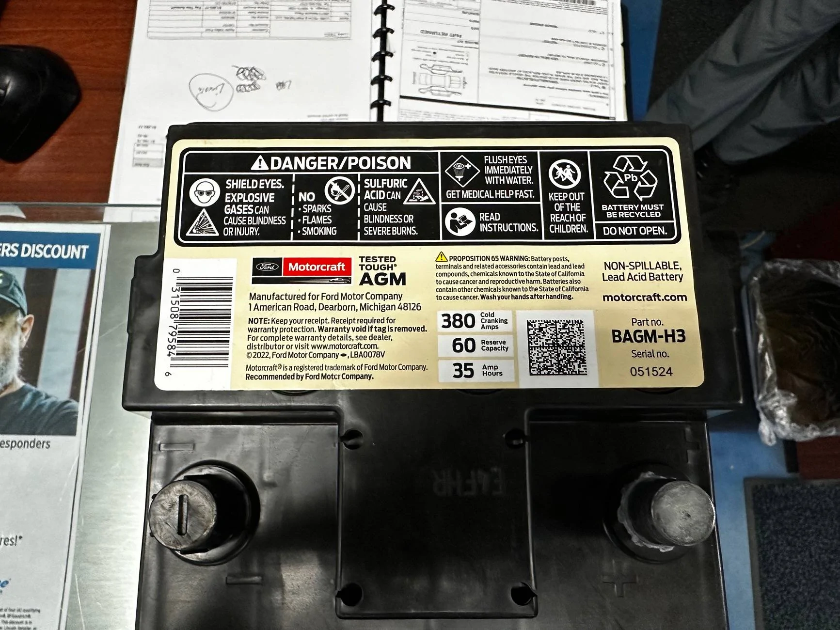

I've lived with the deep-sleep issue for the year since delivery of my '23 Lariat Hybrid, and I refuse to disable capabilities to avoid this issue; one shouldn't have to do that on a vehicle on which one paid for those capabilities. I use Ford Pass summer and winter to fire up the truck in a large parking lot to get it decently cool in the summer and get a jump on defrosting and snow removal in the winter. (The latter in particular is a real safety issue, as anyone who's had their windows frost up on the inside for many minutes after a cold start on a frigid day knows well.)
A month ago I took the truck to my dealer, asking for an AGM replacement. Much to my surprise (from all the dealer-resistance comments I've seen here on multiple threads on this topic), their service manager said they'd install an AGM on their own dime, and have been doing so for many of their Maverick owners. They said they've been eating the cost, as Ford basically has told them to pound sand, but feel they owe it to their customers. They've been keeping track of their replacements in case Ford relents, but don't hold out much hope.
Here's the battery they installed (while I waited—about 90 minutes):
Ford Maverick FINALLY!! An upcoming 12v battery fix for hybrids!!! IMG_0489
I was a bit disappointed to see that it's an H3, not H4 size, and only bumps the reserve capacity by 10 from the original (and actually reduces CCA, but that's not an issue with a hybrid). So far, so good; I've had no deep-sleeps since replacement. Another Minnesota winter will tell the tale (though perhaps not, as the truck lives in a heated garage at home). I'm sure I'd have more idle "hang time" with an H4, but I have a battery maintainer I can plug in for those longer downtimes. In any case, with luck the apparently impending software fix will solve the real problem—excessive parasitic losses.
BTW, I offered to write my dealer a glowing review about their customer service on this issue, but they asked that I not do so (or identify them), as they don't want everyone in the whole region descending on them for AGM replacements for which they're not getting warranty reimbursement. I'm honoring that request, as they've treated me very well: They sold me my Mav at MSRP—with a military discount—during the peak of the 2023 ordering frenzy. (They also subsequently bumped my priority, yielding the coveted VIN/production-date email four days before I was looking at rolling over to a '24. I waited "only" 375 days from order to pickup).
