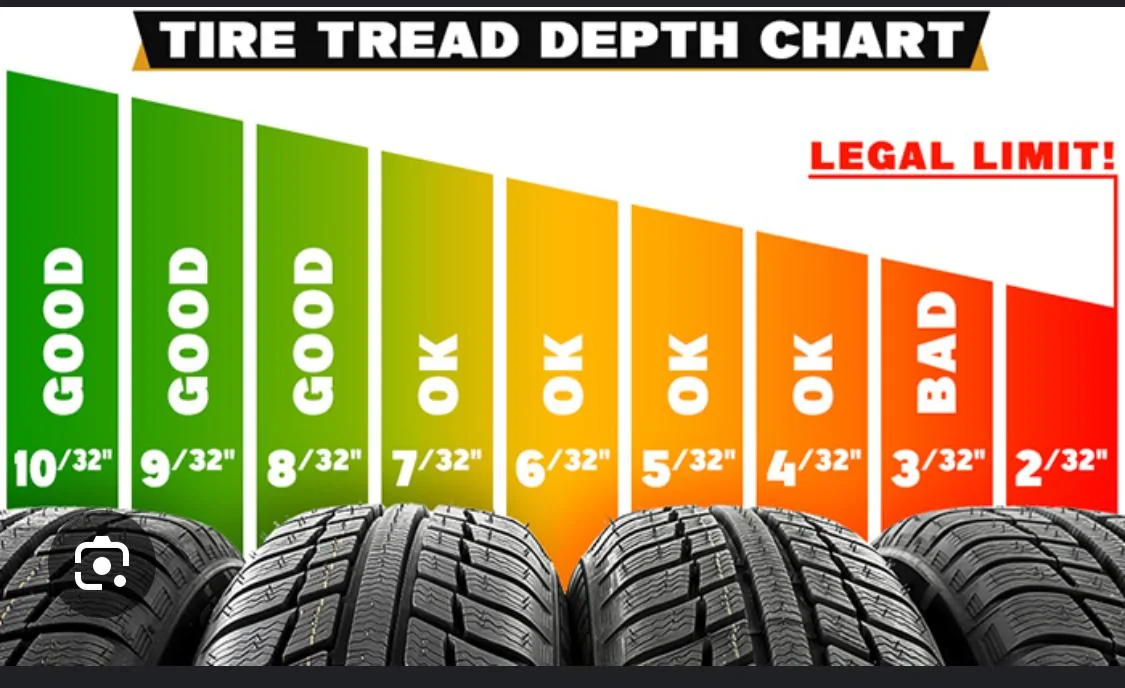

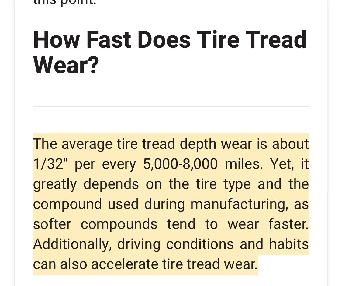

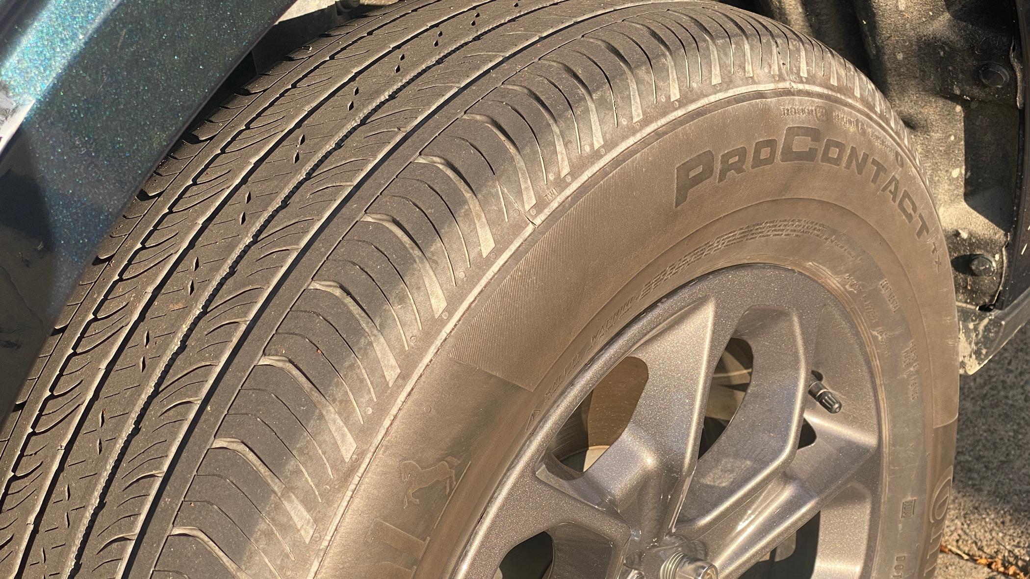

This is what 6/32" looks like.
People (the mind in general) do not comprehend how small 1/32" is. Maybe our perceptions are skewed by all the "knobby" off-road tires people use on streets.
6/32" at 23,000 miles means the stock factory tires are not crap, but on the good side average.

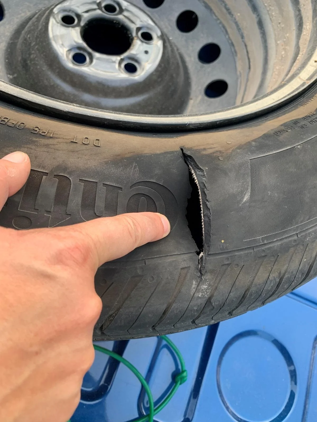

It's funny when you have that one member who has the Goldilocks experience with a piece of crap like the Continentals tires and jumps thru hoops to make sure everyone who has had a bad experience with them know that they are wrong just because they haven't experienced those problems.
If everything goes exactly perfect and you never have to pull off of perfect pavement you may never have problems with the Continentals. If everything doesn't you will find just how crappy they are.
I have put 24 years of 6 miles per day testing on tires on my dirt road. The Continentals are by far the worst tire I have ever had on a vehicle. My road was in the best shape it has ever been in when we got our Maverick and the Continentals were cut to pieces with 3 flats in 3,300 miles. They proved to be absolutely unusable for me.
The only thing I regret is not knowing how bad they were and having new/used tires I could not resell due to being cut to pieces and plugged and patched. I recommend anyone who may pull off of a perfect road get rid of the Contis before they are cut up and unsaleable.
