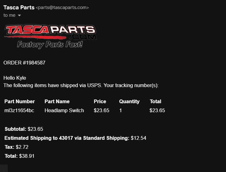

just a forewarning I ordered the switch from Tasca - order went through but then got an email claiming national backorder with no ETA so they've cancelled the order
Mine just shipped!

Cal,
You are a bargain hunter.... I paid more for the switch, but less for shipping. Almost a wash. But you got a better deal by about $3 total.
I could definitely survive without the back lighting, but if could be enabled with the running lights that would be cool. (I was going to go the SS3 route before and would have chosen no backlighting).
Anyway, I ordered the Elite Foglight Kit last week and the Ford F150 switch today. Now, when all of the stuff comes in, I'll just have to see what progress folks are making with getting Forscan working on MY2024.
Okay... first place sold out and cancelled the order almost immediately after making this post.... Ordered from another place, Tasca, but it will have a 7-10 delay or as great as 30 days if it's backordered.. No worries.. the Fog Lights won't arrive until March anyway.
<however, now I just read another member had his order through Tasca cancelled as well.. so I guess I'll get that email soon too>
Want to correct something... I actually ordered ML3Z-11654-BC because I have an EcoBoost which doesn't have the locking fuel door... I accidently referenced the photo that showed the 'DC' part. So, I don't know if the 'DC' parts are actually out of stock.. but I got a note that the 'BC' part was... Just don't want to cause a panic.
