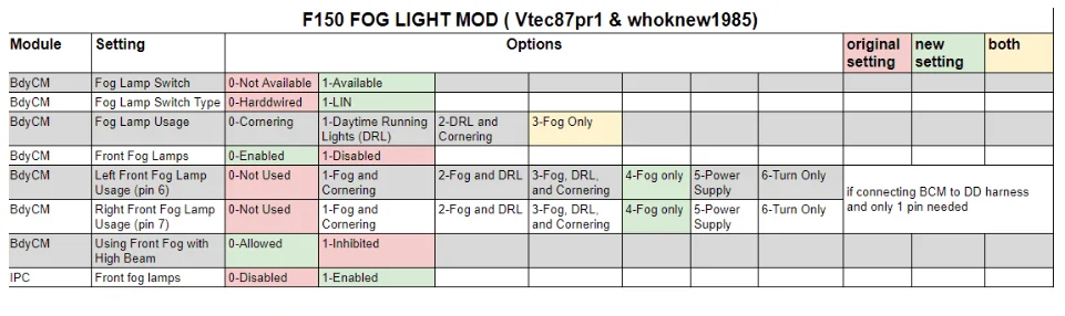

NICE!! This is a great visual for my crap descriptions.
EVH5150
Mar 10, 2023
239
422
Southern Vermont
2024 Maverick Lariat Tremor "Poundcake", 2014 Ford Focus ST "The Atomic Punk"
And this chart was a lifesaver for the FORScan programming:
Ford Maverick F-150 Fog Lamp Switch and Wire Harness Installed in Maverick - DIY 1754158571046-8f
Very simple to follow.

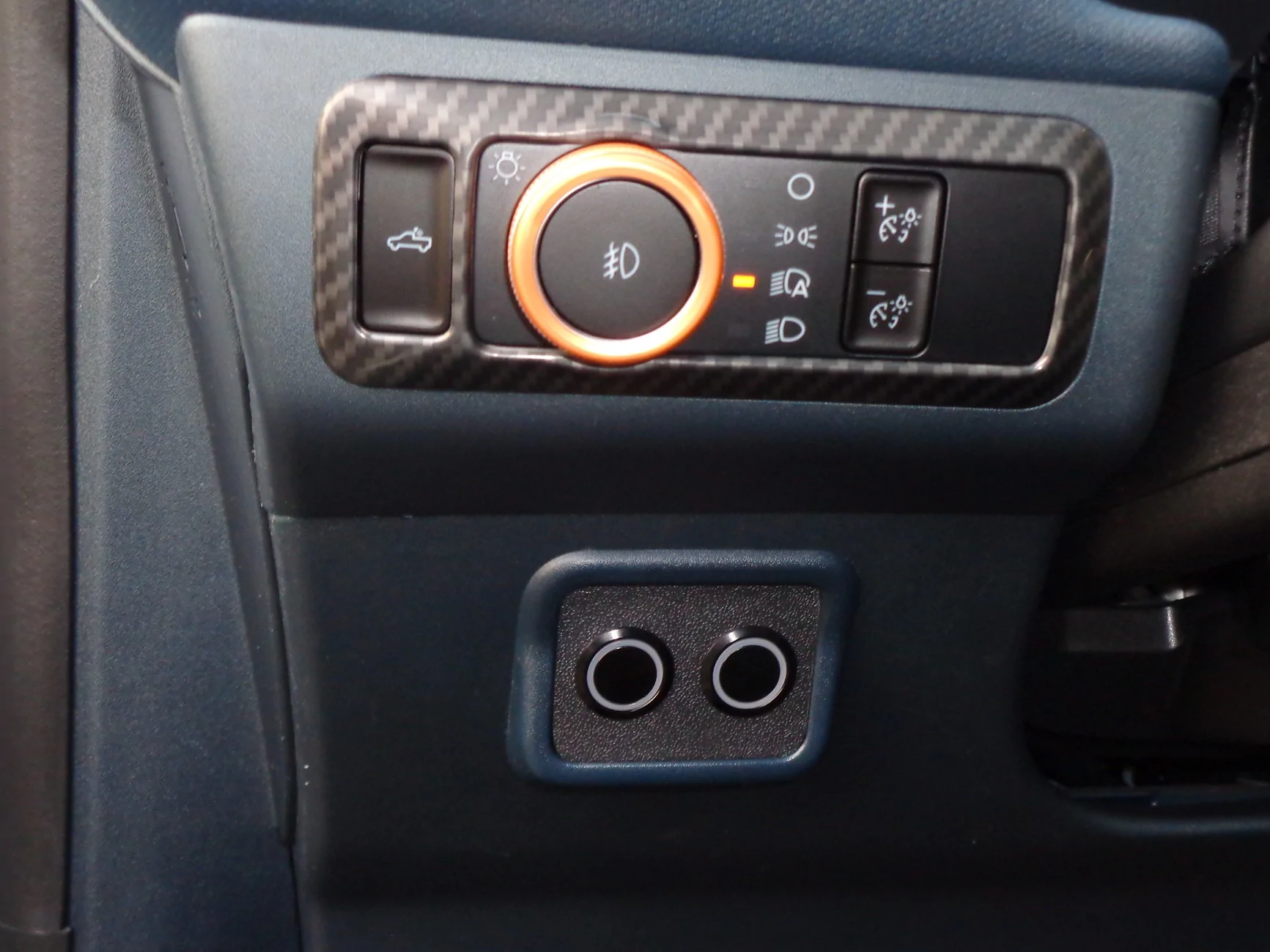

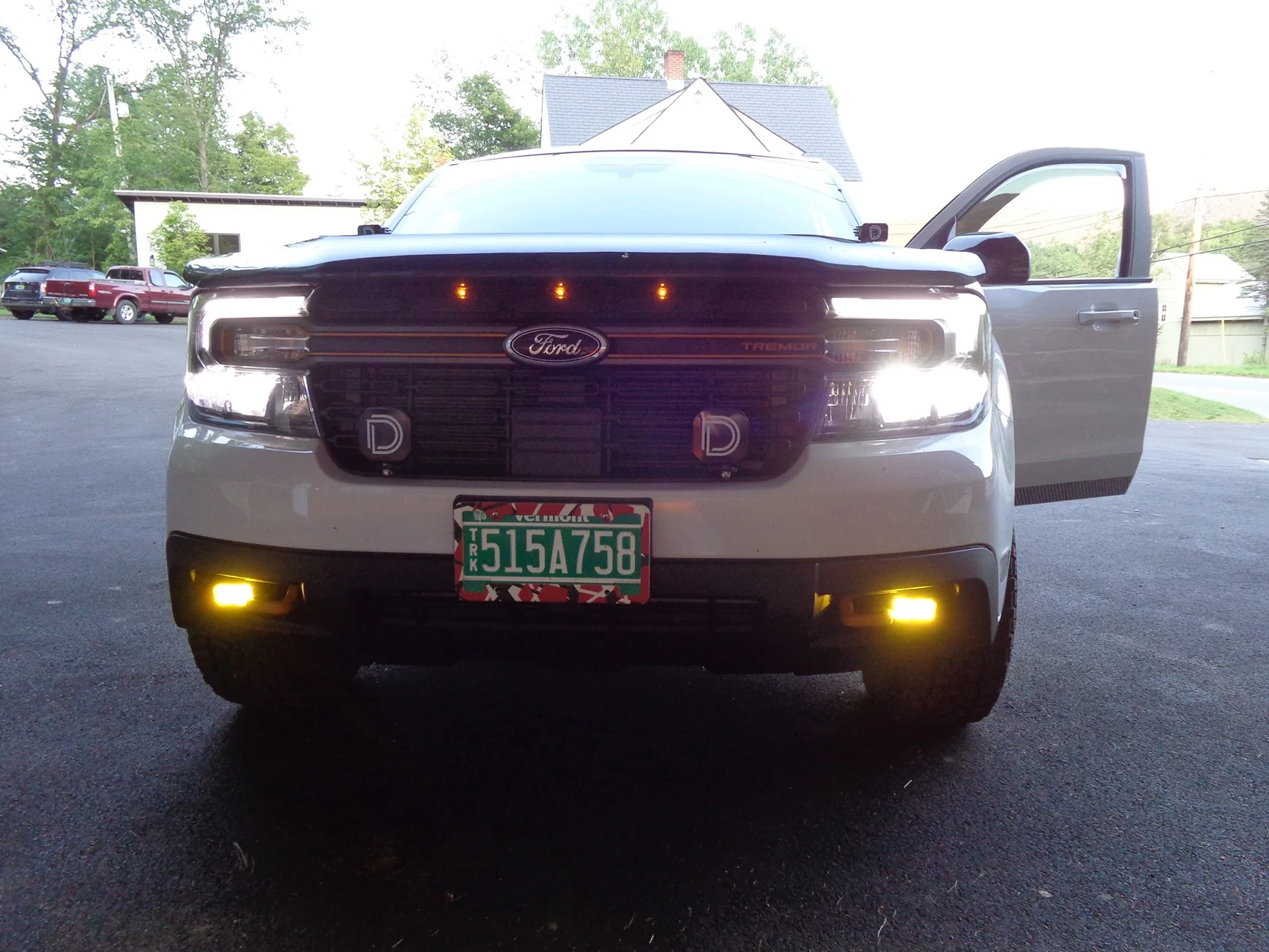

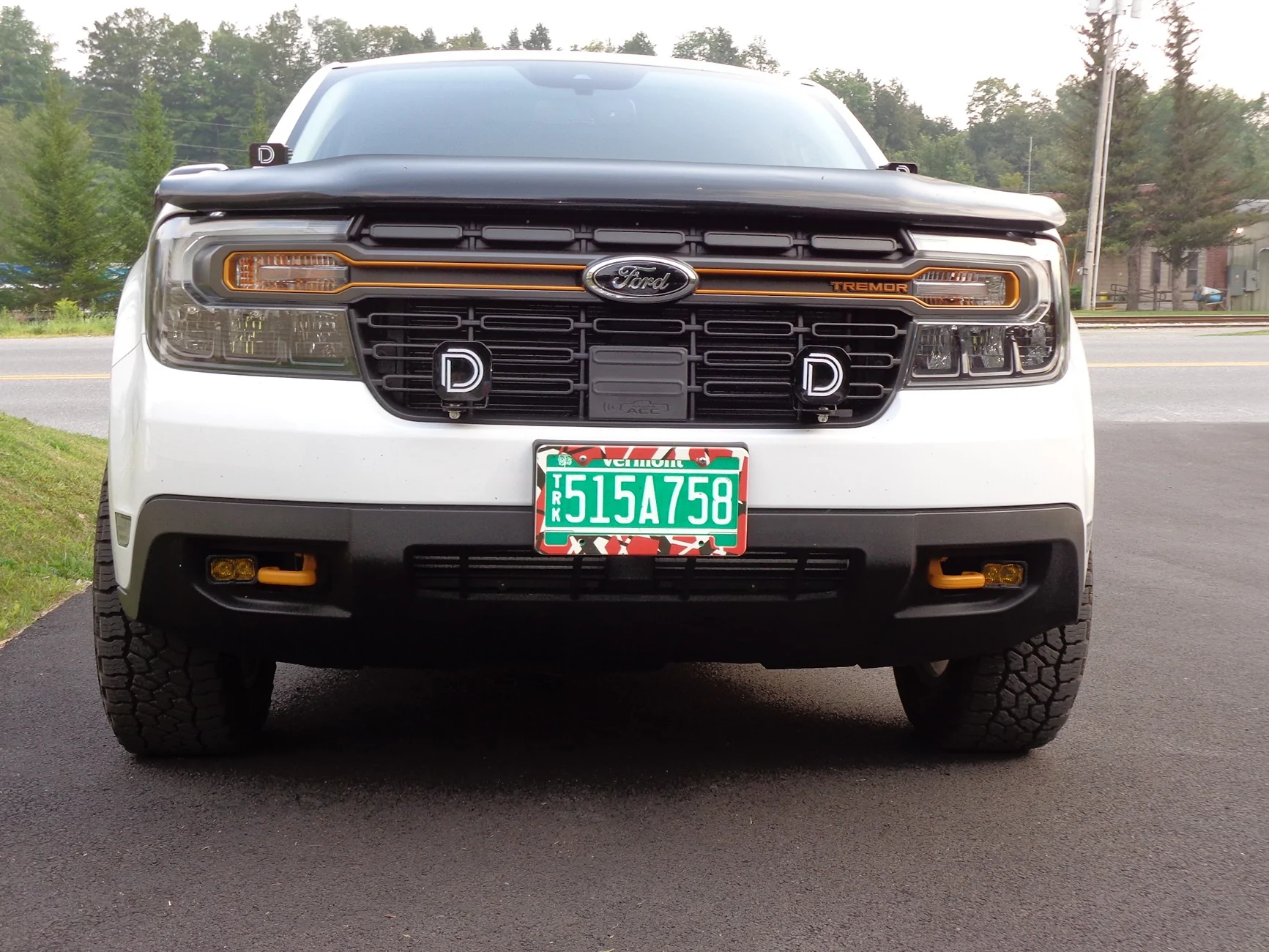

Installed pics:
Ford Maverick F-150 Fog Lamp Switch and Wire Harness Installed in Maverick - DIY DSC00746
Ford Maverick F-150 Fog Lamp Switch and Wire Harness Installed in Maverick - DIY DSC00752
Ford Maverick F-150 Fog Lamp Switch and Wire Harness Installed in Maverick - DIY DSC00751
Lighting Command Central: F150 headlight switch for fog lights, Apiele LED Halo switches for ditch lights and bumper lights.
Ford Maverick F-150 Fog Lamp Switch and Wire Harness Installed in Maverick - DIY DSC00755
Ford Maverick F-150 Fog Lamp Switch and Wire Harness Installed in Maverick - DIY DSC00749
All of the wiring is run in separate looms with DT weathertite connectors. Diode Dynamics Ditch and Bumper lights are wired using Diode Dynamics' heavy duty wiring harnesses, shortened to appropriate lengths, and of course, the DD fog lights are wired through the BCM using the F150 headlight switch.

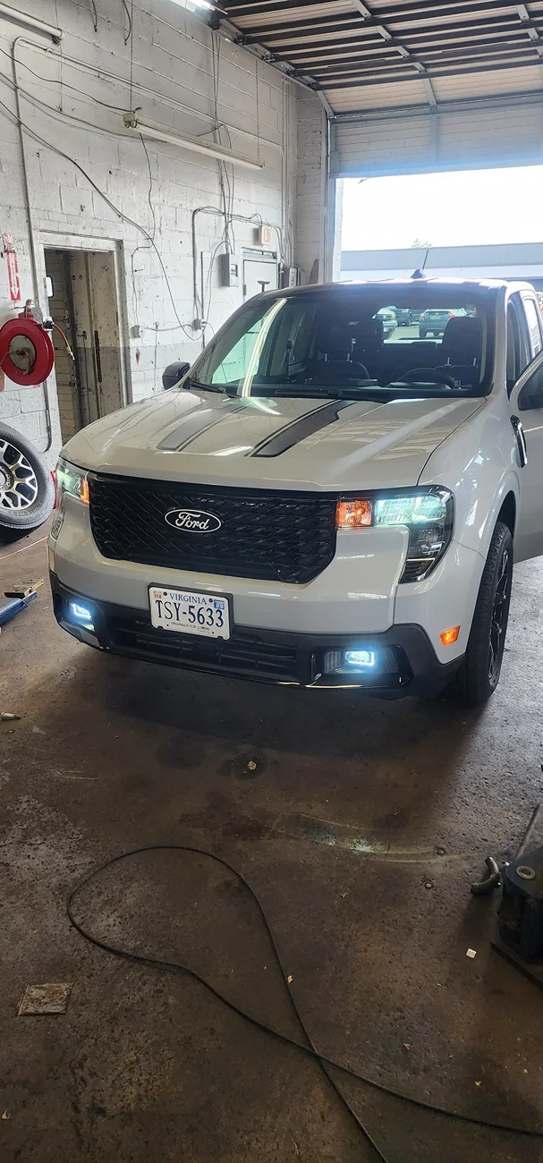

Another happy Customer with his own 2025 Ford Maverick custom brackets and fog lights harness made by me. The brackets im not sure where he got it from.
For ppl that want to contact me please reach out my instagram vtec87pr.

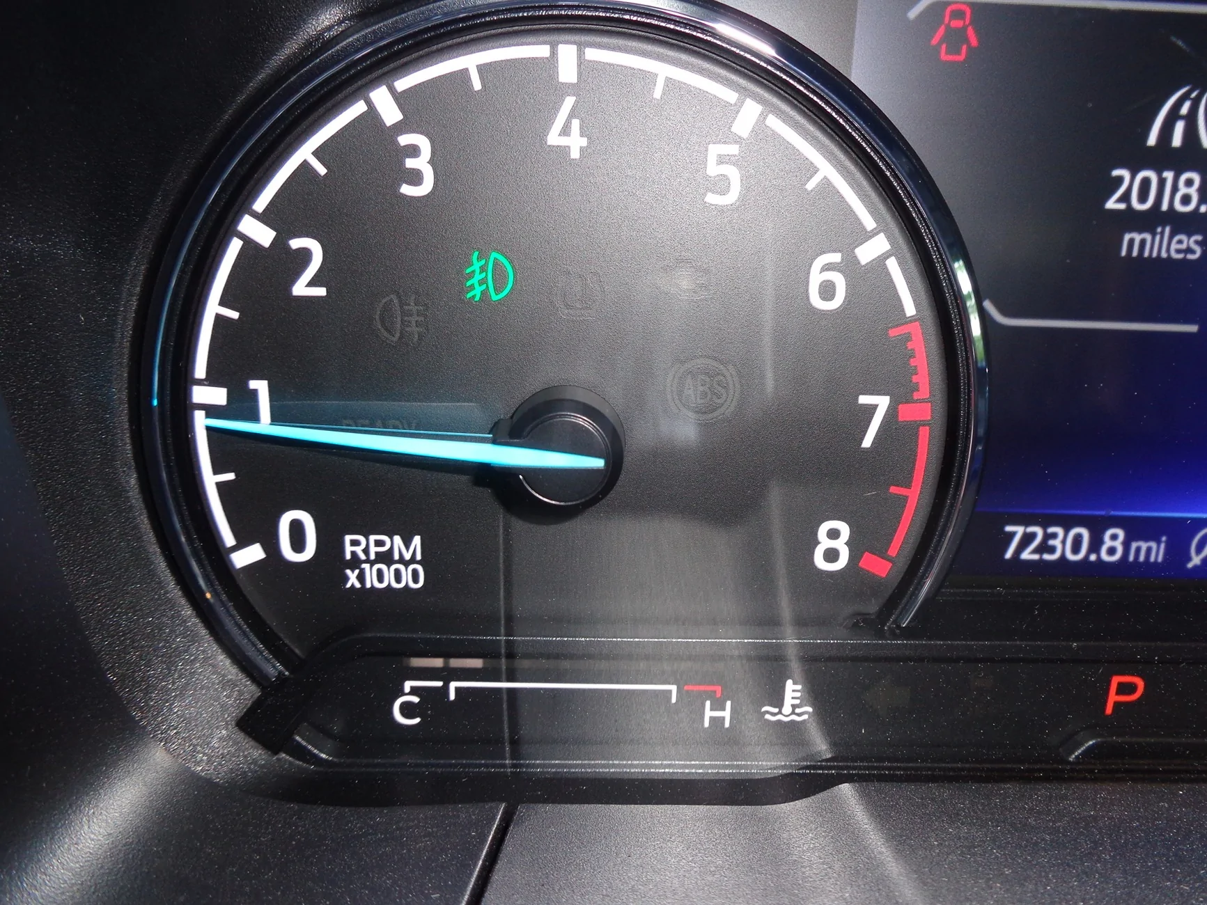

I wanted to Install Some Ford Fog Lamps on the Truck and seem that Ford Escape as the same Bcm conector as the Ford Maverick.
I Checked and Found that Ford Escape , Ford F150 and Ford explorer had similar headlamp switch. I Found one on Ebay that came from a Ford f150 with the factory fog lamp switch on the center dial. Install it and with forscan enable it. Heres some pics of the process. Need to enable on BCM and IPC .

hey bro I’m doing this conversion, the pin 6 and 7 are those both power wires? Or are those power and ground. I appreciate the information. Thank you in advance. This has all been super helpful.
EVH5150
Mar 10, 2023
239
422
Southern Vermont
Those wires from the BCM are both positive, one is for the left light, the other for the right.

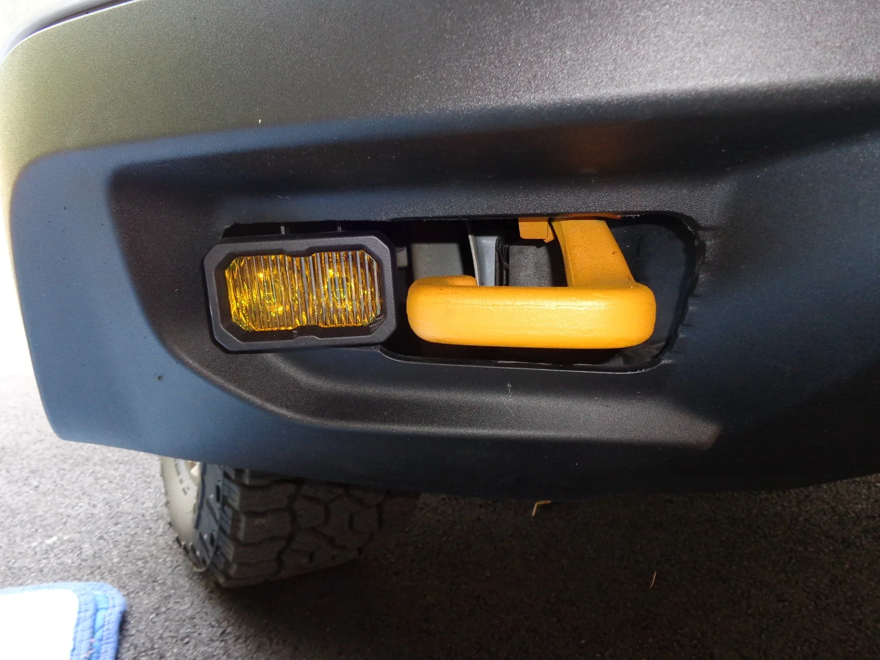

Thank you Vtec87pr1 and everyone else who contributed to this thread. Took me two days to get everything done, but I now have a nice factory looking install.
Possibly someone mentioned before, but the bumper where it meets the fender at the top near the headlight, is not as easy to pop out as the video makes it look. Had to squeeze the clips from the back, in order to pop them out from the fender.
Tried the Forscan option for Fog and Cornering, but the cornering part doesn’t work. Possibly because that option is only under each fog light and not in the general fog light usage.
Also, not a big deal or anything, but it seems like after relocating the speaker for the hybrid with the provided bracket from Diode Dynamics, it somehow made it a little louder.
