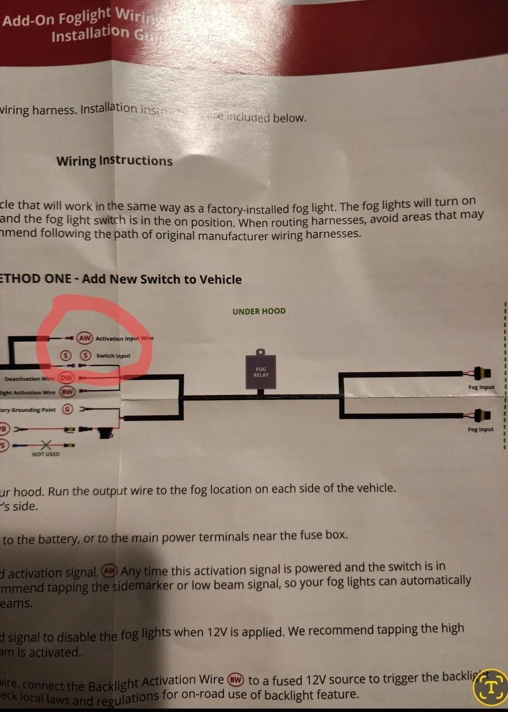

Ok i got my set of fog lights from Diode Dynamics and got their wire harness with me and wiring diagram. I have been sick for the past 3 days with covid or flu but unable to touch my truck or think straight stucked on bed.
Heres a picture of the option if you want to use their harness and my bcm terminals to fog lights kit. If you prefer their harness then what i would do its wire up everything like they say. With the power with fuse and relay and ground to battery what ever. But the difference its where it says Switch Input install just 1 pin from the bcm to there and you should be able to use the f150 fog light switch.
Or wait for me to get better health wise and post a how to when i get a chance this week.
My exact thoughts on the switch wire to the BCM.
Still waiting on my kit. Can’t wait to see ur results.

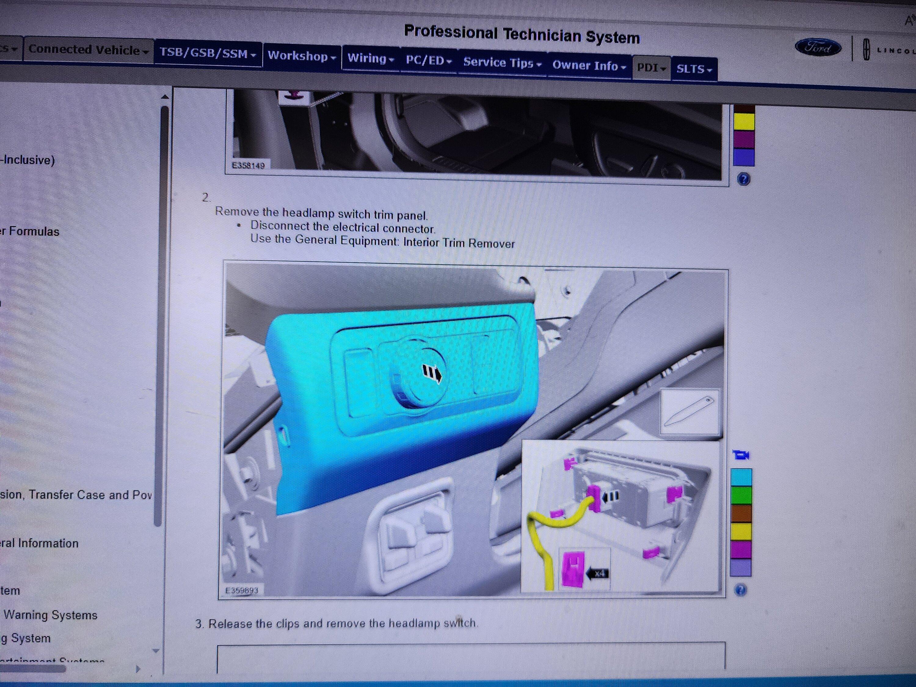

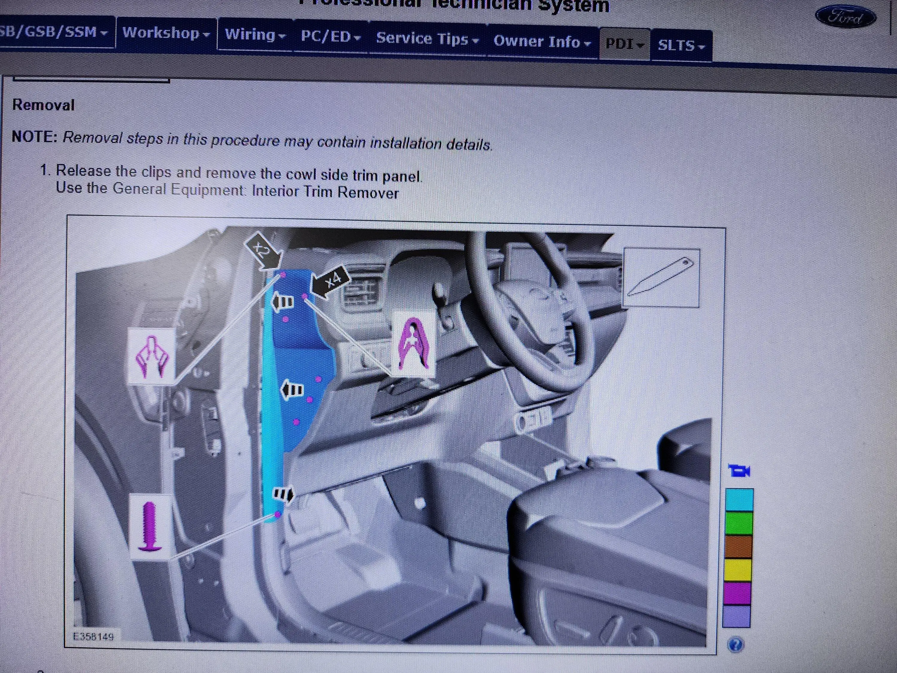

But heres the oem instructions. I didn't do it this way but this way its better way to do it.
Ford Maverick F-150 Fog Lamp Switch and Wire Harness Installed in Maverick - DIY 20240129_101958
Ford Maverick F-150 Fog Lamp Switch and Wire Harness Installed in Maverick - DIY 20240129_102006
Ford Maverick F-150 Fog Lamp Switch and Wire Harness Installed in Maverick - DIY 20240129_102009
Ford Maverick F-150 Fog Lamp Switch and Wire Harness Installed in Maverick - DIY 20240129_102017
Mini One-Fiddy
Aug 26, 2021
53
81
Jax, FL
'23 Bronco Wildtrak. '23 Maverick XLT BAP Hybrid
Cool thanks, I thought id have to take apart that whole bottom dash section to get behind it.
Thanks Tony
Nope. It pops right out. Look at your new switch to see where all of the tabs are to figure out the pry points.

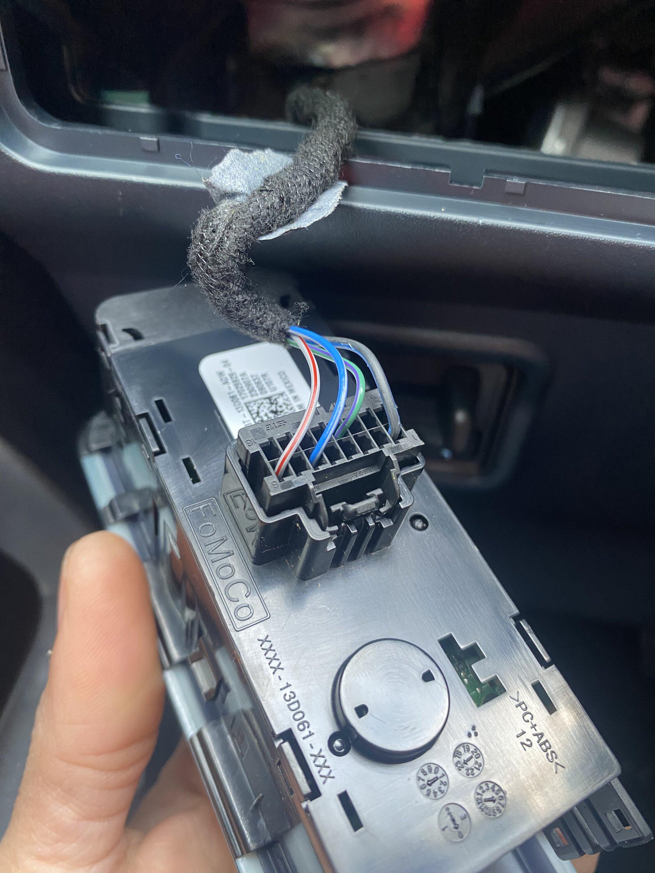

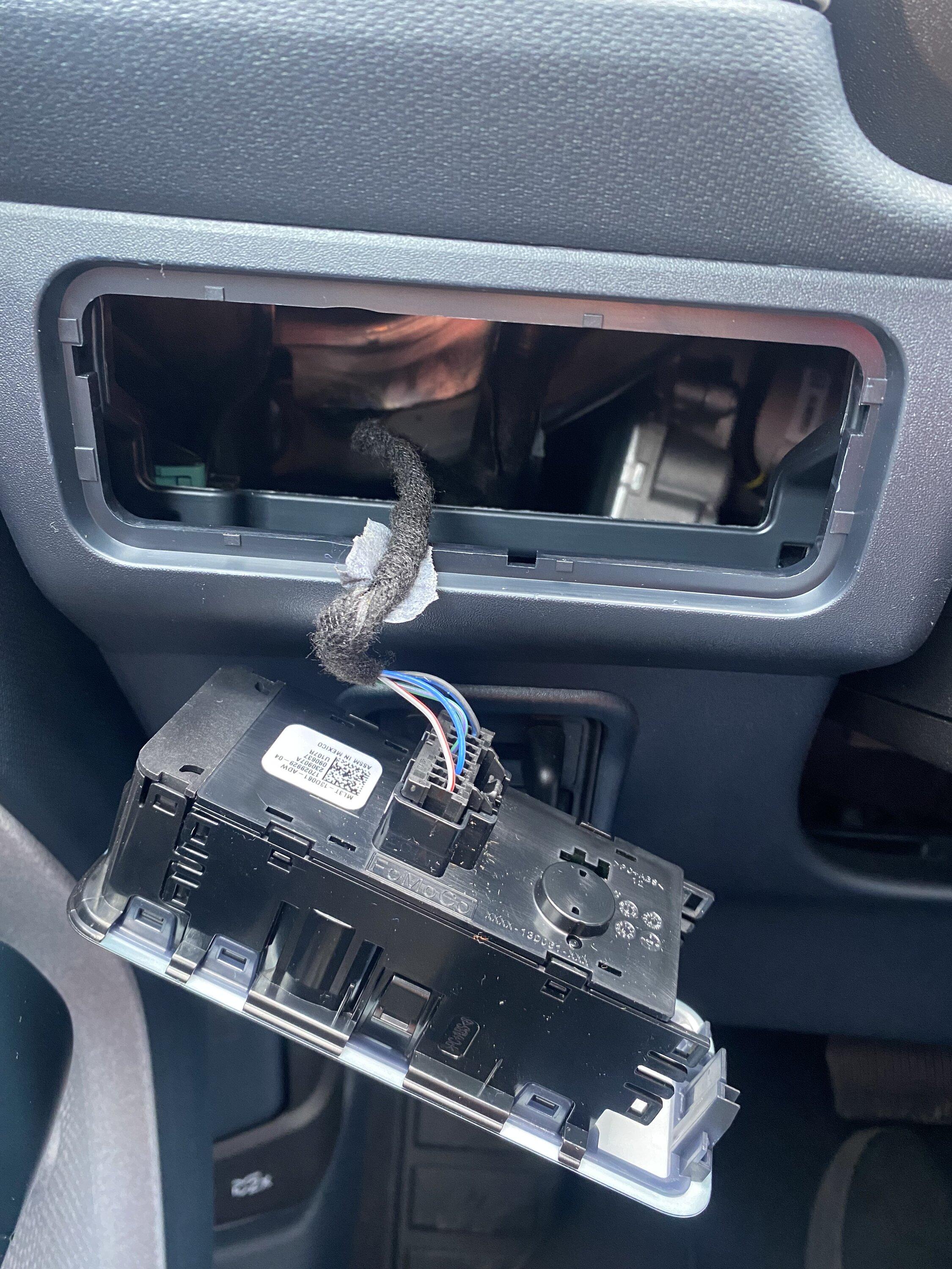

Perfect, got it. Should I have more wires on this harness for the foglight conversion. Seems there’s only 4.
Ford Maverick F-150 Fog Lamp Switch and Wire Harness Installed in Maverick - DIY IMG_3059
Ford Maverick F-150 Fog Lamp Switch and Wire Harness Installed in Maverick - DIY IMG_3058
Darnon
Jul 4, 2021
5,735
7,257
WNY
No, because you shouldn't do anything with the wiring at the switch itself. The only four wires there are: Ground, Power, Cargo (Gr/Vt), and LIN [Local Interconnect Network] (Blu/Gy) with the lattermost the digital communication line to the BCM that actual changes in the lighting are transmitted over.
