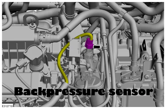

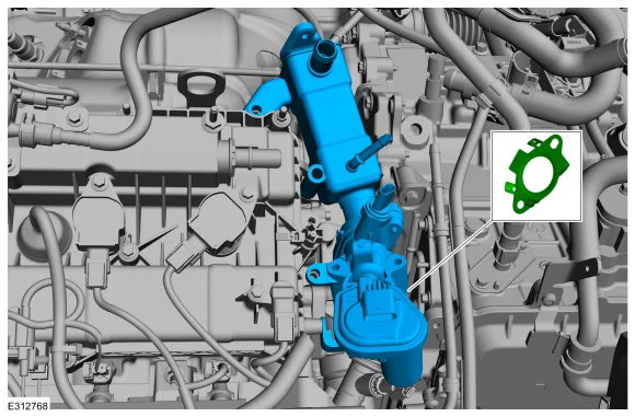

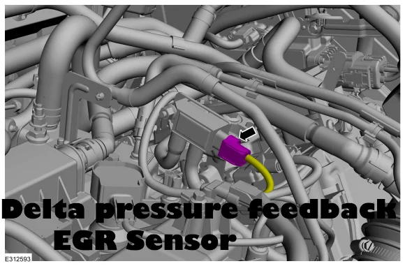

You should have it check as other things can also cause that code to set
The gasket arrow is pointing to it
Ford Maverick EGR Valve Location for 2.5L Hybrid? Engine Code P0402 EGR
Ford Maverick EGR Valve Location for 2.5L Hybrid? Engine Code P0402 DPFE
Ford Maverick EGR Valve Location for 2.5L Hybrid? Engine Code P0402 Backpressur
