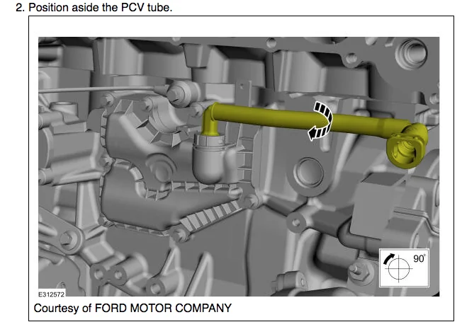

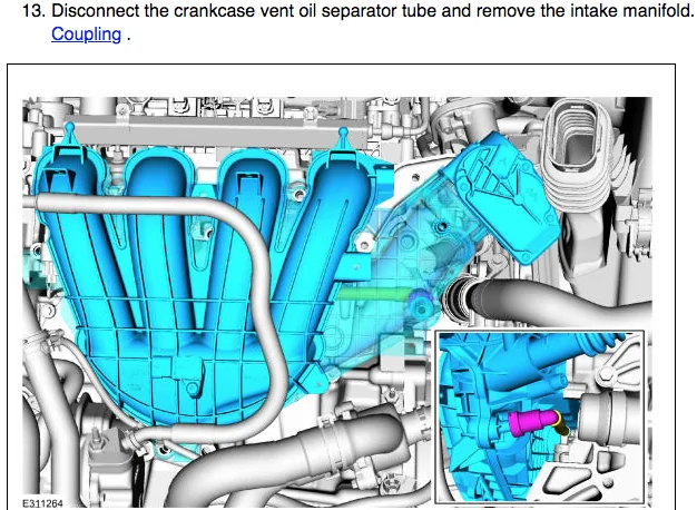

Appears part of the oil separator, but it's own tube. Maybe combined?
Mess to get to, under the intake manifold.

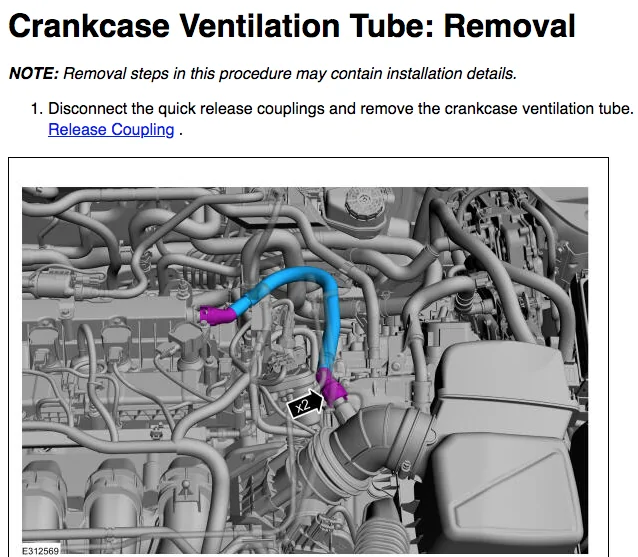

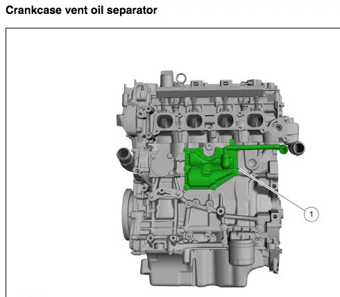

But then this is shown, which seems more like a PCV to me.

we'll that looks similar to the 2.0 ecoboost and how they set that one up. the one up top unfortunately is just a tube no pcv valve cause that call that the clean side.
The one underneath is the true pcv valve, but on the Ecoboost I can't get it out, I believe it's fixed in the oil separator.
I was hoping the hybrid wasn't fixed to it.
But the real weird thing is rock auto has the same part for both engines. I know the one I got for the Ecoboost isn't correct, but it's the only one I find online anywhere.
