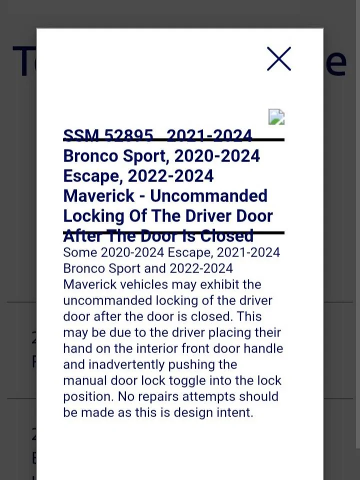

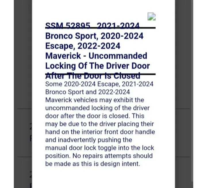

Yeah, I was one of those people that was super annoyed at this happening to me. Ready to go to the dealer and complain, I think I even posted a thread here. Then people pointed out what was happening. I felt like an idiot for sure. But "magically" it's never happened since, now that I'm aware of it. I even asked the Ford tech that came out to do a software update about it. She laughed and said that quite a few people have come into the dealer with that problem and it's always people accidentally hitting the lever.
Yep, you posted in a thread back in June.
It was happening to me a lot, to the point I was going to take it to the dealer, then I read the threads about inadvertently locking it with your hand. Now that I'm aware, it hasn't happened again.
June 3rd 2024 you were responding to

Hey BadAl ….the only problem with your statement is that it DOES happen to him….along with many others. We all accidentally lock the door with our hand occasionally. 😂😂😂🥴🥴🥴

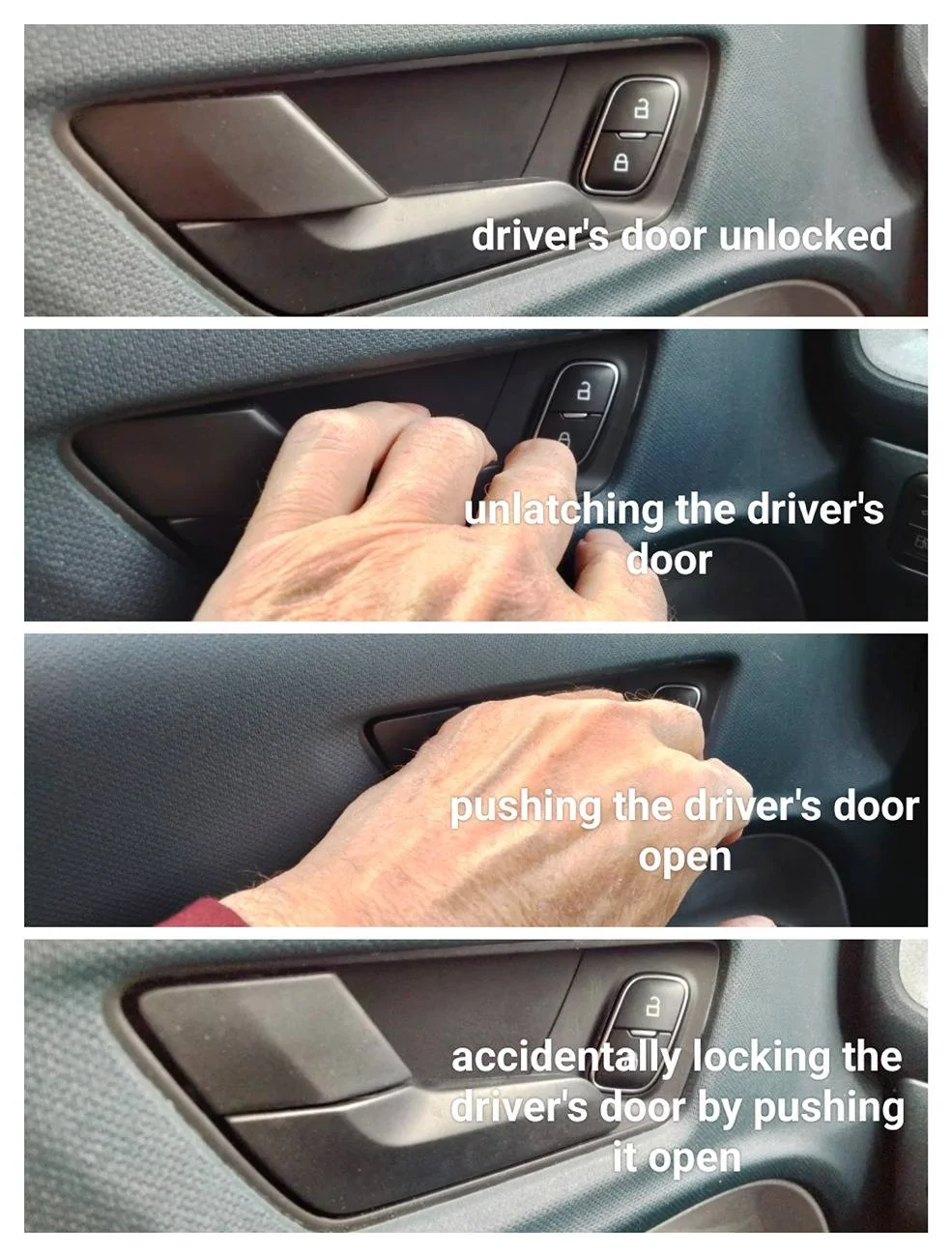

As it says it seems to be an ongoing issue. All the other doors don't lock just the drivers. This morning I drove to the lumber yard, grabbed my keys to unlock and turn on the lights. Maybe 3-4 minutes total and the drivers door was locked when i came back out???? THe dealer has no clue.
It's pretty easy to hit the lock button when you grab the lever. I do it once in awhile then I go and unlock thru the back door.
