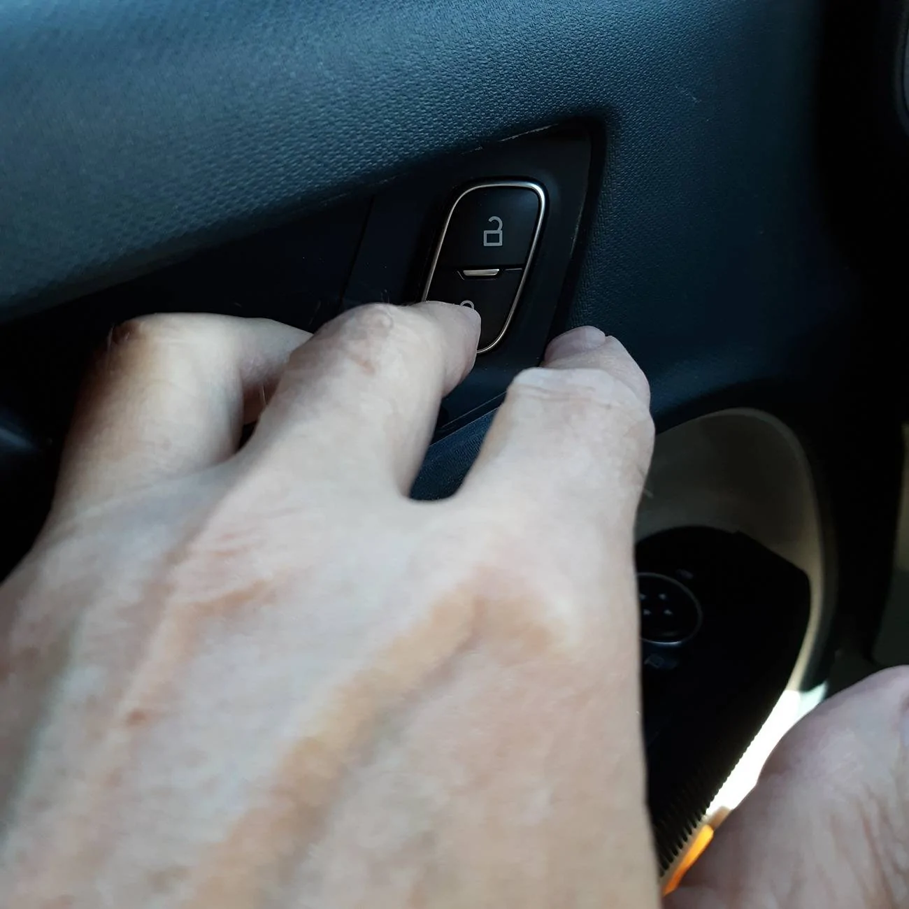

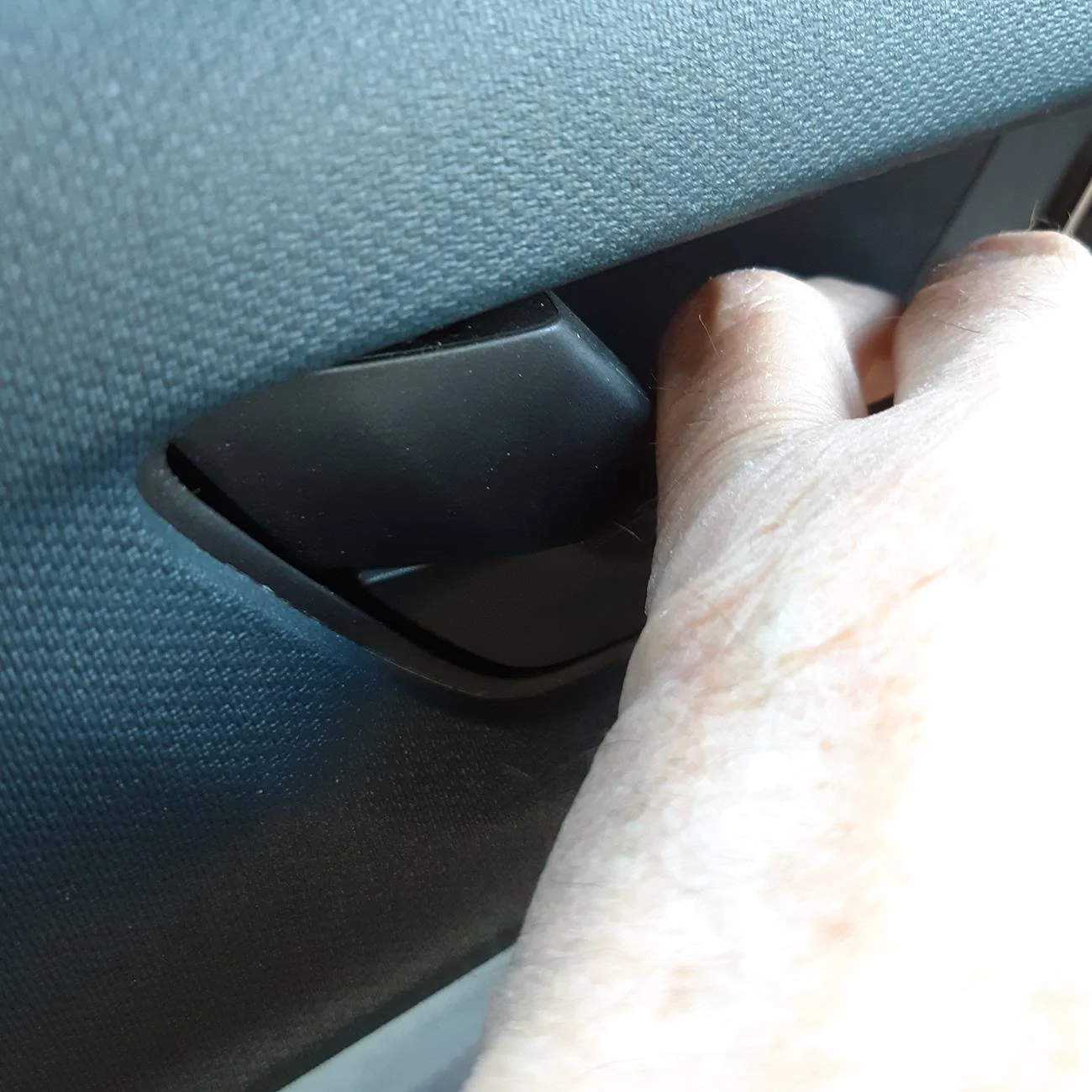

Some have admitted to either pushing the lever or pushing the button by accident when opening the door.
Others that maintain that's not what happened couldn't provide a video to back up their claims.
OR
Have not come back to the Forum. 🤷‍♂️
Ford Maverick Driver's door locking on its own 20250326_085842

No Ken, I have never gotten out of my Maverick and unintentionally locked the driver's door then thinking it auto locked.
I looked at the situation logically. Seeing where the two Locking apparatus are located. I then shot video showing how the easily the door is unintentionally locked. I've taken pictures showing how close the Locking lever and the lock button are.

Yeah, I was one of those people that was super annoyed at this happening to me. Ready to go to the dealer and complain, I think I even posted a thread here. Then people pointed out what was happening. I felt like an idiot for sure. But "magically" it's never happened since, now that I'm aware of it. I even asked the Ford tech that came out to do a software update about it. She laughed and said that quite a few people have come into the dealer with that problem and it's always people accidentally hitting the lever.
