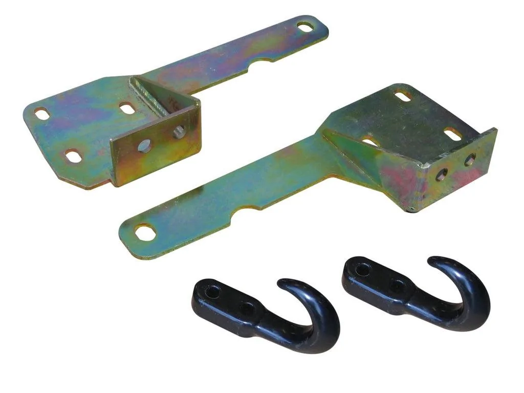

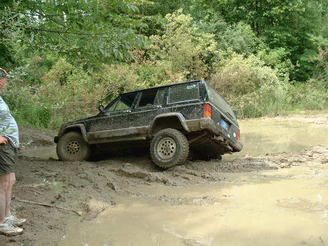

While I am waiting for my Maverick, found this old thread on tow hooks. I am sure someone will eventually come out with a kit that sandwiches the unibody. I had this on an older jeep Cherokee that was unibody and it never let me down...attached photo was me trying things I shouldn't be trying
Ford Maverick Does anyone else want front tow hooks on their Maverick? rustys-tow-hook-kit-xj-613951_1024x768_crop_center
Ford Maverick Does anyone else want front tow hooks on their Maverick? SINKINGXJ.JPG
I wouldnt recommend using those straps or hooks, I did see that winching hole but I wonder how well its reinforced, maybe its just used for a tow rope, metal hooks may rip right through it.
