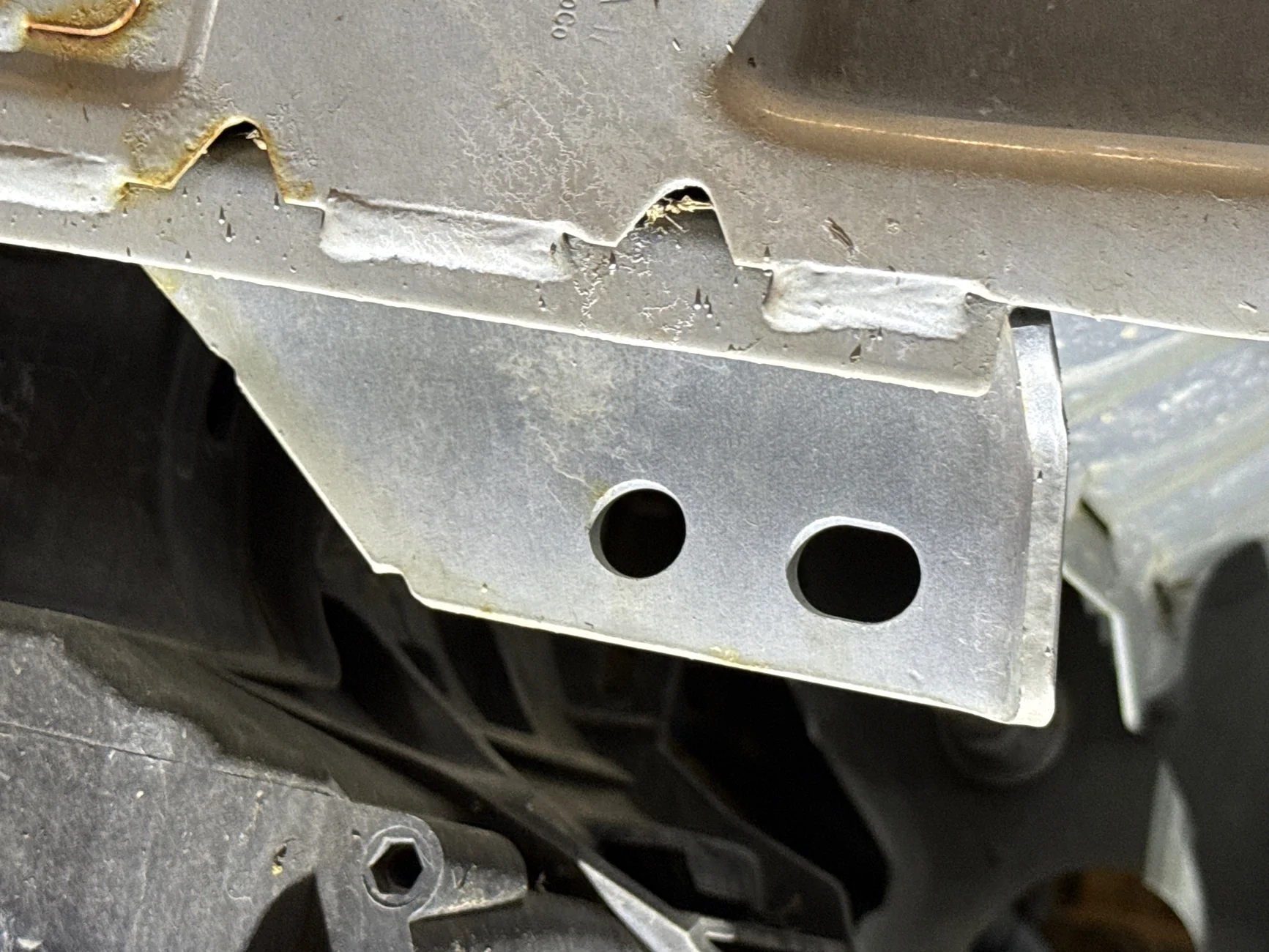

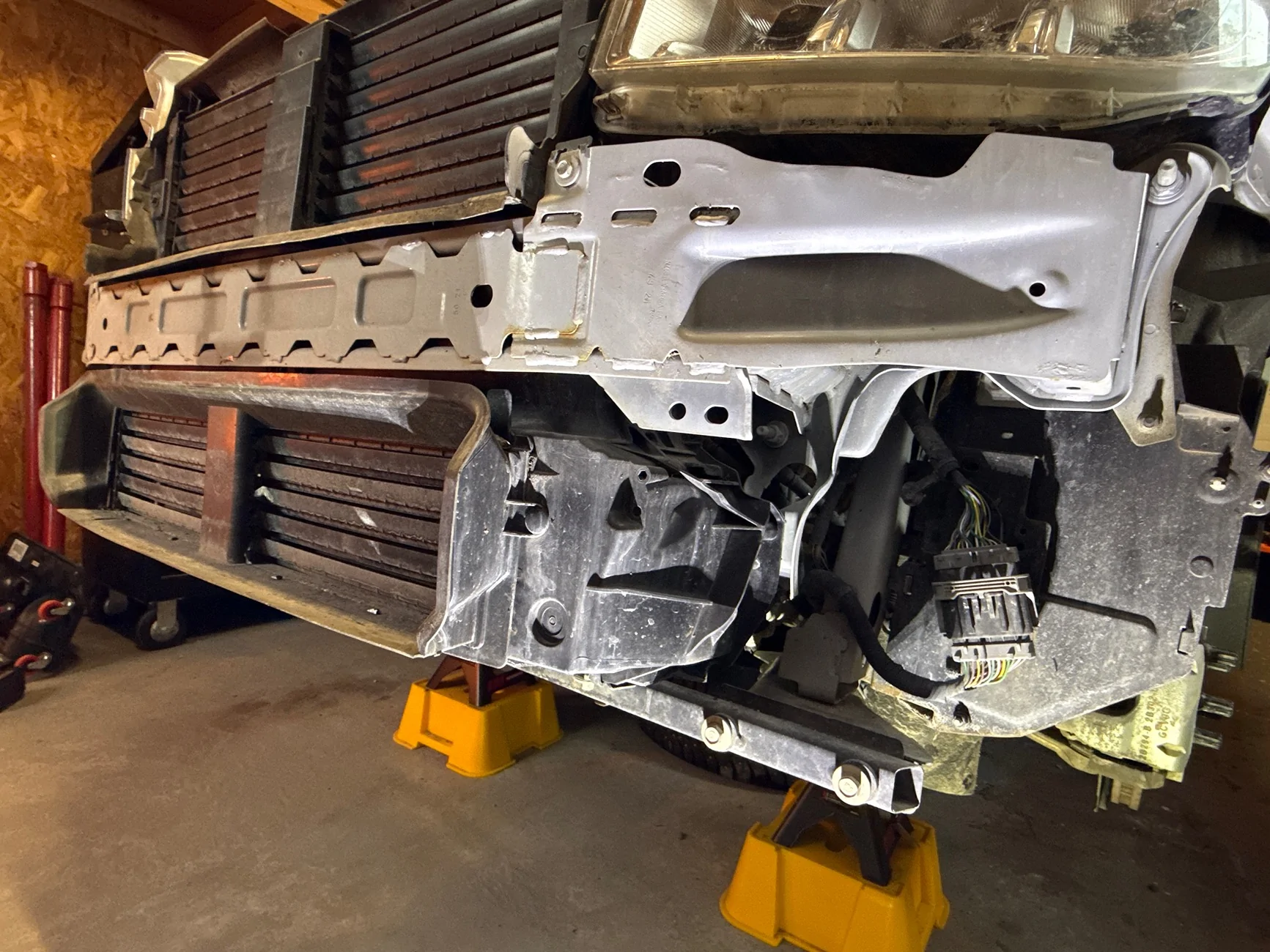

Anyone know what kind of rating this little bracket has?
Seems beefy enough to mount a lighter weight hitch - like a class 1 or 2 … enough for just a winch.
(2022 Maverick XLT Ecoboost)
Included wider and zoomed-in shot.
Yes.
That's for holding aftermarket fog lamps.
Hope that helps!
I'm gonna guess that it isn't a whole lot. Those holes are used to support the FX4 tow hooks, but the tow hooks themselves thread into bungs that are welded into the unibody rails.
I'd use the Demco base plate as a base for fabricating a front hitch, or even just buying one and modifying it. But at $800+ for the base plate, I think that money would be better spent on other things than a cobbled-together tow hook or hitch receiver setup.
https://www.mavericktruckclub.com/forum/threads/demco-base-plate-for-2025-maverick-xlt.64288/
https://cdn.demco-products.com/documents/Manuals/TP29366.pdf
I'm no engineer, but I'm assuming the tow hook attachment is designed more for forward load rather than a downward load that a heavy winch would create. I don't have tow hooks on my hybrid, so I'm speaking off the cuff.
