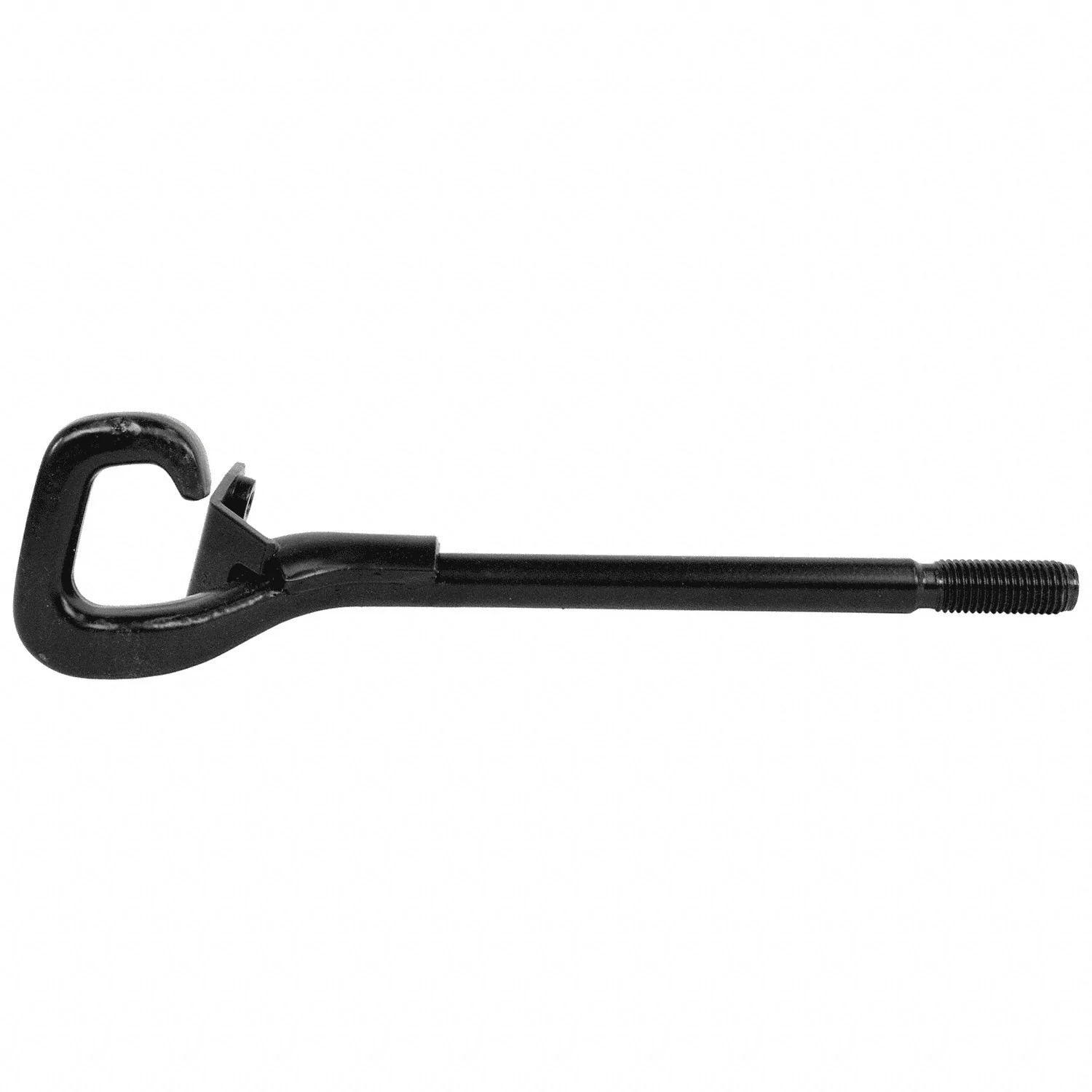

Check for threaded holes on the chassis, behind the bumper ... then buy from a different supplier, at a lower price, the equivalent to the tow hooks shown below [straight from the Ford's Part Department Website] - drill a slightly larger hole than the diameter of the hook on the bumper to feed these through - and bolt them on. Probably will look better than what's shown on the Lariat.
$176.00 Left Hand [LH] Maverick 2022-, Front Tow Hooks - Alternate Design
$176.00 Right Hand [RH] Maverick 2022-, Front Tow Hooks - Alternate Design

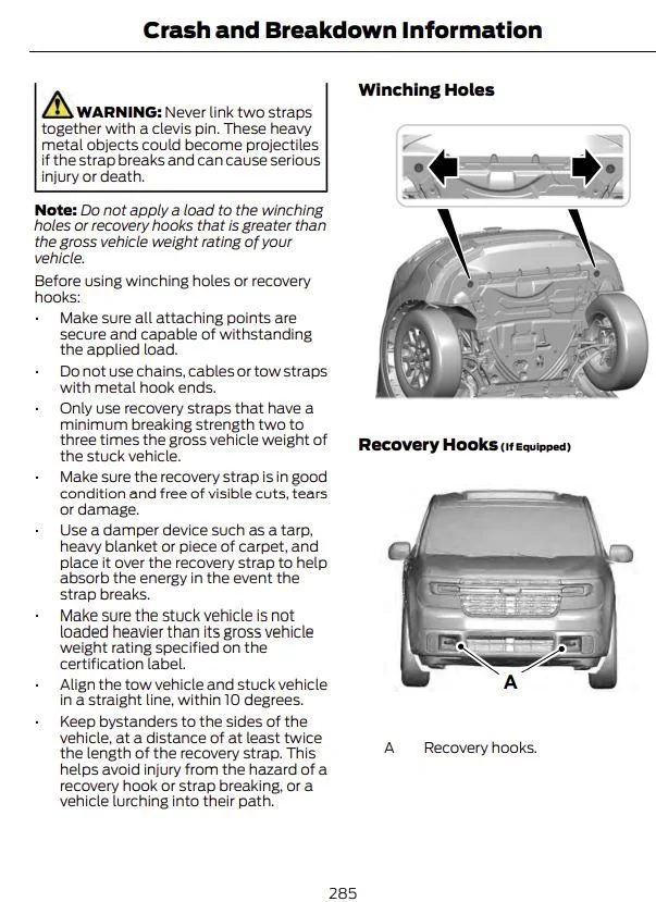

2. You're stuck off the road with the FRONT of the truck being the best recovery point. In that case, without front tow hooks (actually recovery hooks), from the owners manual (page 284-285) there may be a work-around.
Ford Maverick Does anyone else want front tow hooks on their Maverick? car-stuck-in-snow1
Ford calls them winching holes (page 285), I have no idea if they're just holes in the unibody frame that you're supposed to attach hook-type straps to, or if there's a threaded portion. I'm guessing probably just holes - somebody at the next Maverick in-person review needs to crawl up under the front end and verify what the heck is really going on there.

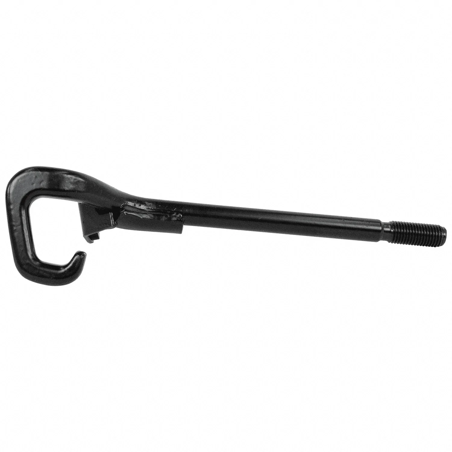

This is located at accessories.ford as an alternative mentioned earlier.
Same Shackle (not Curt branded) available at Amazon for $19.99 a pair - multiple colors
