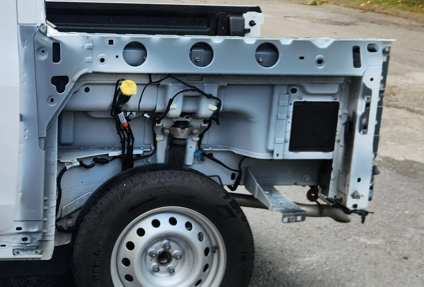

Working on Mavie 2 today - another employee wreck. Video coming soon. I can verify that it is 100% bolt on and no spot welds. Hey I'm going glass half full lol. Thought everyone would enjoy seeing the skeleton on the rear of the Maverick. My warped mind also thought it wouldn't be that hard to produce some bolt on panels that turned it into a step side 🙄
What does the backside of the fender look like?
It looked just like the exposed metal under the quarter panel. Both are coated in I assume zinc based / anti corrosion primer. Evidently it works pretty well as there isnt any evidence of rust anywhere underneath. Ill add a shot in the video for you of the back of the fender :)

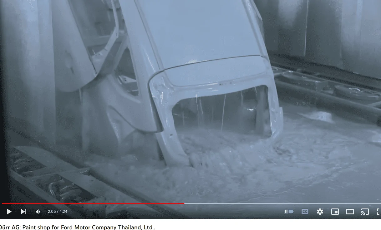

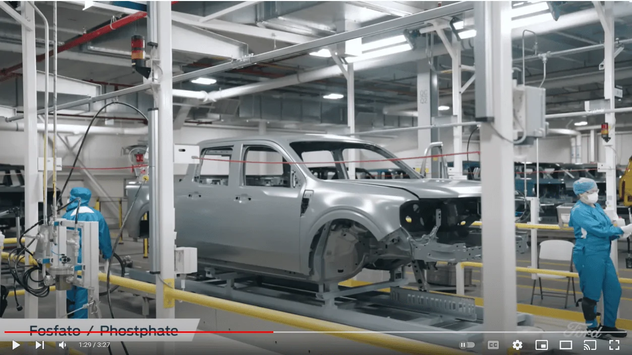

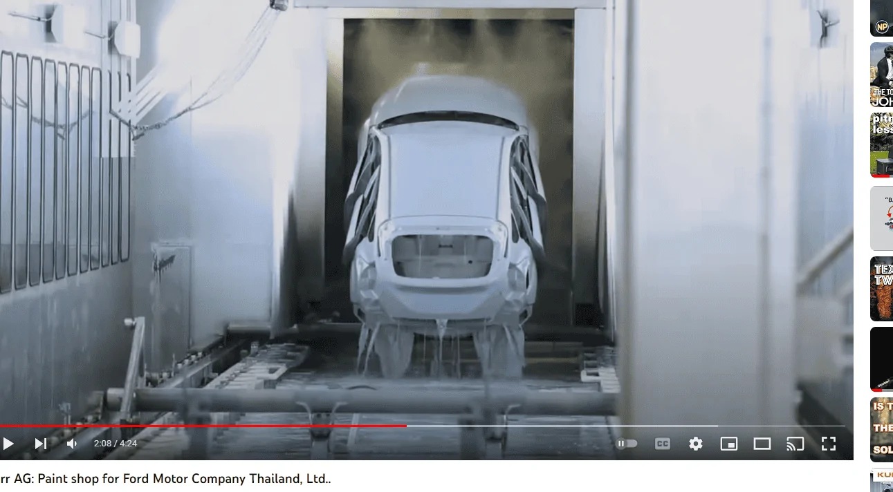

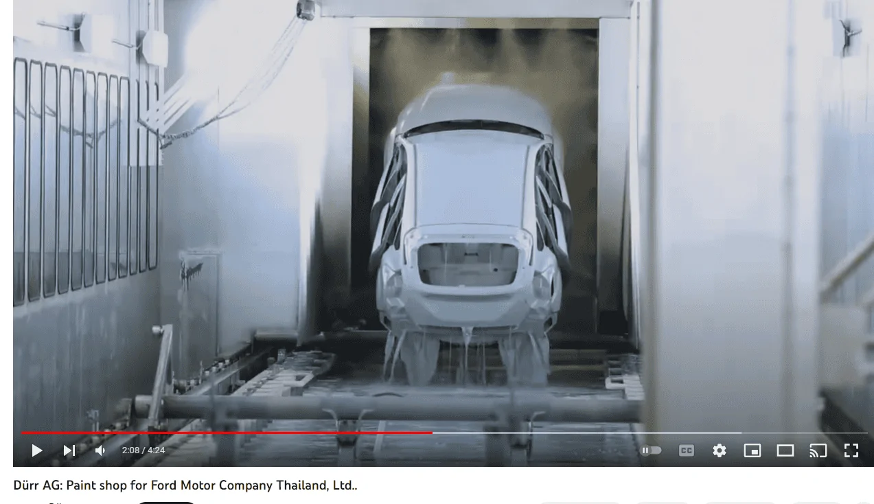

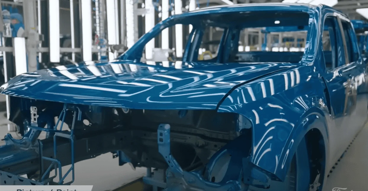

As a side note - From Bruce W 's question, I wondered about the coating. There was a video about the Hermosillo plant and assembly - it shows some of the painting process however the system made by Durr actually coats the entire vehicle with a phosphate primer coating by dunking the whole thing in a huge vat of paint thus covering every surface. Almost identical to their operation in Thailand -
Ford Maverick DIY Quarter Panel Replacement - So Fun Screenshot 2023-09-10 100002
After that drains, goes thru an oven it is ready for robotic painting.
Ford Maverick DIY Quarter Panel Replacement - So Fun Screenshot 2023-09-10 095504
Ford Maverick DIY Quarter Panel Replacement - So Fun Screenshot 2023-09-10 113250

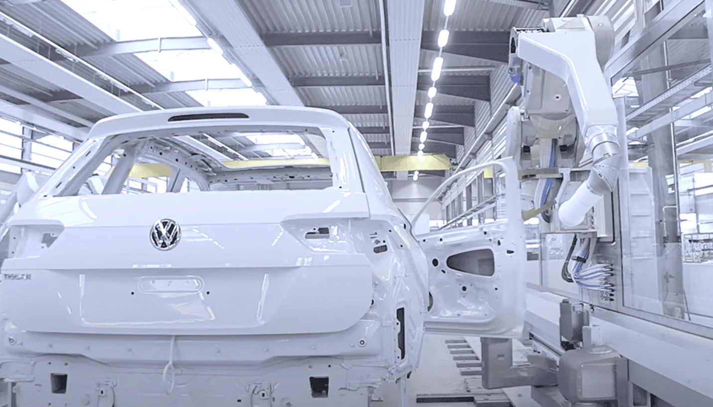

Yes, the robot will actually open the doors and hood to paint the interior as it moves thru the booth. The tailgate is painted separately on a jig rear of the truck. .
The robotic painting is electrostatic and the paint actually is "attracted" to the truck using a ground thus it flows into areas like the door jams.
Ford Maverick DIY Quarter Panel Replacement - So Fun Screenshot 2023-09-10 100640
From my photo you can tell that the white area are really areas of overspray on the phosphate undercoating done by the robots.
Ford Maverick DIY Quarter Panel Replacement - So Fun rear
So the answer to - what does the back of the fender look like - is it looks just like the rest of the unpainted areas as the complete truck is dipped in the primer tank covering every surface before painting :)
