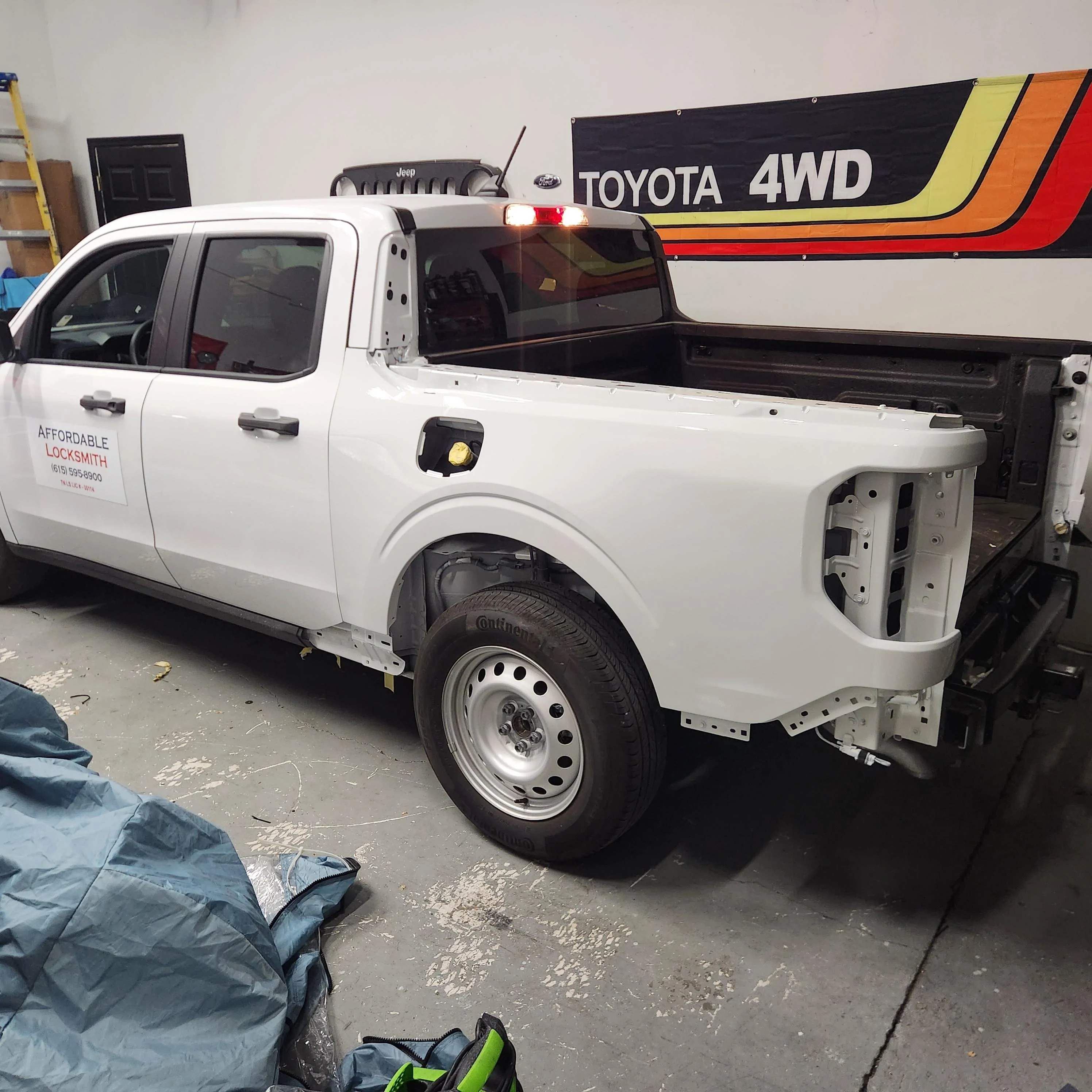

So that's the key to it.
So the Replacement is bolt on? I figured this was possible if buying new replacement. Eventually these may be sold painted. The factory has at least one spot weld. Seen on a YouTube video and confirmed at the junk yard were the replacement panel I found had paint loss due to needing to heat to remove the weld.
Well on the 2023 that I JUST REMOVED the quarter panel there was NO spot welds - possibly earlier production did however there was zero on this truck. Even in the factory manual it showed some welds - none of the welds were where it wouldn't be covered by trim or bumper cover tho.
That is great. Glad that this was worked out in production. I had looked into this because someone creased the quarter panel on my then almost brand new 2023 hybrid. I ended up having the minor body work and repaint done…. 1.2K later. Thanks for posting on this.

even if your truck has a few spot welds they are easy to drill out with a spot weld drill bit. if needed a few rivnuts will get you back together cheap.

I'm painting tonight lol

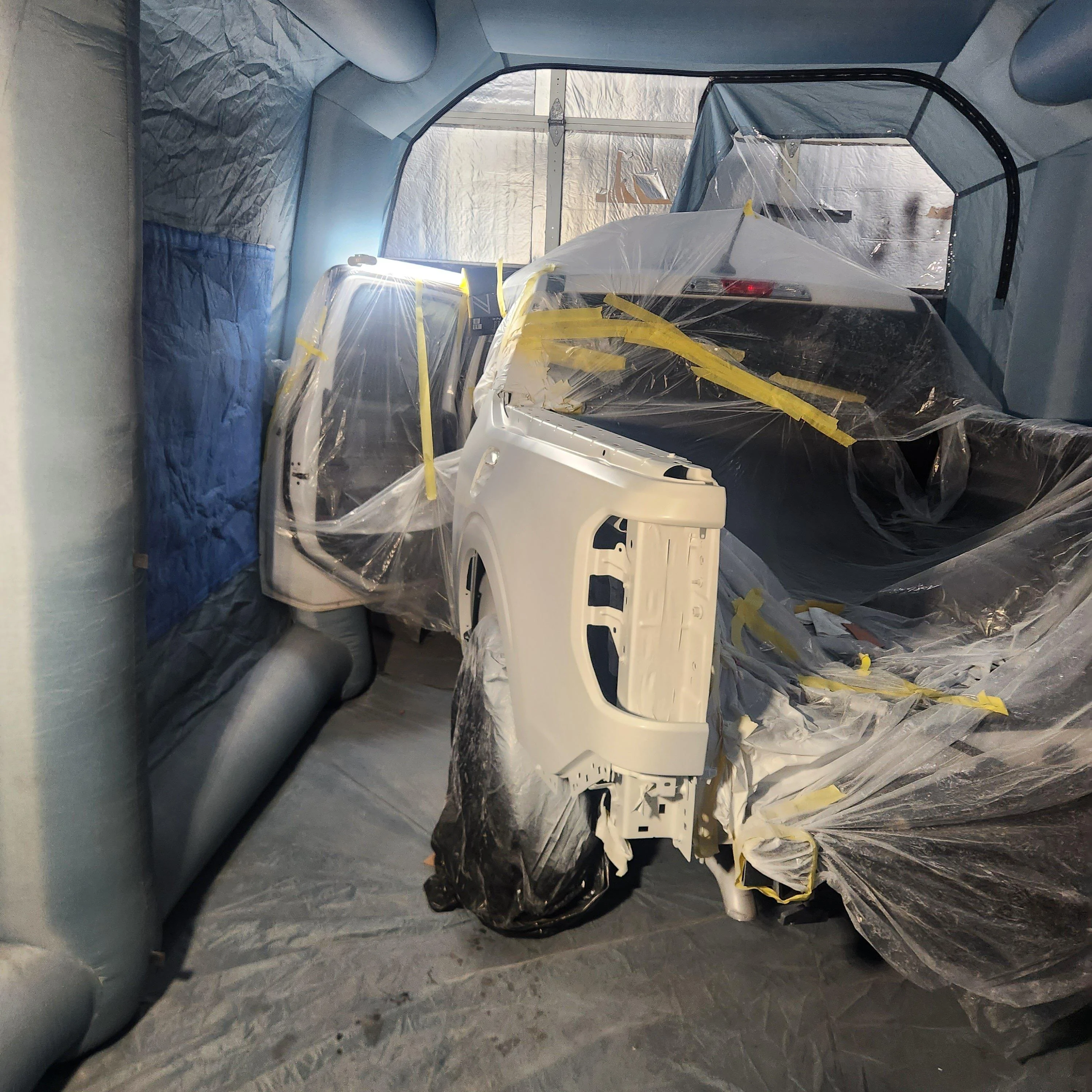

Well late nite at the shop - painted and clear coated few days cure then buff. Whew. Video coming soon 😁
