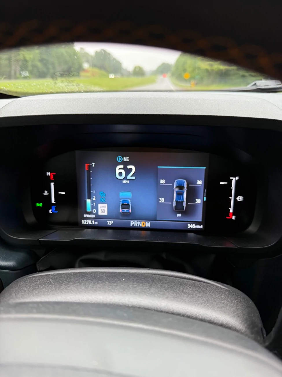

Someone said it could no longer be done
I did it, easy peasy
Ford Maverick Displaying tire pressure while driving IMG_2731

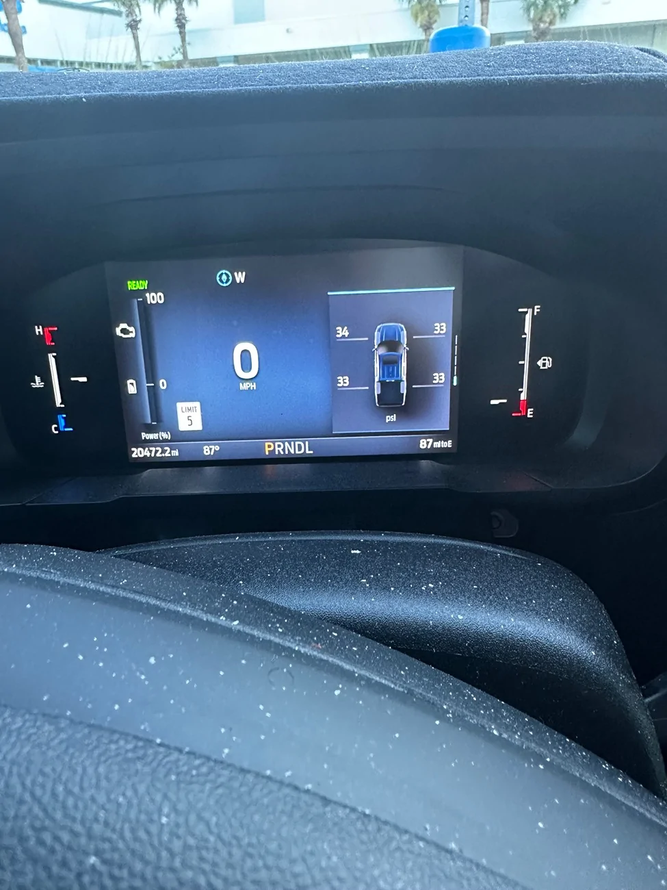

I believe that ability was disabled after an update. But if it makes you feel better, the light will still come on if the pressure drops while you're driving. I know because I picked up a screw. And the light came on after I'd been driving about 5 minutes.

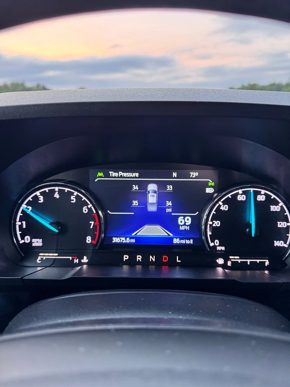

I can get it to show up by going into the menu and selecting it, and it will display while driving. However, the next time I start the vehicle it will not be in the "rotation" with Trip/MPG etc. I'd have to manually select it from the menu again.
^ THIS ^. I have a 2025. One of my main and only frustrations with my truck is the inability to retain the "My View" settings. I have certain checkboxes checked on the menu, and it just will not retain the settings and display correctly.
I want to check tire pressure every time before I get too far from the house. And I can't get rid of the "Fuel Economy" screen which shows the cumulative mileage which is not relevant. I assure you that "Tire Pressure" is checked on the "My View" config menu and "Fuel Economy" is not.
So I have learned to do this almost every time I begin a trip: I toggle some buttons on the RH side of the steering wheel:
1) Press the "hamburger" button (3 horiz lines) to go to the Menu
2) On the Menu press "OK" to select "My View" on the top line
3) On the “My View” screen it will go to "Configure My View” on the top line. Toggle up once to “Tire Pressure” which is at the bottom of that list
4) Press "OK" to select "Tire Pressure" while still on the “My View” screen
That’s it. 4 clicks. It will go to Tire Pressure. For some reason it deletes the "Fuel Economy" screen from the rotation and adds "Tire Pressure", and keeps the other screens in the rotation as is, which are the ones I want.
But the next time I start the vehicle it will revert back to the previous rotation with Fuel Economy in and Tire Pressure out. It makes me want to smash something, but I somehow control myself.
It's become so routine that it takes me just seconds and only 4 clicks. I have a base XLT and I have never had any issue with being unable to view the Tire Pressure, so all of this talk about OTA updates and other people's issues is crazy talk to me.
But I wish Ford would figure out an OTA update to fix this glitch and retain the settings as intended. I can't be the only one to complain about this. It's ridiculous!
