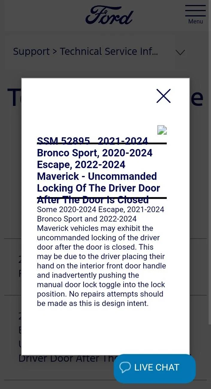

There isn't anything to disable/shutoff because Auto locking is not a feature. A glitch MAYBE Members here have looked with ForScan. There isn't any coding for AutoLock.
. Unfortunately until Ford can replicate it in their service department or someone can video it happening. It remains UNVERIFIED THUS UNFIXABLE.
So much so forward issued this SSM bulletin.
Ford Maverick Disable auto locking doors? 20240925_070002
The 2025 Maverick lariats will not automatically lock their doors after 75 minutes or 24 hours.

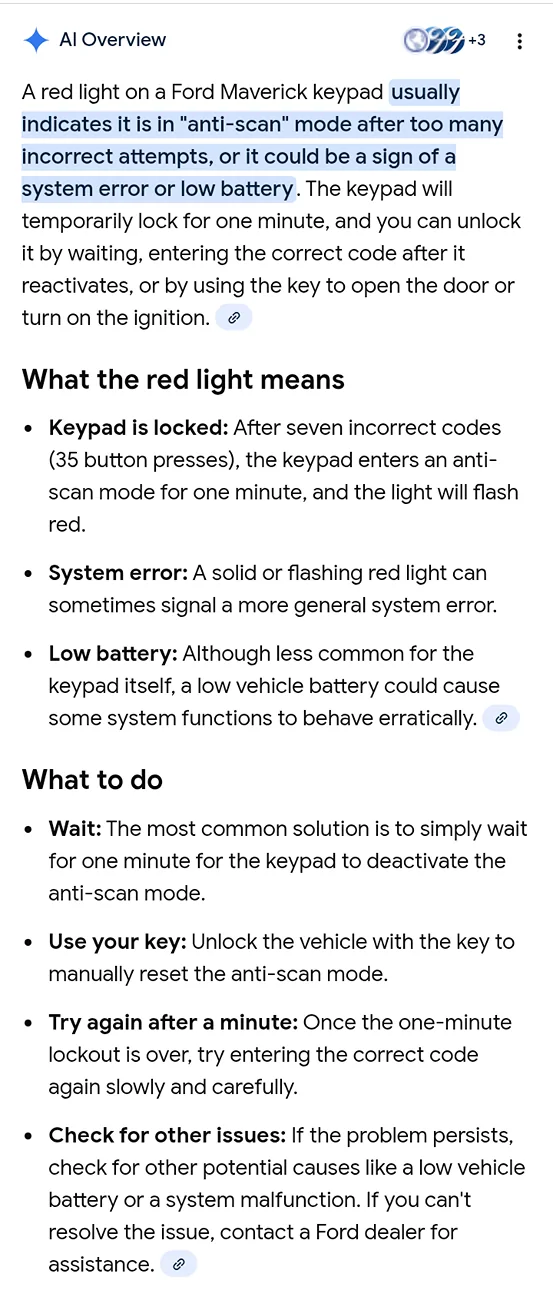

FYI may just be your 12v in battery save mode??

Thanks guys! I have a total of 3 fobs and the touch pad on the door. The touch pad is less than a year old and hasn’t been used very often. It also worked until the 3rd key fob was added, so I suspect the touch pad battery isn’t the problem.
Also, I don’t think “anti scan mode” is the issue. After entering the factory code it flashes a red dot in the upper right corner of the touch pad. Even after not being tried for several hours. I’ve unlocked the truck using the key too, without experiencing any improvement.
The truck doesn’t seem to have any evidence of battery issues, it’s less than 2 years old and has around 10k miles on it. I don’t think the truck is in battery save mode, I’ve been driving it daily for the last week (I’m on a 1500 mile trip in it).
I guess I will just take it to the dealership that installed the touch pad in February of this year and see if they can figure out how to fix it.
