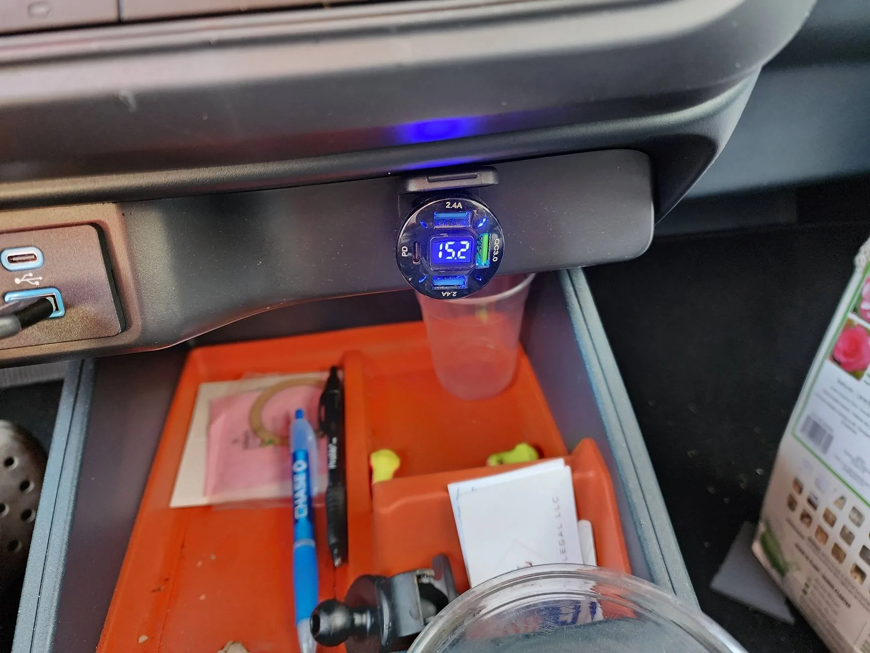

Seems this issue just doesn't get corrected so I will add my experience with my 2022 Maverick Hybrid concerning the battery issue. After close to a year after purchase, the first battery failed with the interior light syndrome. Everything else worked. I purchased a DIeHard battery ($225.00) which lasted around 9 months and then no interior lights started occurring again. Fortunately I took it back since it had a warranty and got a full refund. After reading so much here on this forum I purchased an AGM battery and installed it this past mid-December. So far so good but????? I also removed the Ford App from my phone and keep both remotes in a Faraday case when not in use and always do a double click which locks everything when the truck sits in the garage for an extended time. Oh yes I recharged the other batteries and checked the voltage many times. I always found as the battery starts to fail the sitting voltage is as low as 11.6 or 11.7 which is too low. I even purchased a device which plugs in the cigarette lighter socket which gives the voltage all the times and I quite accurate. When ever replacing the battery I also always reset the BMS. What is interesting is that when driving usually t
he voltage is around 15.1 and sometimes drops to 14.7 which is more normal for charging the battery than 15.1 So far when turning off the engine the battery reads 12.6-12.7 volts which is perfect. The BIG question is will this battery fail as the others did?? ...and yet I really like the Maverick, just sad so many recalls and also this battery issue.
After hearing about the charging issues I got a voltmeter for the cigarette lighter socket. Yeah, I know, not perfect but it gives me an idea if something is changing. For the last year it's been very steady and no issues.
Actually - the 12V system and the battery charging circuit are 2 different things.
While the voltage coming from the DCDC Conv has always been the same between them in the log files I've seen, the amps is totally different.
You can easily have 30A going to the 12V system, and somewhere between 0 and 1A going to the battery.
Usually by the time the Volts has dropped below 15 the battery amps has dropped below 5-6A level.
Closer the V gets to 14.7 or such, the closer the amps is to 1 or below.
Not exactly, but gives an idea.
The power adapter reading is great for seeing that Acc mode voltage 1st thing in the morning - see what direction the battery is going at least.
