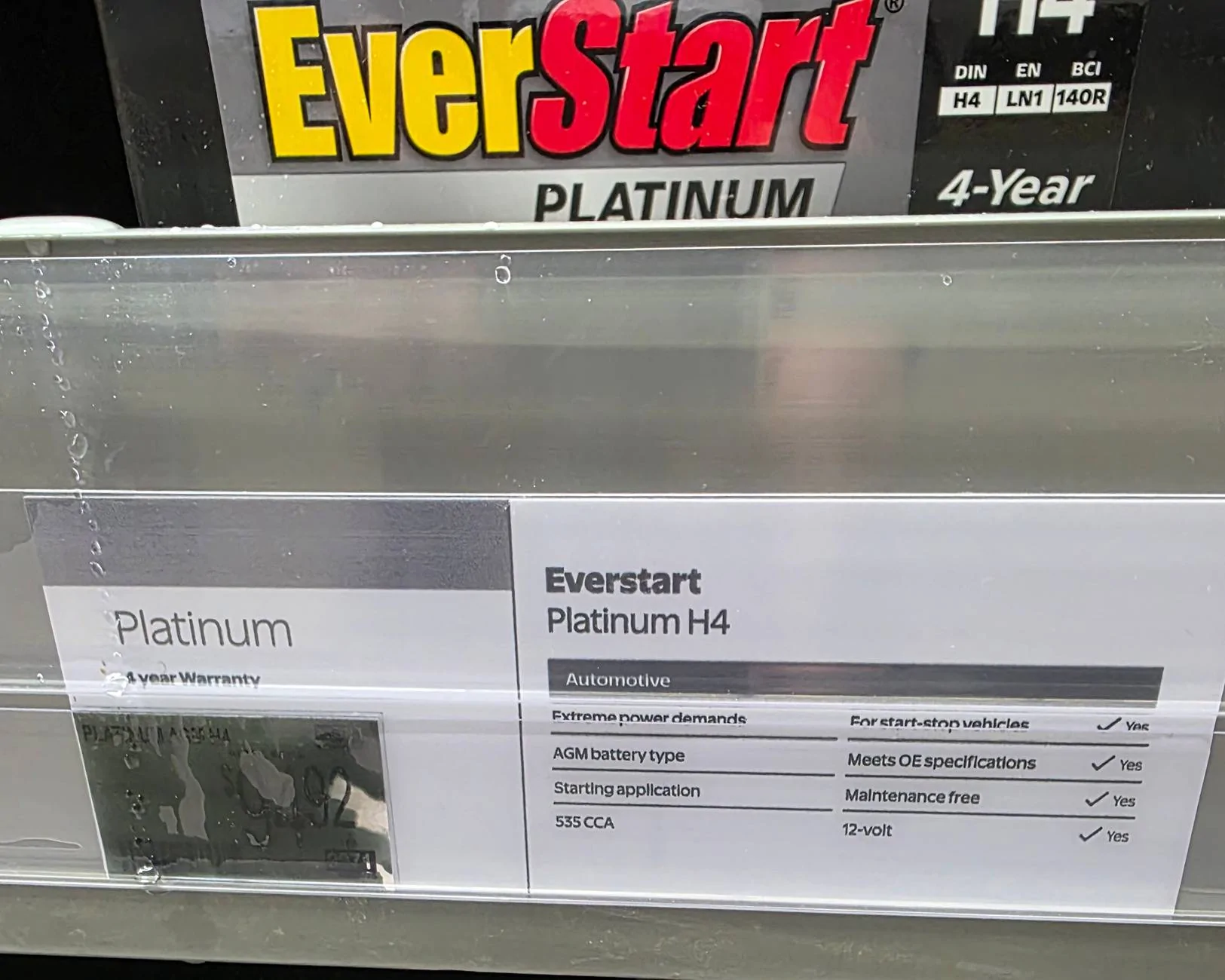

$94 @Walmart. Battery above it was leaking on it so I didn't buy..
Nice.
I haven't check recent tests - but the EverStart FLA series always seemed to get good reviews.
Need to see if their AGM series is just as good.
I like the ability to return it to any store that has a replacement, just in case you got a bad battery for whatever reason. Had that happen.
And dealing with a weak one for my mom in year 4 once, it wasn't dead yet, but the service desk guy went ahead and did a warranty replace on it. Pretty sure it was pro-rated at that point a tad, but still - didn't require it to be dead or almost like the dealers seem to be.
Now I just need to search around again, last summer none within a decent distance had them in stock.

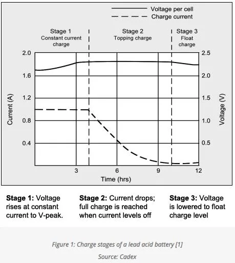

To the comment about the charging strategy - it's this graph, except in minutes basically instead of hours (actually not usually that many minutes).
So short drive, long drive, city drive, highway drive - doesn't matter on hybrid.
