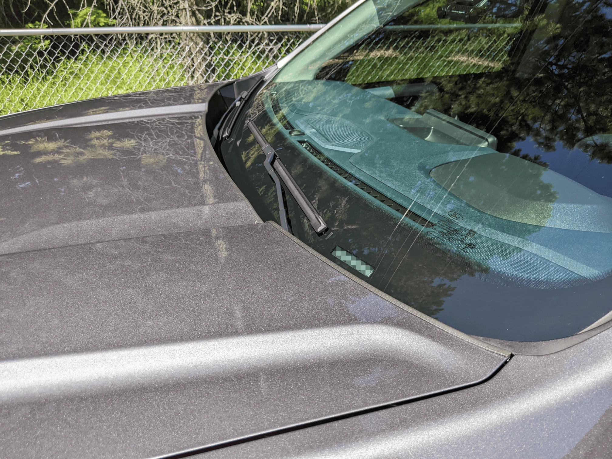

@scotty I hope I am not too late to the forum in which I just wanted to give my $0.02 if you do replace the wiper blade. Please watch youtube videos or there may be some posts on here showing how to correctly get the wiper arms up to replace the blades without chipping/damaging the hood.
I just randomly found a YT video quick to post on here (currently at work and dont have a bunch of free time). May not be the best instructions, but just wanted to make sure you dont end up chipping the paint as its not as simple as other vehicles may be.
Good post! Some forum members have put felt on the bottom of the wiper arm just in case it rubs on the hood at any time. Accidents happen.
Bought mine used it had signs of someone not being gentle in that area. Something I missed initially during inspection as I've never seen a hood and wiper area come in contact this way before, but I know to check now! Anyways, I put some of THIS around the edge of the hood to protect it as it was already scratched and chipped. Not the solution I wanted to use. I would have much prefered just lining the bottom of the wiper arms with some kind of padding, but it covers up the scuffs and does it's job. I did have to seal the areas with a touch up pen before I put it on.
