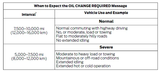

Ford's programming takes into account how "hard" the engine is working, and the service interval is automatically adjusted based on that. If you pull a trailer, drive a lot of mountains, or spend a lot of time idling, it reduces the oil change interval automatically. But regardless of how you drive, Ford states that the monitor will remind you to change the oil when a full year has elapsed since your last oil change.
I didn't know that, but had to verify it... :cautious:
https://www.ford.com/support/how-tos/search/Intelligent Oil-Life Monitor System/
