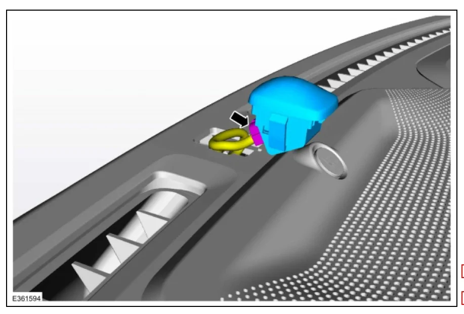

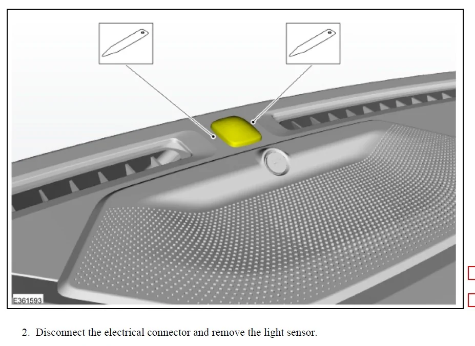

Never mind, I found this. Looks like the sensor is a 1-piece assembly.
Ford Maverick Day - Night light sensor replacement? Screenshot 2026-06-17 083355
Ford Maverick Day - Night light sensor replacement? Screenshot 2026-06-17 083329
