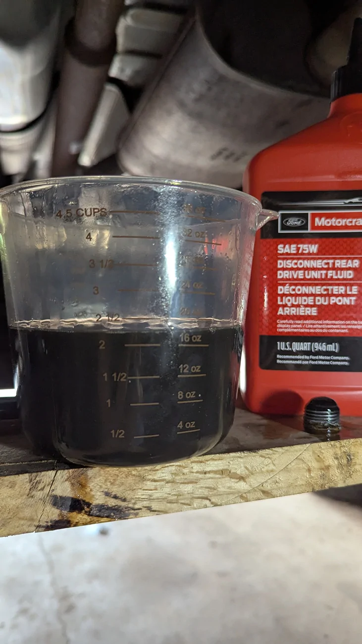

I guess my question is if the fluid is just low or if the unit is damaged. I can address the fluid. Replacing the part is beyond me.

Yes, the amount pictured was factory fill levels. Both were low. I changed the trans fluid too. If I were to do that again, I would just drain about 1/2 quart and refill. Fluid looked great and my only real concern for the trans would be the factory fill level.

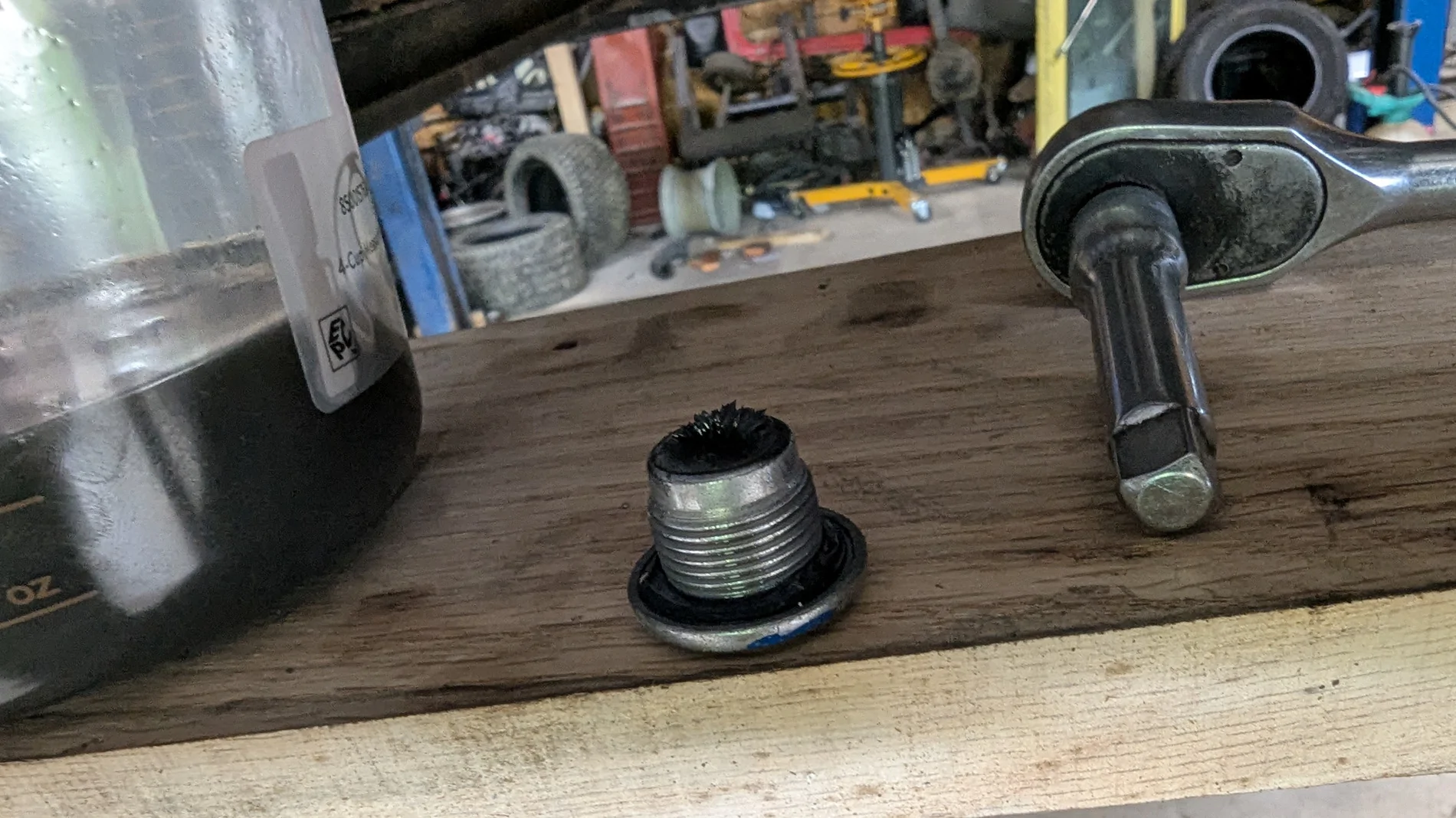

Can you tell us how much accumulation was on the eCVT drain plug?
Thanks!
Thanks!
I don't recall the eCVT transmission having a magnetic plug like the PTU and RDU. I could be wrong but found nothing concerning about the trans fluid other than being below the full level.
