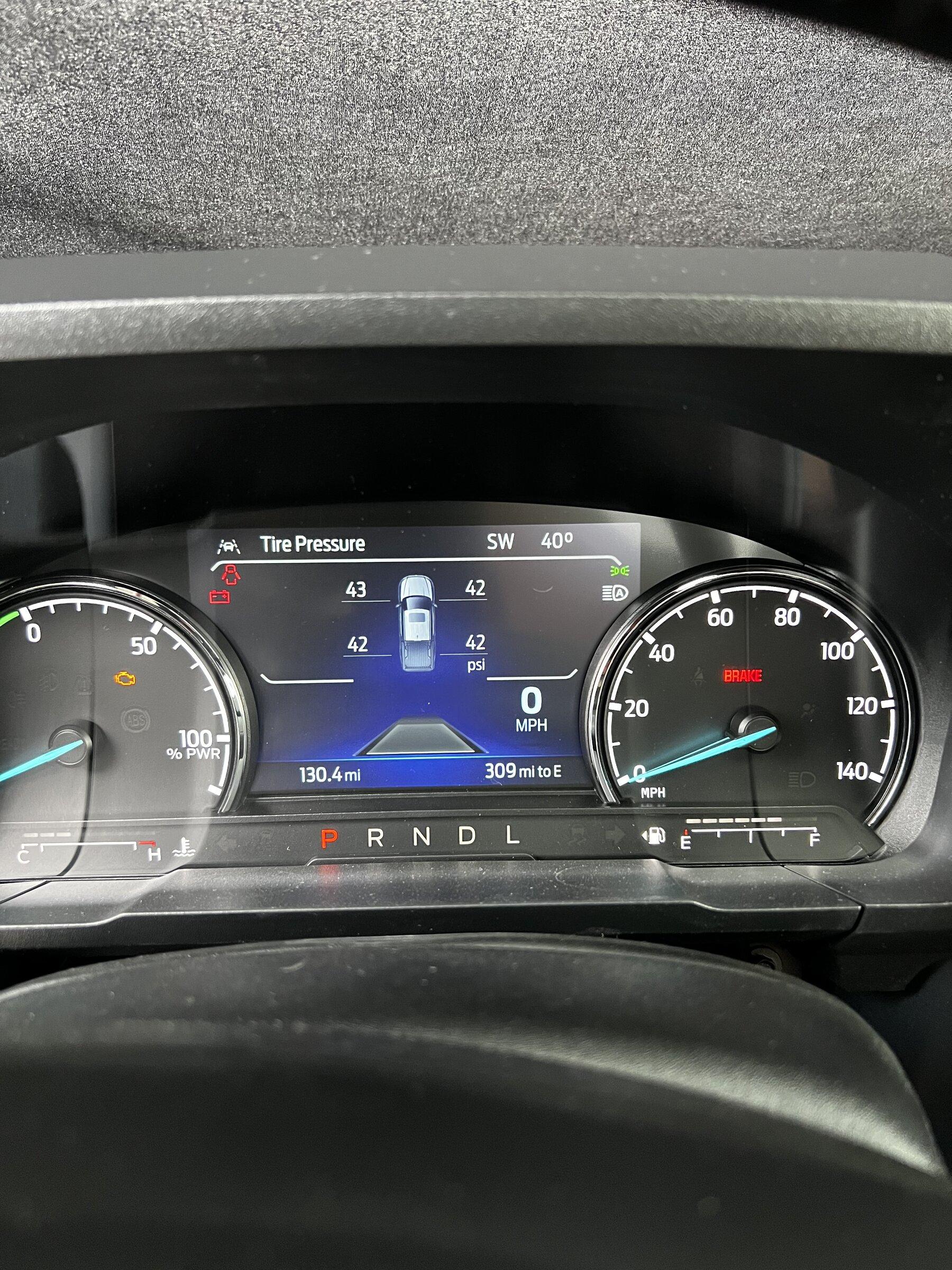

Got my maverick over the weekend and when I figured out the TPMS system it was at 42psi!!!! Door sticker says to be at 35psi.

My Sienna had 42psi (Supposed to be 36psi) as delivered too! As someone said above, that's how they're shipped. I can't argue about my dealer missing it since I literally bought it off the delivery trailer.

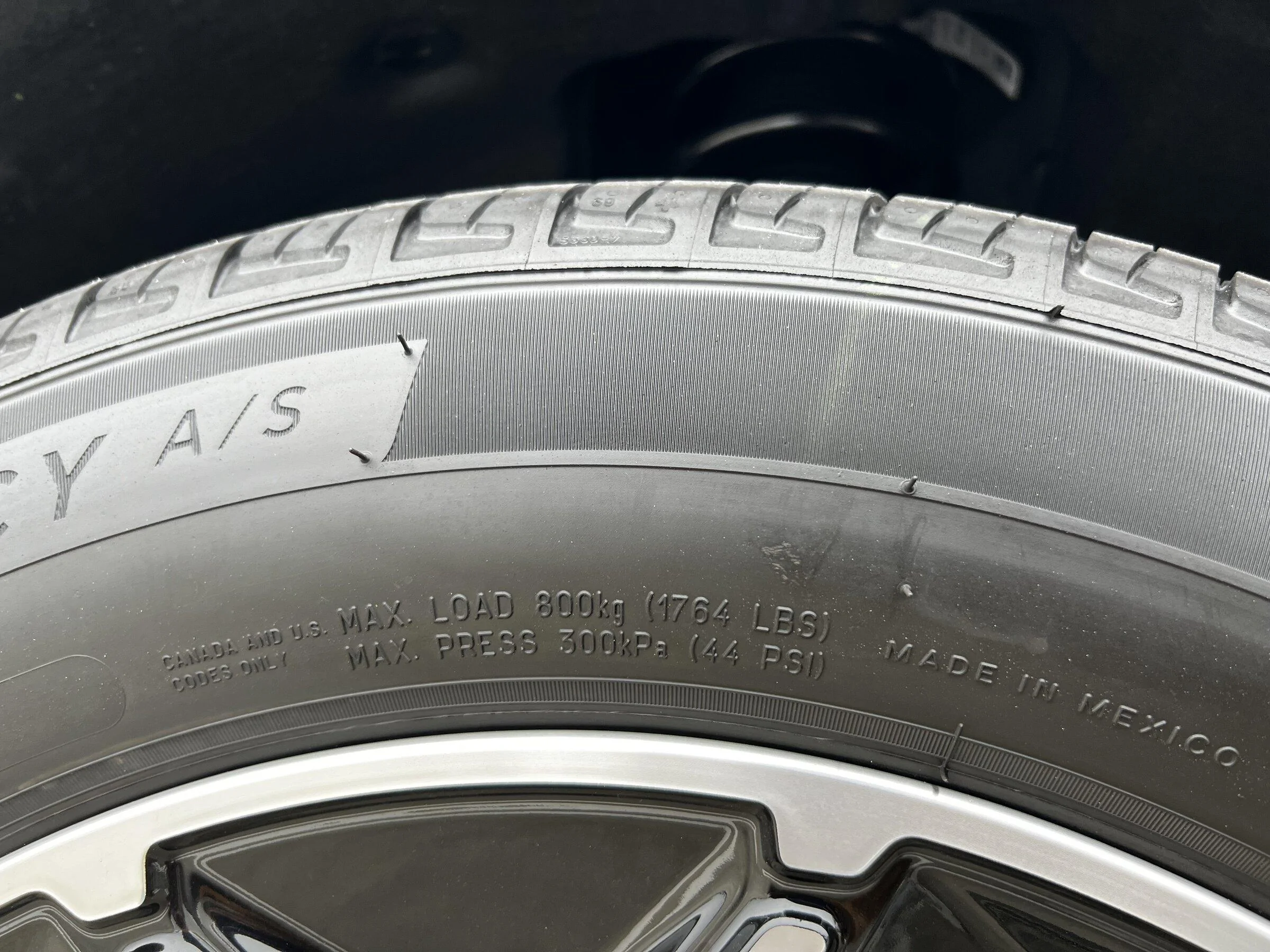

I thought the same thing until I looked at the max psi on the tire and it said 50 psi. I had the perelli with the fx4 package. Sounds like they met in the middle 😄

my XLT w/lux shows the individual temps as well. All 4 of my tires were different when I got the truck. LOL... the front license plate holder was also upside down.

Mine were in the 40s+ when I checked mine! 🤯🤯🤯🤯🤯
Max tire pressure for my Michelin is 45PSI
Don't go by whats on the tire. Go by whats on the drivers side door sticker which I do believe is 35 psi. cold. Also don't trust whats on the display. Buy a good tire gage.

The max pressure on the tire has nothing to do with the correct pressure. The pressure on the door jam (plus or minus 3 or 4 lbs, at your option) is the correct answer.
Just google for 2 minutes and you will see the truth.
