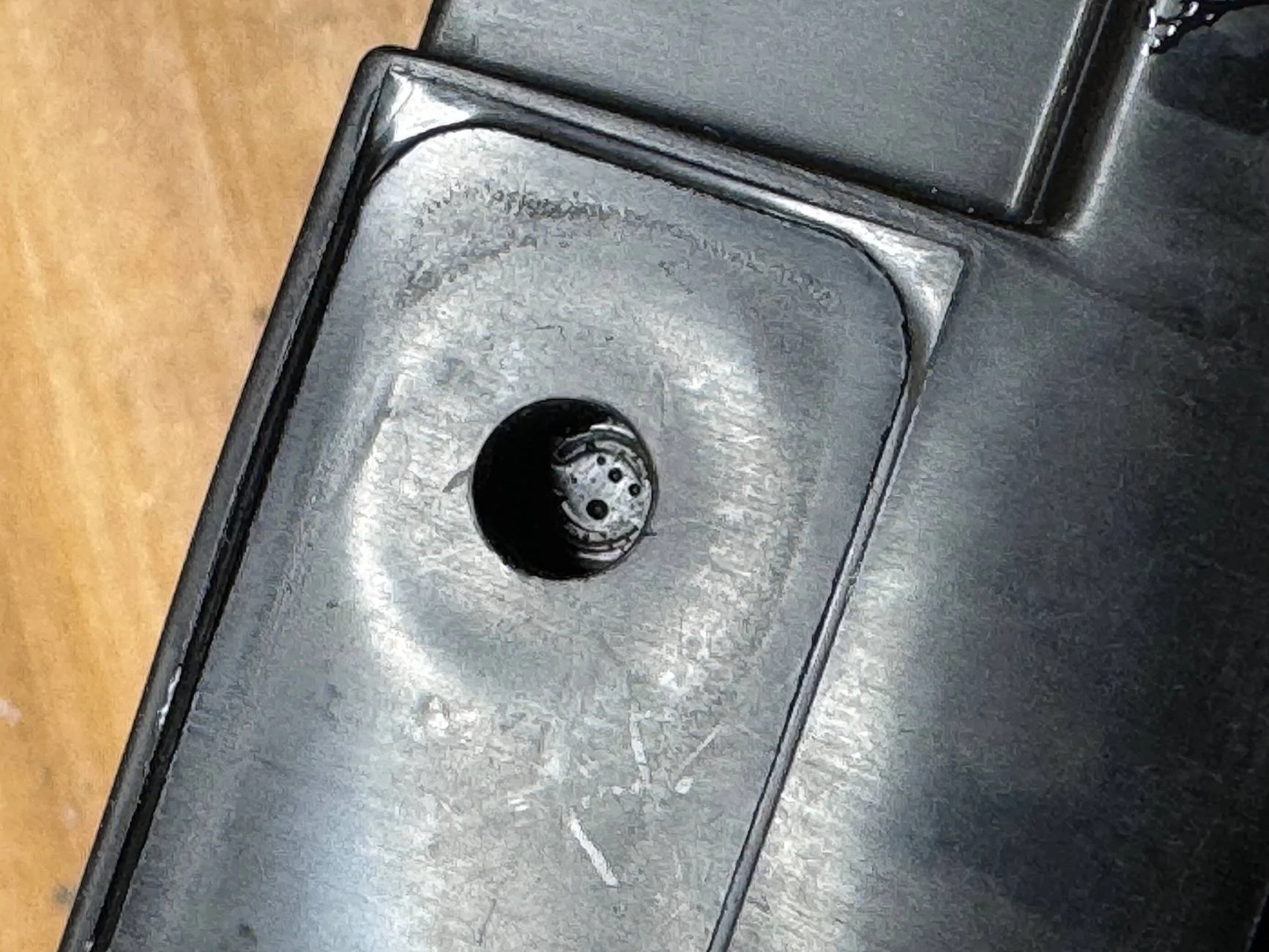

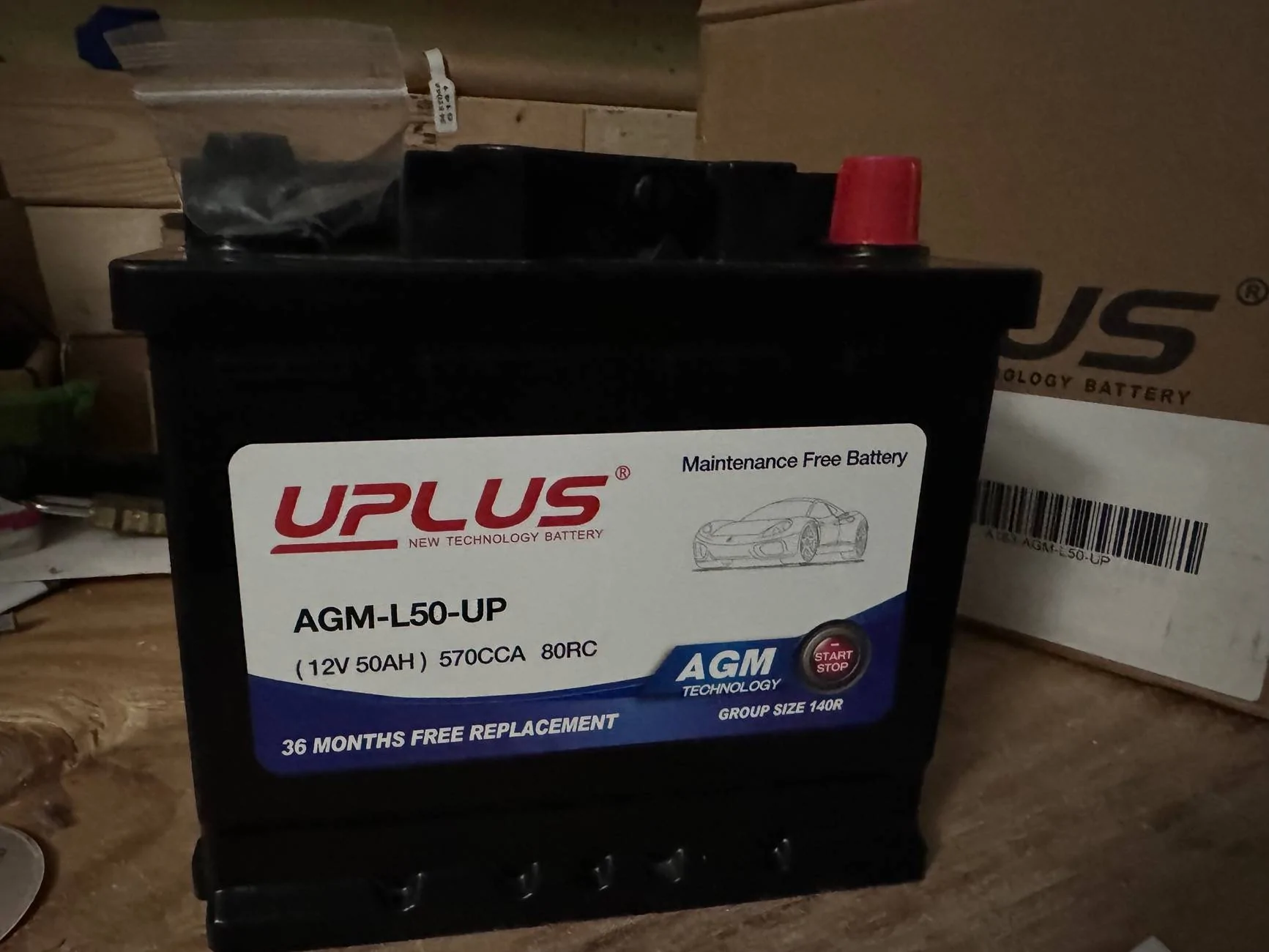

Both vent holes are sealed. The plug that comes with it is very tight fitting and has barbs on it. I didn't want to try to put the plug in since I was afraid I could not get it back out. Inside each hole are two little semi circle indentations. You can see them in the photos. But I shined a light in there and I see no open vent. It appears sealed. Maybe the semi circles are meant to bust open at a set pressure? It may be that the vent is a pressure release situation where it is sealed until needed.
This is EXACTLY how mine looks as well.

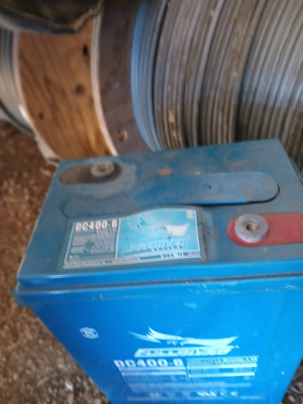

I have not seen the maverick hybrid up close and did not look at the agm in my Tremor when. I had it. The vents are shipped open, just like the flooded battery caps of years past. The top cap is to collect the gas and let it out one or both holes depending on manufacturer specs. Ford requires one vent to collect the hydrogen. Installation under hood can be installed without vent tube because there will not be enough ever to not be dissipated. You plug one vent with the tube and the other with the provided cap. If there are no vent holes the battery case is reinforced and should swell and not pop. (That's the reason sealed batteries should have 1" clearance all around.). Attached pic is of a popped 6 volt 400 AH $700 MSRP AGM weighing 123#.
It was one of eight wired for a 48 volt solar battery.

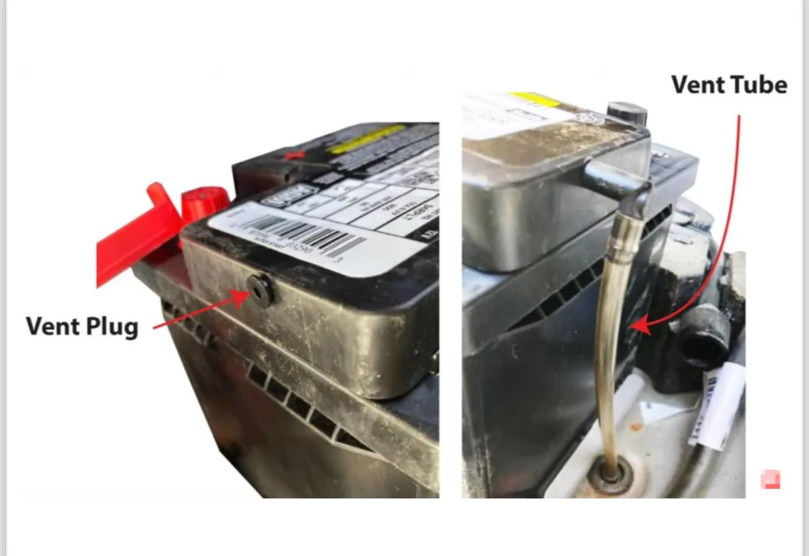

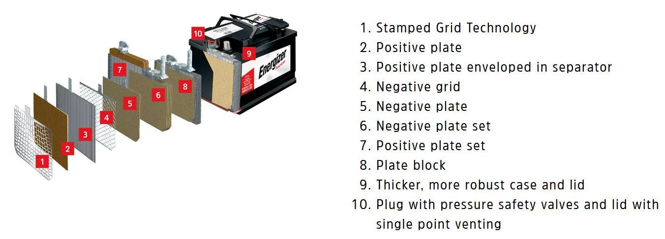

As for the End Vent Ports on the automotive AGM batteries, I couldn't find info on what the internal valve looks like how it connects to the central venting channel for the battery.
It does look like AGMs a sealed from outside air normally and use one way valve(s) to vent if pressure is more that 1.5 PSI inside the battery.
VRLA AGM AND GEL BATTERIES > How do VRLA batteries work?
A VRLA battery utilizes a one-way, pressure-relief valve system to achieve a “recombinant” technology. This means that the oxygen normally produced on the positive plate is absorbed by the negative plate. This suppresses the production of hydrogen at the negative plate. Water (H2O) is produced instead, retaining the moisture within the battery. It never needs watering, and should never be opened as this would expose the battery to excess oxygen from the air. In addition to damaging the battery, opening it also voids the warranty.
ACDelco Proper Installation of Battery Vent Plugs
AGM (Absorbed Glass Mat) and Flooded Lead Acid batteries can produce a number of potentially dangerous gases. For vehicle applications that have the battery installed inside the passenger compartment of a vehicle, it is imperative the battery be vented properly.
For those applications that have a single vent tube, the opposing vent opening on the battery cover must be plugged with the included vent hole plug.
Attached to batteries, that require venting, is a red terminal cover (pictured below) that has a removable vent plug for insertion into the vent hole that is opposite of the vent hose that leads to the outside of the vehicle. Instructions are included to advise of the proper assembly.
Technicians must:
A) Twist off the vent plug from the positive terminal cap.
B) Insert plug into the non-vent tube port.
C) A press fit should be used to properly secure the vent plug into the battery to ensure proper seating into the vent port.
D) Re-install battery and affix vent tube to the open vent port.
NEVER PLUG BOTH VENT PORTS

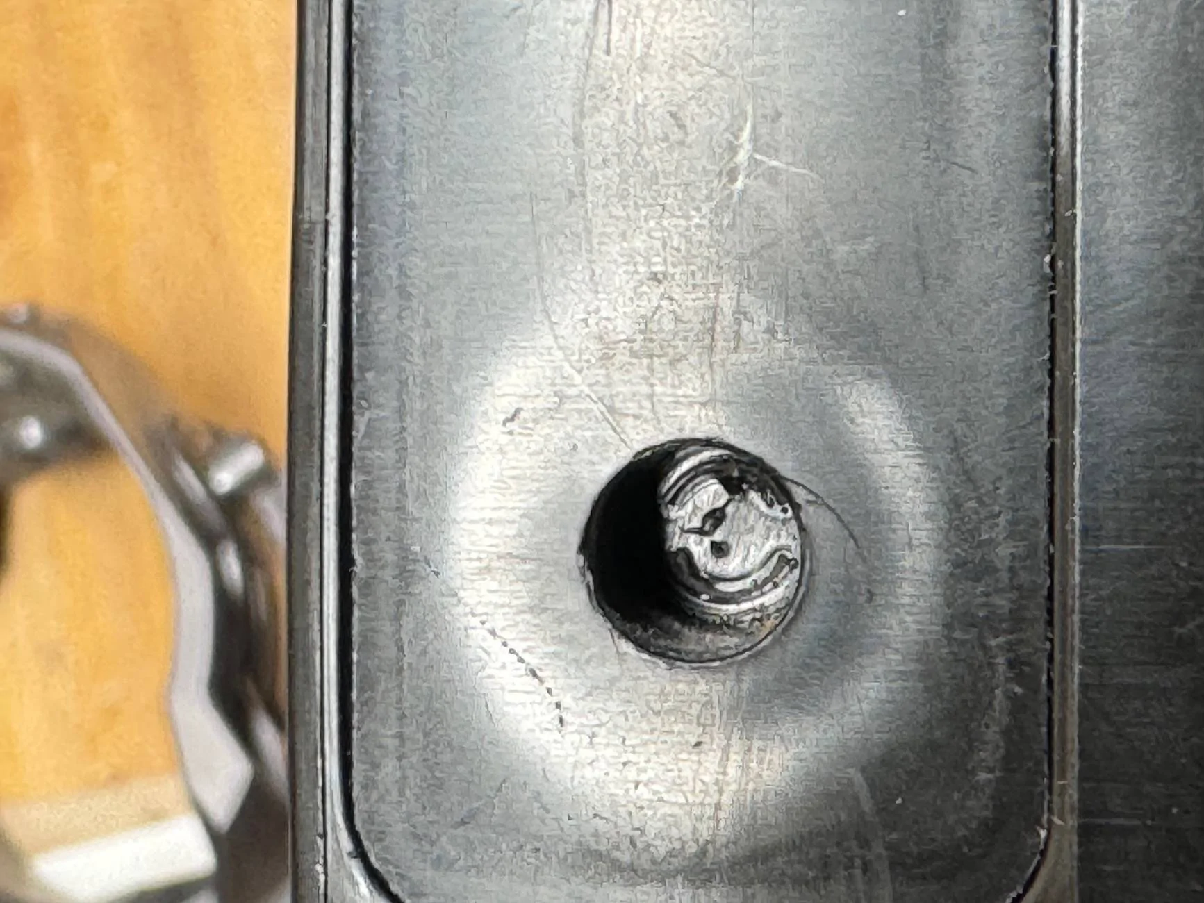

I had contacted the seller and here is their response.
Q: There are two (2) possible ports, one (1) on each side of the battery. Neither are open for venting. Are these supposed to be punched open? (Attached picture of the positive and negative ports previously attached in thread)
A: Your car battery, if it has a hose connection before. You can continue to use the Vent Plug. Please see the attached picture. Regards
Ford Maverick Changing to AGM IMG_7964
This is how my battery looks. Don’t mind the water drops in the port. Things got a little wet the other day.
Ford Maverick Changing to AGM IMG_7965
Ford Maverick Changing to AGM IMG_7963
Ford Maverick Changing to AGM IMG_7961

Installed the battery this morning. I had a vent plug in my plastic bag which I did not see until I took the bag off the battery.
Once the vent plug is in, it seems difficult to remove again. I used a mallet to tap it in fully.
I started to remove the plastic trim around the battery but was having some difficulty in getting the larger section out so I stopped and opted to replace without removing it.
It wasn’t difficult to do the swap but there are some tighter areas to work around. I haven’t done an in-vehicle battery before. Using a magnet pick up tool helped remove and locate the bracket and bracket bolt.
All equipment worked as it should after installation. Did the BSM reset after install. Battery came delivered at around 12.7 volts.

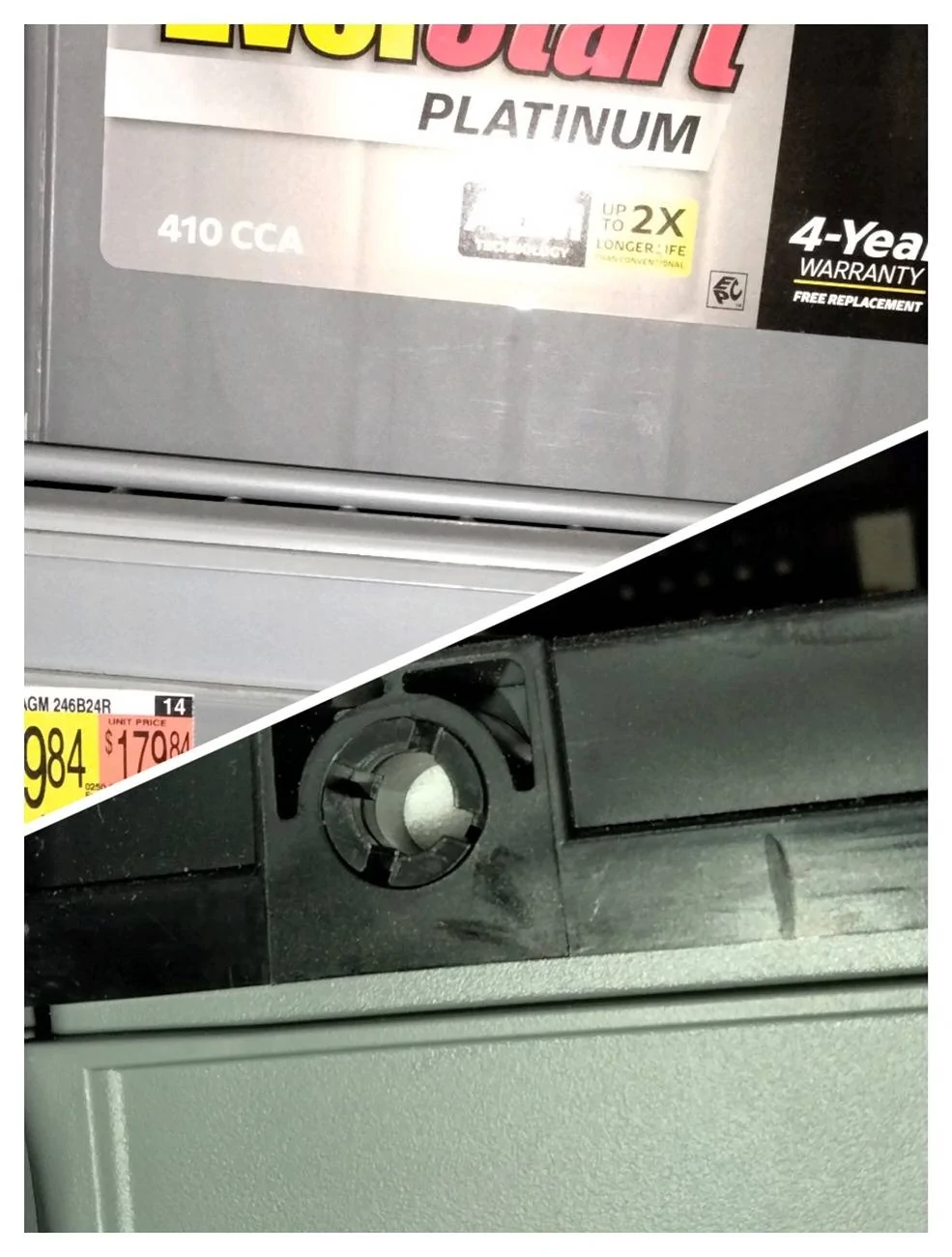

Considering three or four people have already replaced their flooded motorcraft batteries with agms bought online, and did not have any problems. I would have found it strange for you to be the odd one out where something was different and didn't work.
Here is a Everstart platinum AGM at Walmart with sealed vents.
No it is not a H4.
