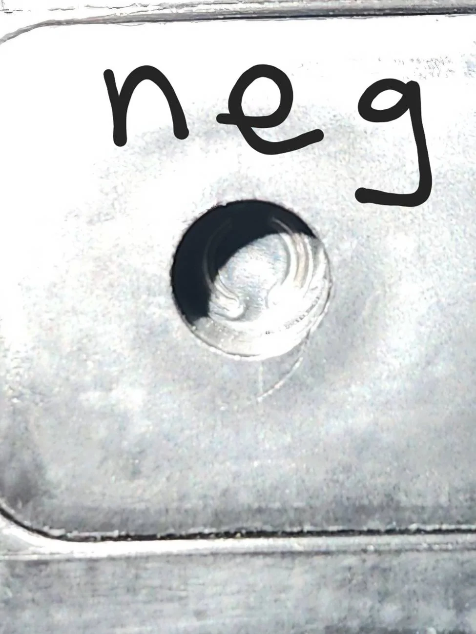

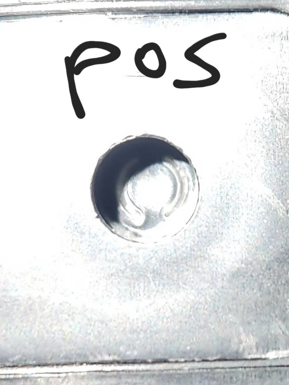

This is a stock image but is identical to what I have. I circled a “port” on the negative side. The positive side has the same “port”. Those ports are fully sealed and have not venting.

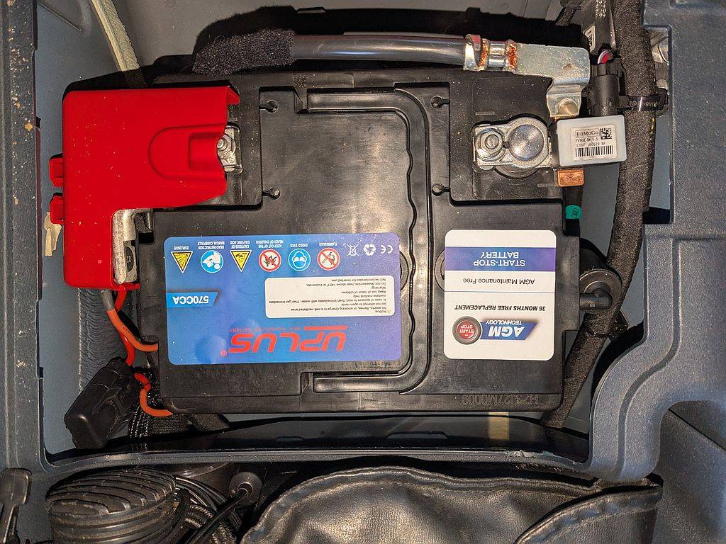

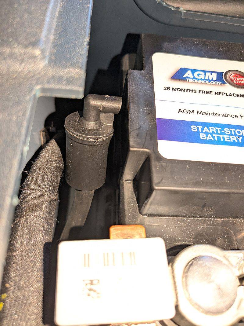

I took some pictures of the battery setup in my truck (it has been a while since I installed it!). The new battery has two vent ports, one on each side (like the original Ford battery), which both should be open to the battery interior. Note that there is likely only a tiny venting hole in there, so you may not be able to see it.
And to be honest: I didn't even look for a vent hole inside the ports assuming that the battery manufacturer would not have users have to punch holes in the case. Plus, there wouldn't be a need for a sealing plug on the opposite side then either.
So I simply pulled the hose with plastic L-connector from the old battery and plugged it into the port on new battery. Then I pulled the sealing plug from the old battery and put it in the port on the opposite side.
Battery has close to 20k miles on it now with zero issues, no random deep sleeps, all works as it should!
Pics attached below.
Cheers!
Cheers!

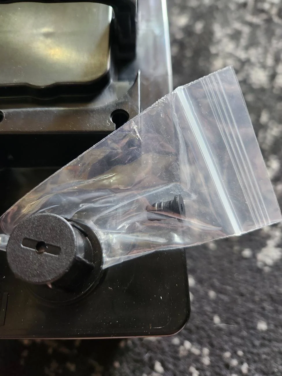

Both vent holes are sealed. The plug that comes with it is very tight fitting and has barbs on it. I didn't want to try to put the plug in since I was afraid I could not get it back out. Inside each hole are two little semi circle indentations. You can see them in the photos. But I shined a light in there and I see no open vent. It appears sealed. Maybe the semi circles are meant to bust open at a set pressure? It may be that the vent is a pressure release situation where it is sealed until needed.

Yep the battery is sealed for shipment.
