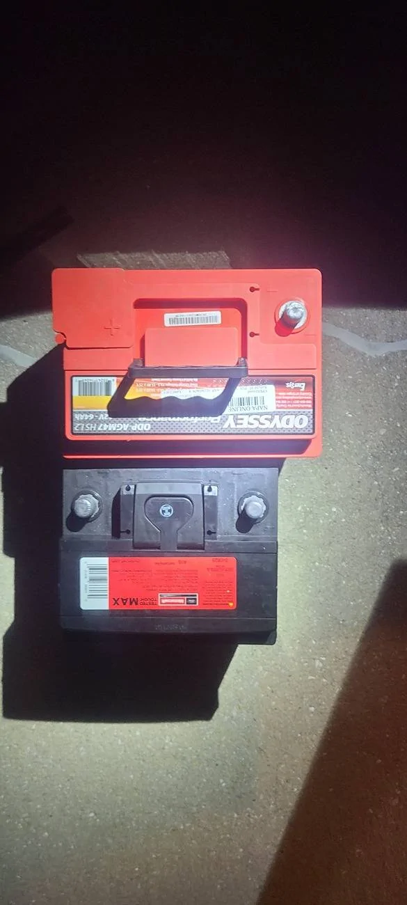

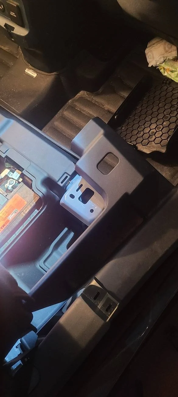

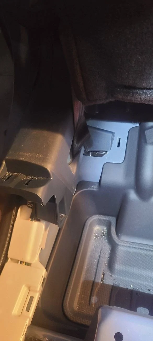

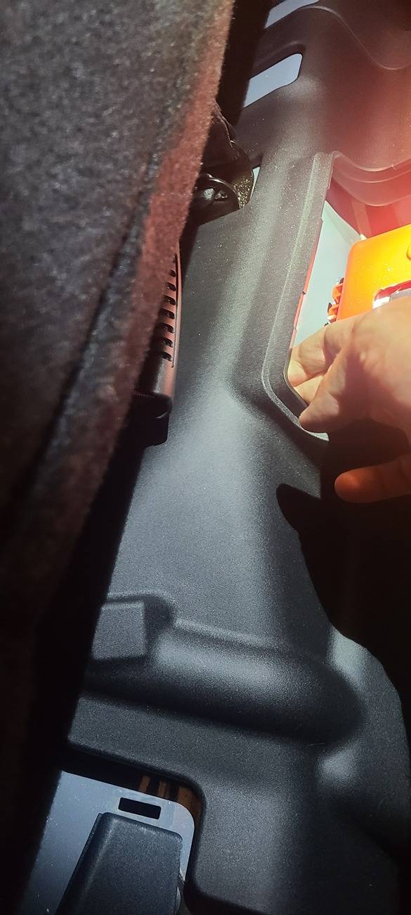

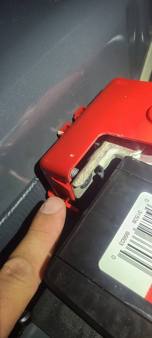

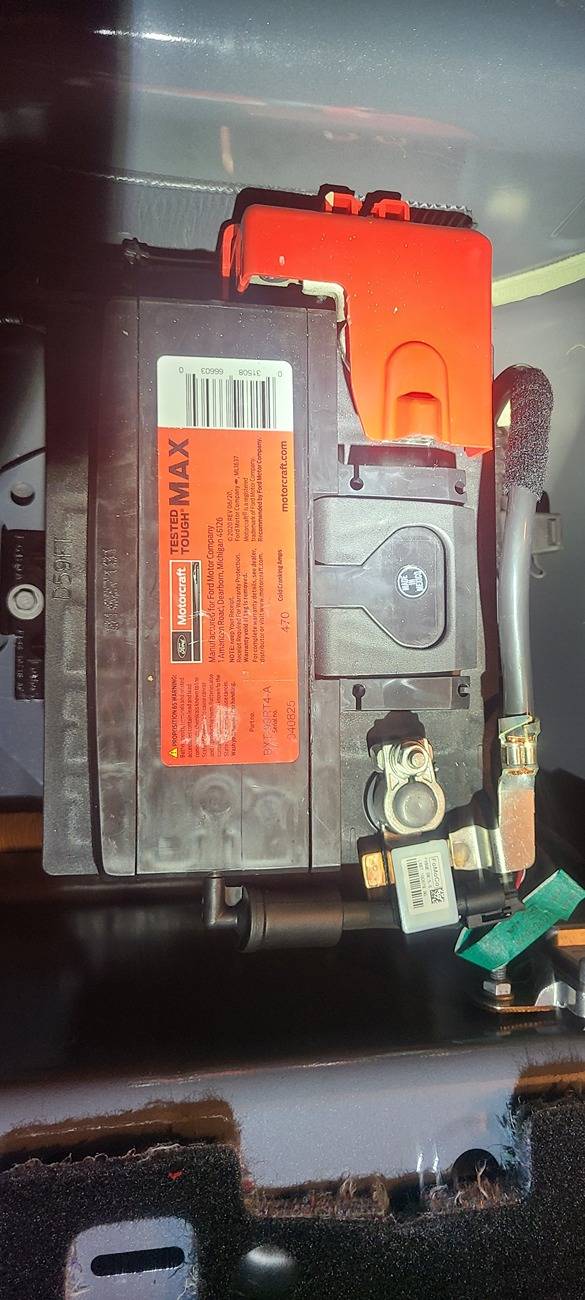

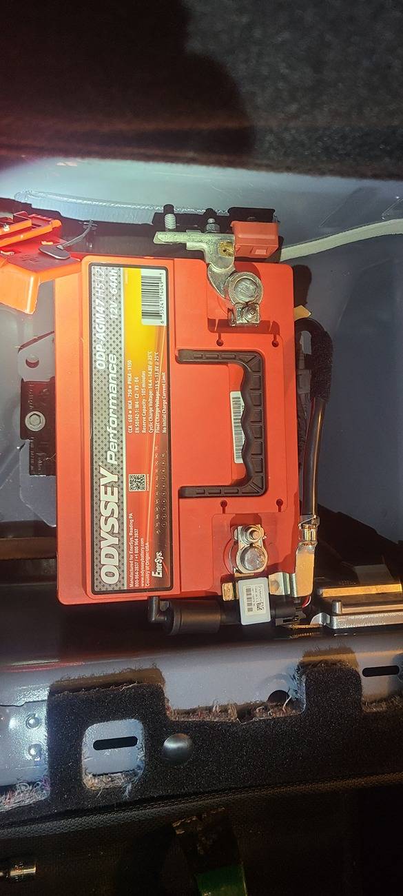

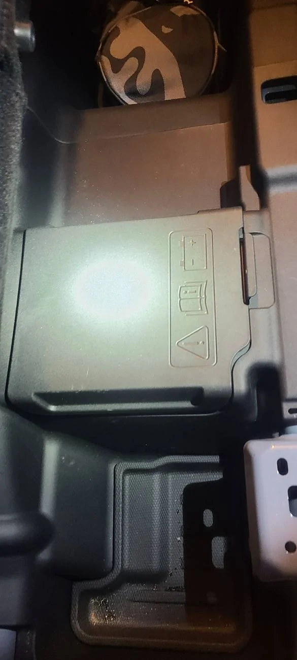

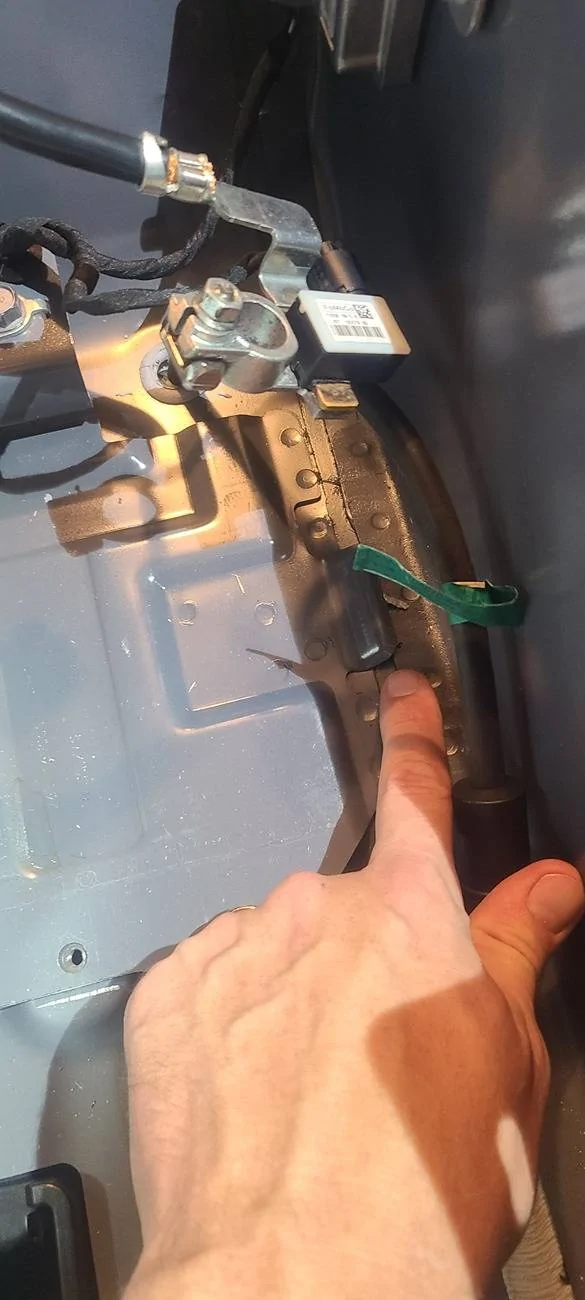

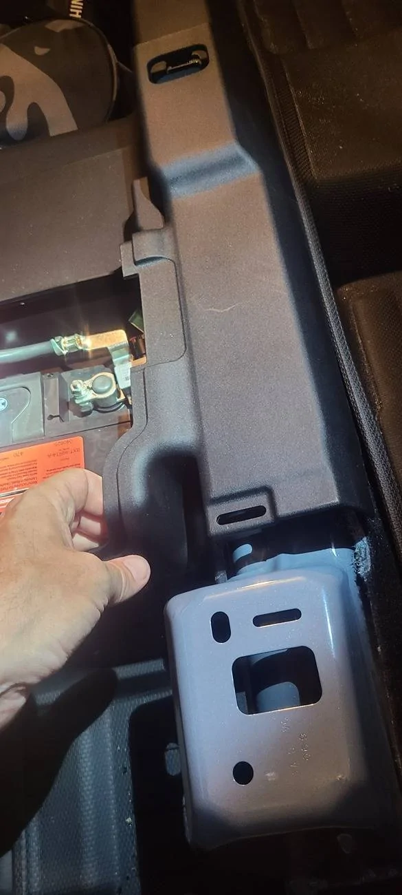

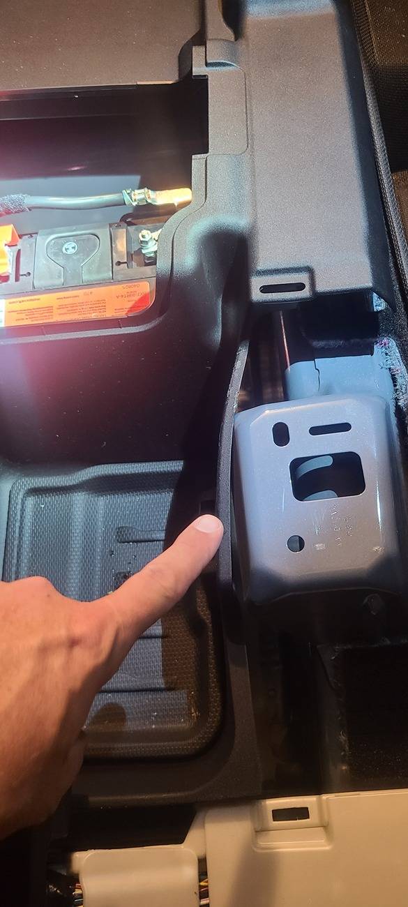

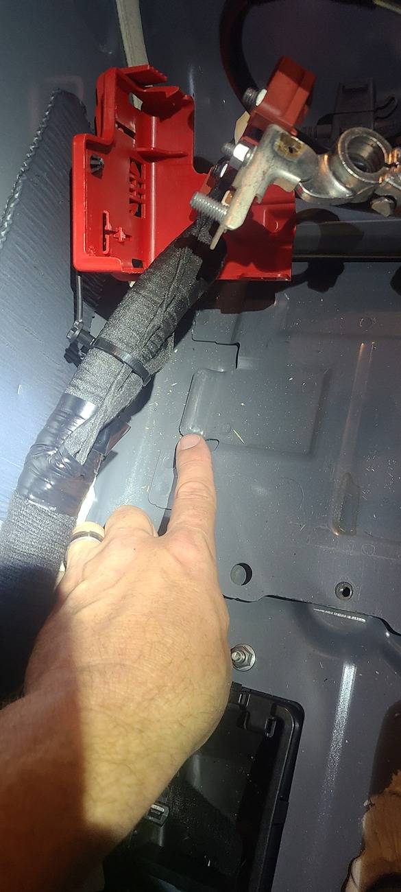

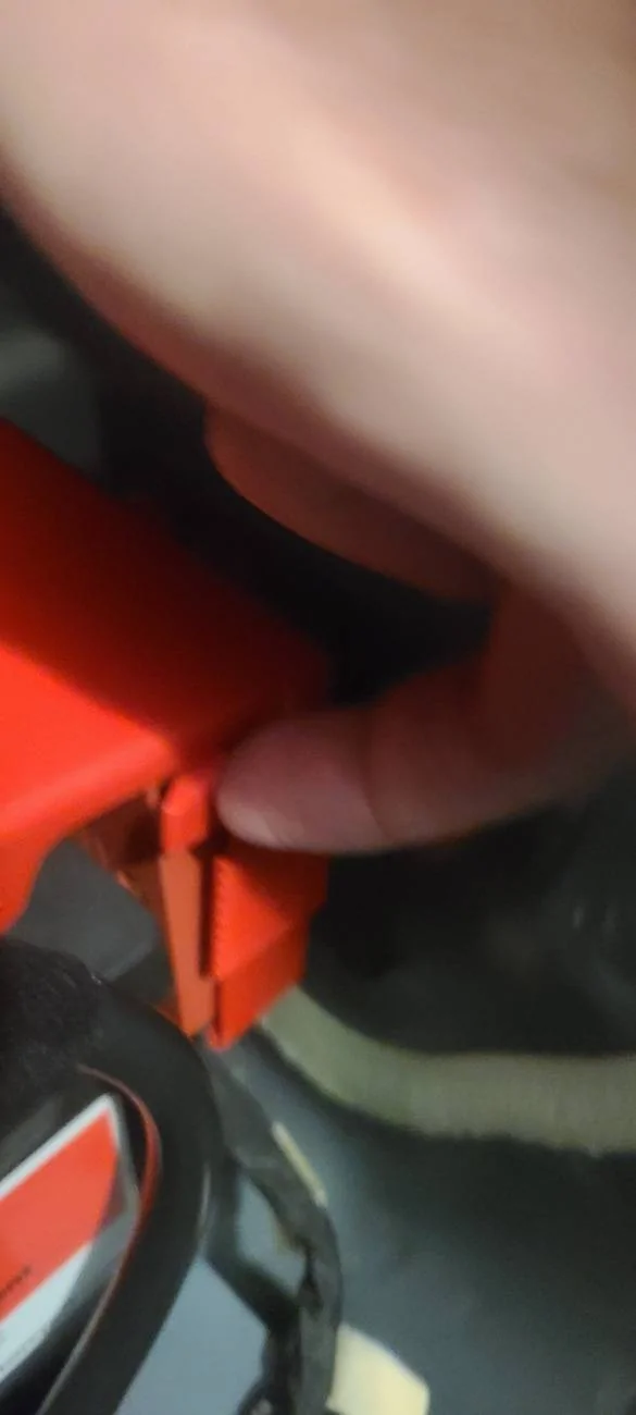

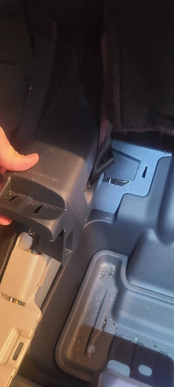

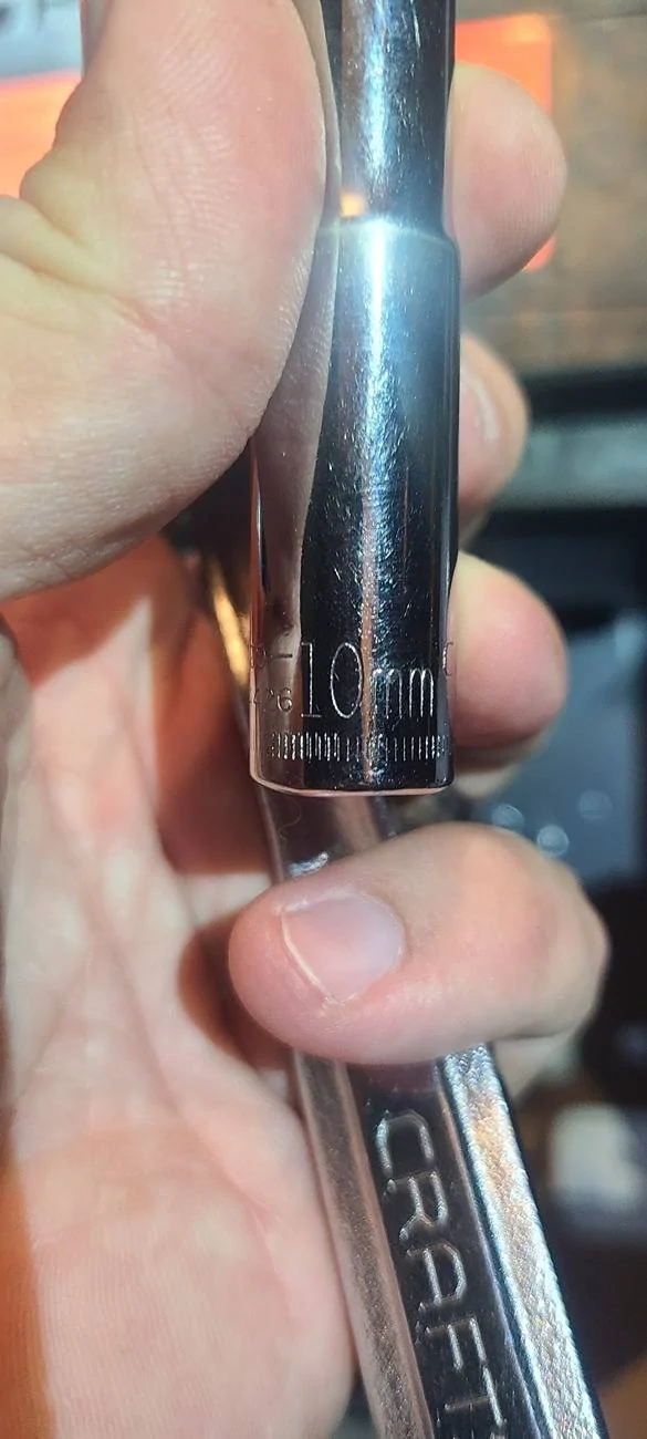

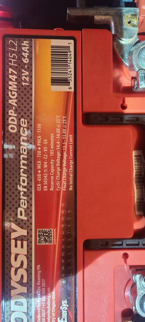

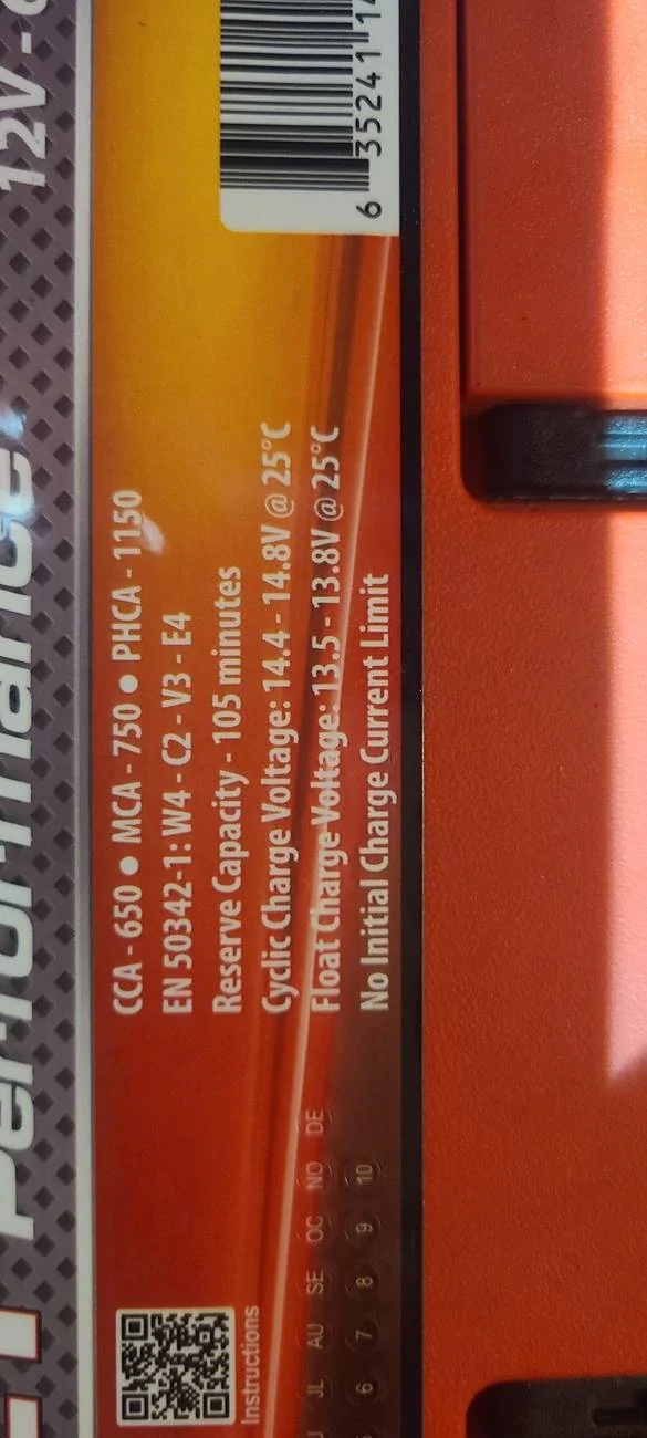

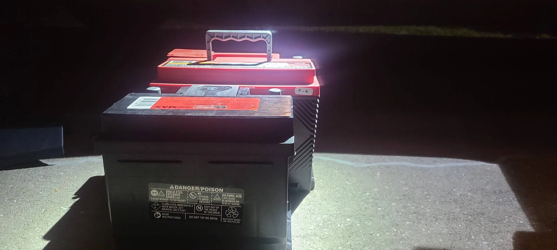

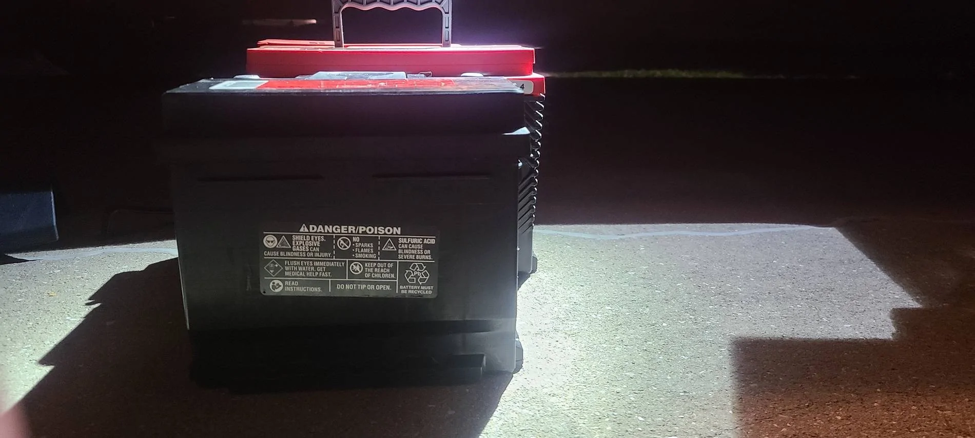

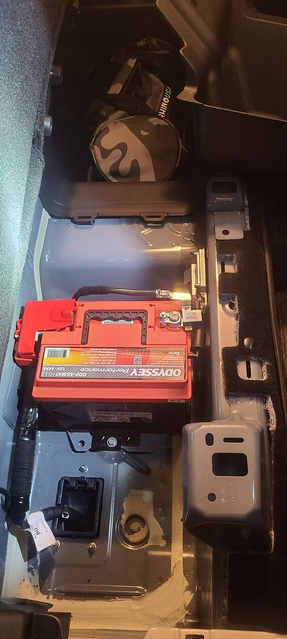

I just replaced my battery with an H5 Odyssey ($275 with a coupon). It's only been 2 weeks, but so far, so good. I appreciate all the advice that y'all had to share. I didn't find many pictures of the process, so I took some myself. I wanted to video it, but ran into some hurdles, so I only got these snapshots.
Caveat: I'm no expert and I just pulled on stuff until it worked. Managed to get it all done in under 1 hour without braking anything. Followed this up with the battery reset (ignition to "on", high beams 5x, brakes 3x, see flashing light, let truck sit 12 hours).
