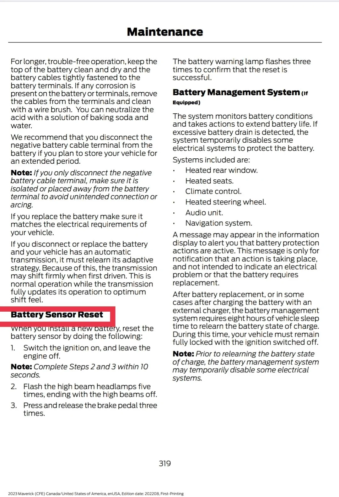

We are on track with ordering an AGM to replace our OEM that is fading fast ('22 XLT Hybrid). My question is how do you reset the BMS? Perhaps this is already in the manual but sometimes those instructions can be clear as mud LOL. TIA

Here ya go.
I hope this is the answer to your question.
I believe it is the "BSR" Battery Sensor Reset as outlined in the manual, after replacing their 12 volt battery.

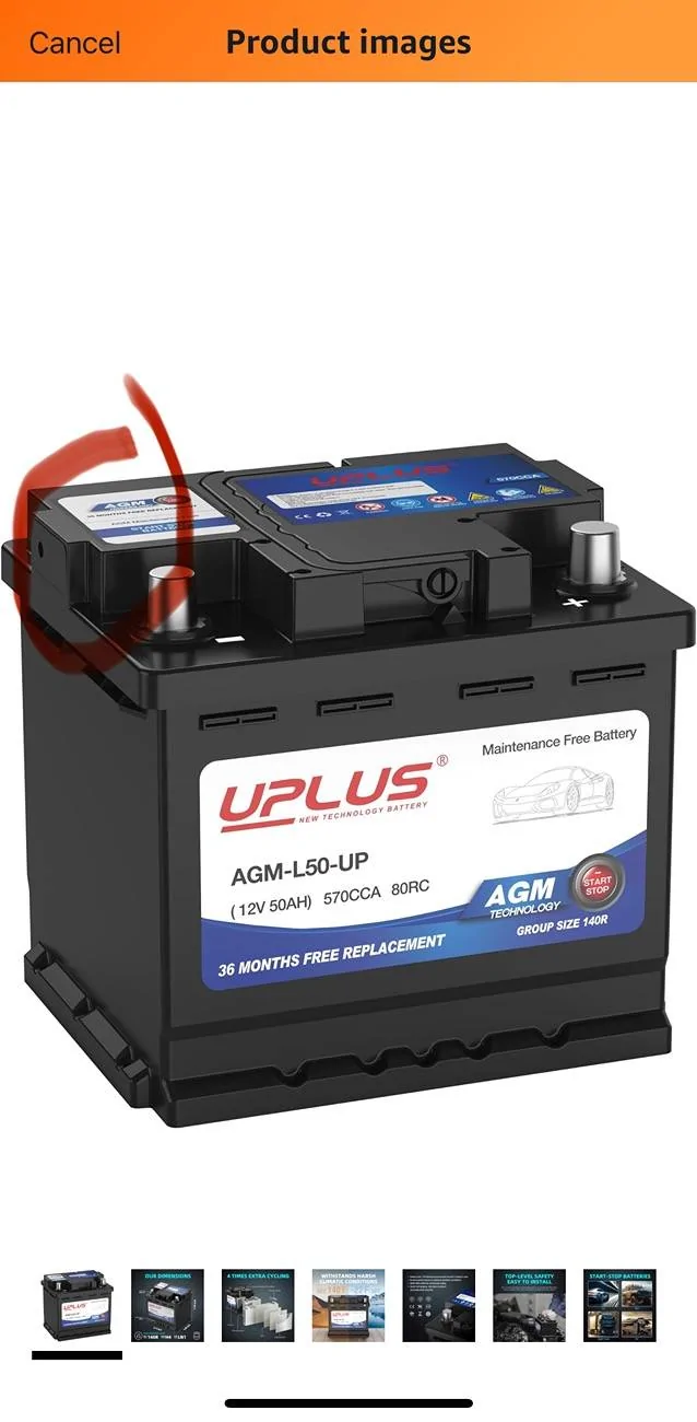

I just got this battery too. I keep seeing people mentioning about vent holes. There are 2 “ports” on both ends but they are sealed. Did you punch a hole for venting?

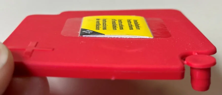

AGM battery vents should have a plastic plug at either end that can be moved/removed like on right side of this positive cover most come with.
Ford Maverick Changing to AGM Vent Plug

I took some pictures of the battery setup in my truck (it has been a while since I installed it!). The new battery has two vent ports, one on each side (like the original Ford battery), which both should be open to the battery interior. Note that there is likely only a tiny venting hole in there, so you may not be able to see it.
And to be honest: I didn't even look for a vent hole inside the ports assuming that the battery manufacturer would not have users have to punch holes in the case. Plus, there wouldn't be a need for a sealing plug on the opposite side then either.
So I simply pulled the hose with plastic L-connector from the old battery and plugged it into the port on new battery. Then I pulled the sealing plug from the old battery and put it in the port on the opposite side.
Battery has close to 20k miles on it now with zero issues, no random deep sleeps, all works as it should!

A special note..............It may take up to a full 30 seconds after you pump and release the brake pedal for the brake warning light to flash 3 times. No one told me this and I kept doing the sequence with nothing happening. So I finally did it and waited about 30 seconds, then the brake warning light flashed that I did it.

Those holes are fully sealed spots and there was not plug with my packaging. Can you take a picture of your ventilation ports that have a true vent hole?

This is a stock image but is identical to what I have. I circled a “port” on the negative side. The positive side has the same “port”. Those ports are fully sealed and have not venting.
