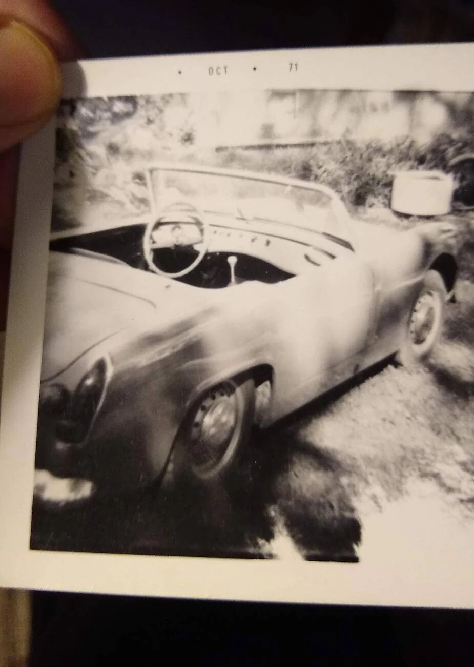

Hell , my first car didn't have door locks , in fact , it didn't even have door handles !
You had to slide the plastic window open , reach inside , and pull a lanyard to open the door .....
Ford Maverick Car locked me out with keys inside Screenshot_20241126-212803
Ford Maverick Car locked me out with keys inside Screenshot_20241126-212753

Very cool pics! I’ve heard that they’ve improved on the technology these days, albeit some might argue that simpler is better..
