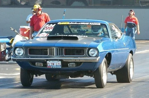

Back during the hurricaine Katrina week when gas was increasing in price exponentially, I began researching E85 as a fuel for my drag racing Plymouth Barracuda. Confirring with a couple top level alcohol racing collegues, I confirmed my upjetting and tuning calculations were in the ball park and set about converting.
Long story short, I ran that car on the strip and street on E85 until I sold it in early 2020. Also wrote a couple articles on the conversion and helped several others tune their own stuff as well. Sanctions changed rules, racing fuel companies came out with E85 blends (at a much higher price than pumps, but with closer tolerance to percentage) and a lot of drag racers are still running it today. Corrosion, phase seperation, water retention, hose deterioration and lots of other myths were dispelled during that time as well, right in my own garage!
My 74 Barracuda still had it's original fuel tank, I did replace the 5/16 fuel lines with 3/8 and add an electric boost pump at the tank to accomodate the increase volume need and replaced the cork composit gaskets in the carburetor with silicone which Holley produced for methanol applications. I did keep the tank full as it was vented to the atomosphere and never had a problem with water absorbtion. Also managed to drop a tenth of a second off the elapsed times with just the fuel change to E85 from Pump Premium even with only 9.8-1 compression. I suspect it would have run exponentially better at 12 or 12.5-1. Fuel economy? Well, with a ride like that, who cares anyway?

Prior to converting my Cuda, I soaked several parts including hose segments and a raw aluminum piece in E85 for 3 months with no indication of any corrosion or softening. The aluminum body of the Holley carburetor was unaffected as well. In 2023 I emptied that jar and tossed or sold all the parts that were soaking now for 19 years! Even that piece of raw aluminum looked shiny and new.
