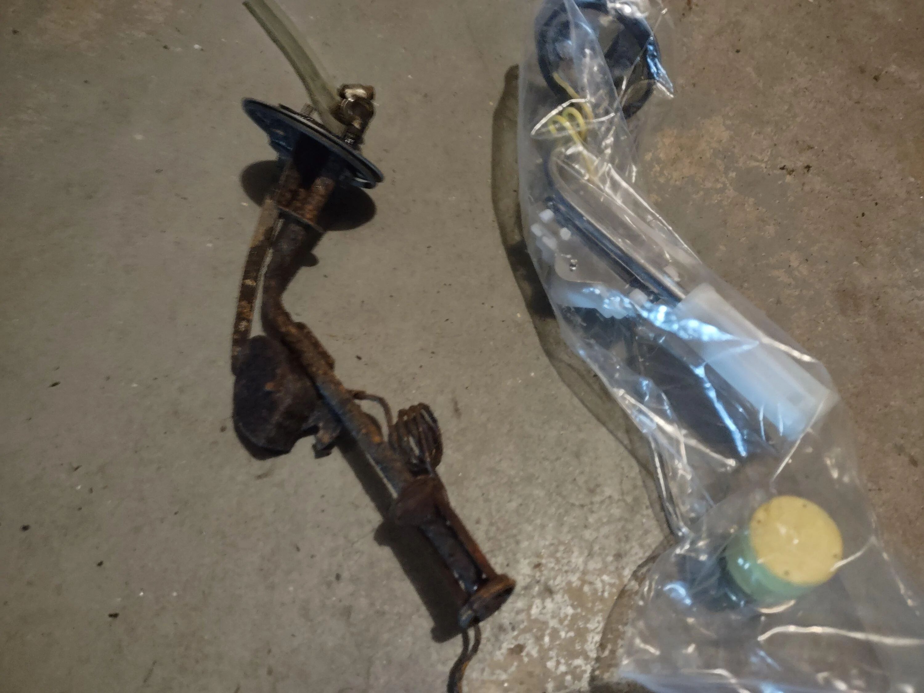

Photo of my 68 Mustangs Fuel sending unit after sitting in 87 ethanol gas for a few years. That said, I use the same in my Maverick.
Ford Maverick Ethanol free gas worth it? IMG_20210820_230747197_HDR
