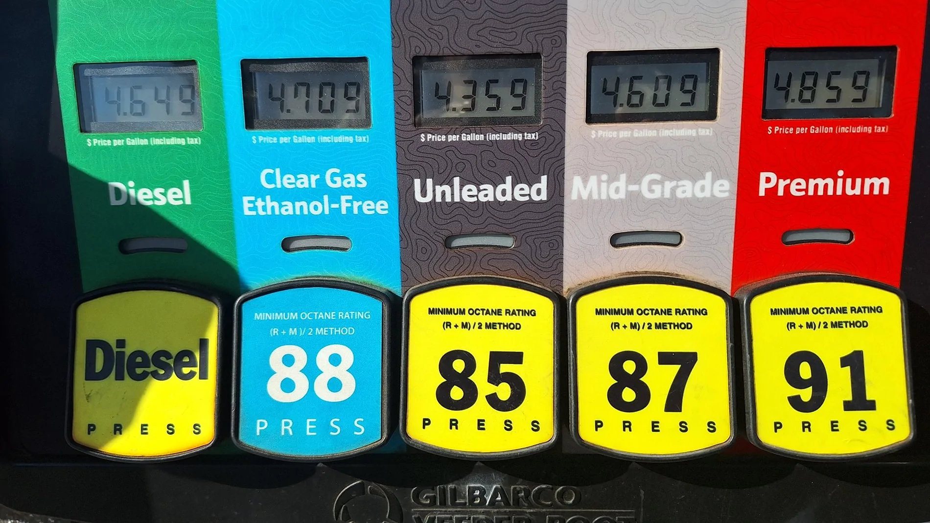

Ford recommends a minimum of 87-octane regular unleaded fuel for the Maverick Hybrid. They say that for optimal engine performance, maximum fuel economy, or during hot weather and towing, Ford recommends 91-octane or higher.
In many high-altitude regions of Utah, where we live, and travel frequently, the lowest regular grade fuel is sold at 85 octane rather than 87. Ford calls for mininum octane of at least 87 octane. Using 85 octane regular in a fuel-injected engine at higher elevations (7,000 ft.-9,000 ft., as is common in passes in Utah) may result in reduced performance and possible engine knocking.

Comparing apples to apples, the price difference from 87 octane mid-grade regular gasoline with ethanol to the 88 octane ethanol-free Maverik Clear Gas is only 10 cents. I don't know how someone says it is 35 cents more. I would never run 85 octane in our Maverick. The octane rating is printed right on the pump.
Because Ford is covering their ass not yours.
For 15 years I lived in Denver and owned an Escape Hybrid 2005 to 2019.
Same setup as the Maverick.
Ran 85 octane almost exclusively for 259,000 trouble-free miles. No knocking ever in an Atkinson engine. Even when towing up I-70 to the Eisenhower tunnel on a 90°F day.
Even when towing a OHV up hwy 5O between Durango, Silverton, Ouray, and beyond. Always lowest cost 85 Octane.
Which by nature performs just like 87 when at high elevations.
I know a thing or two because I've seen and done it. And what incentive do I have to steer you wrong?
Ford recommends you keep 87 in the tank because with the 700 mile range of the Hybrid you could fill up with 85 octane in Colorado Springs and drive on that to Texas. Still, very low risk and I probably did it a couple of times.
what I purchased in Oklahoma wasn't 85 octane.
