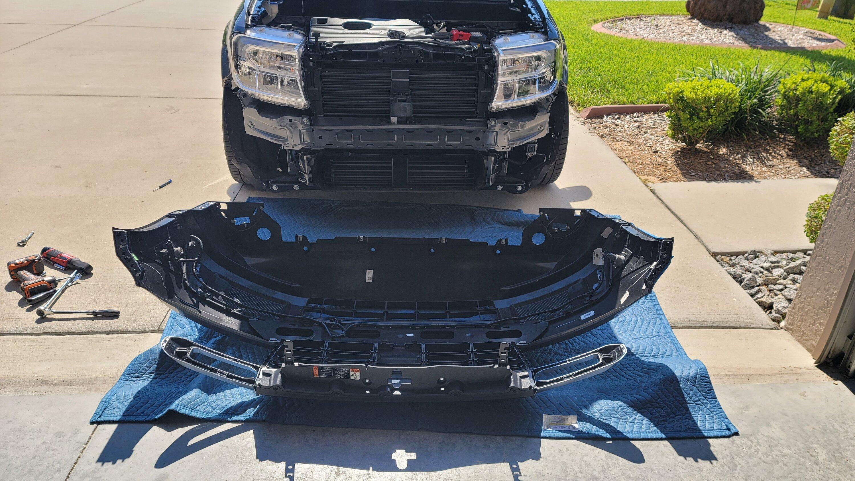

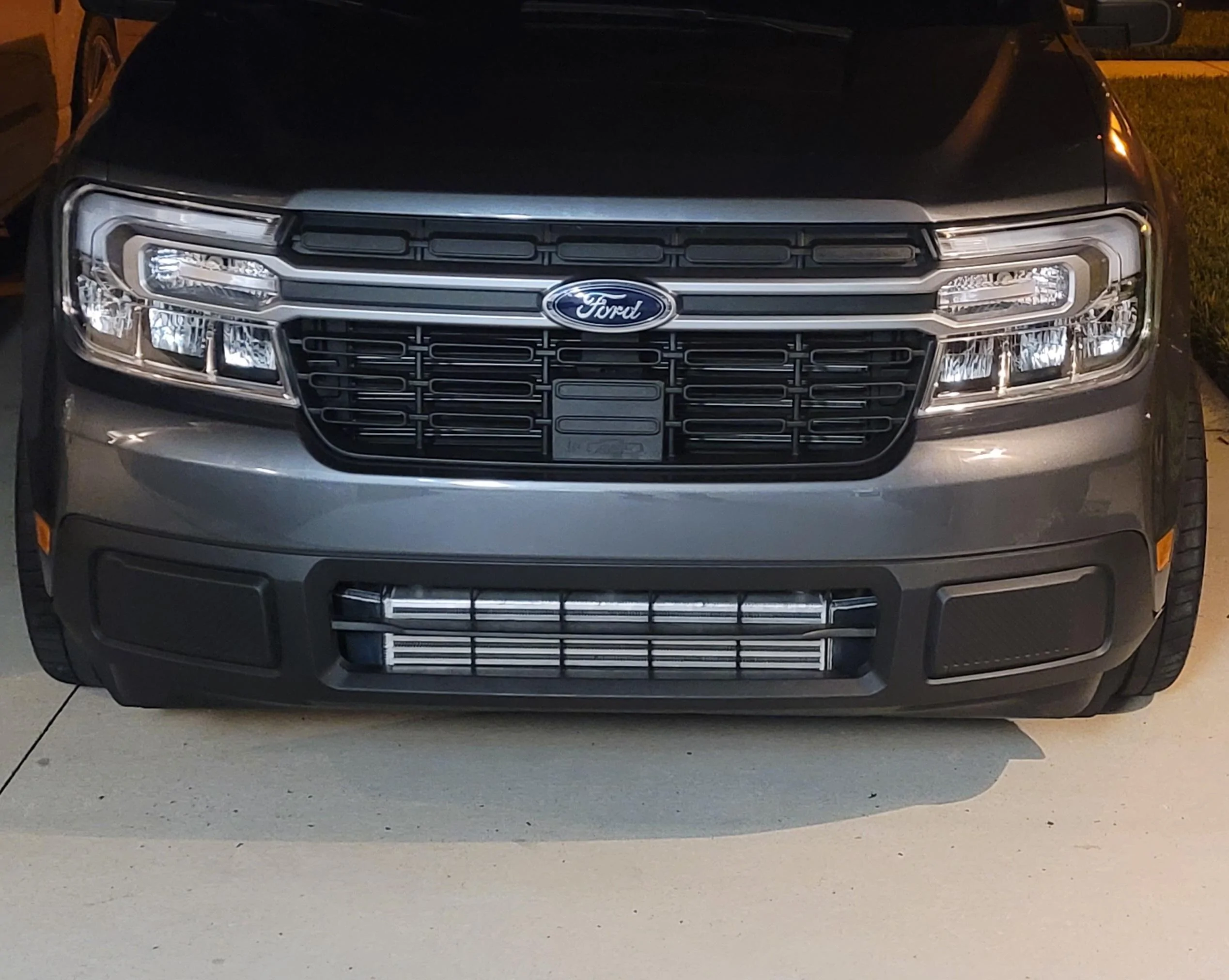

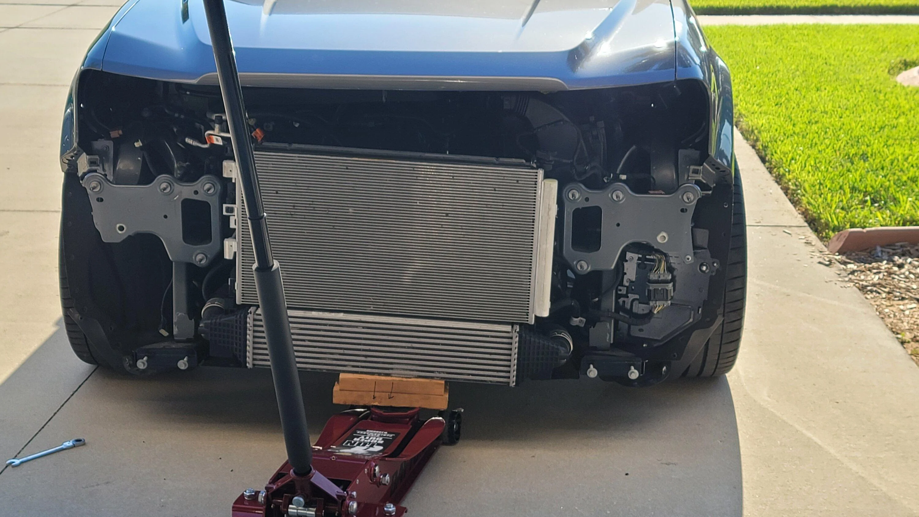

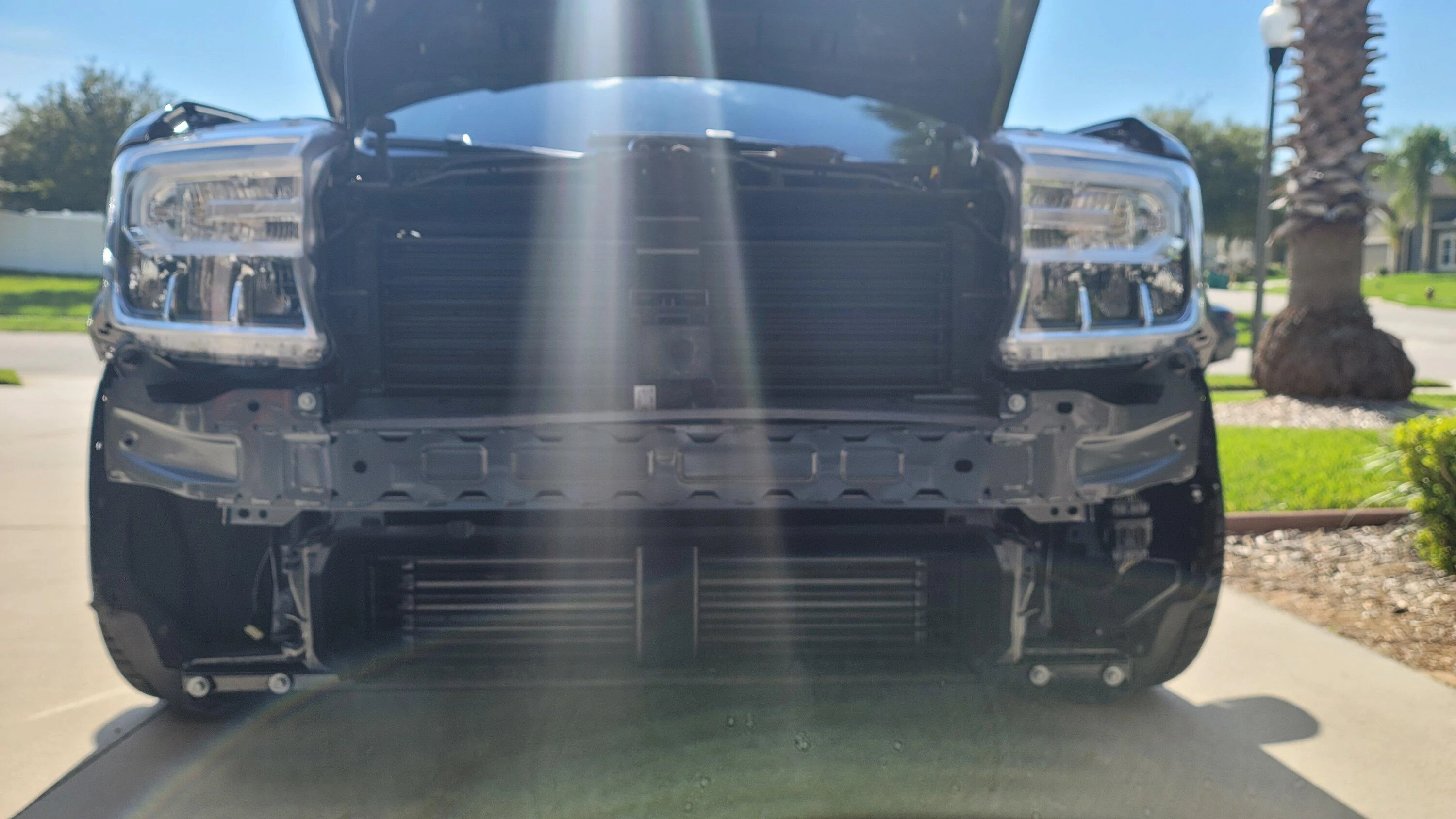

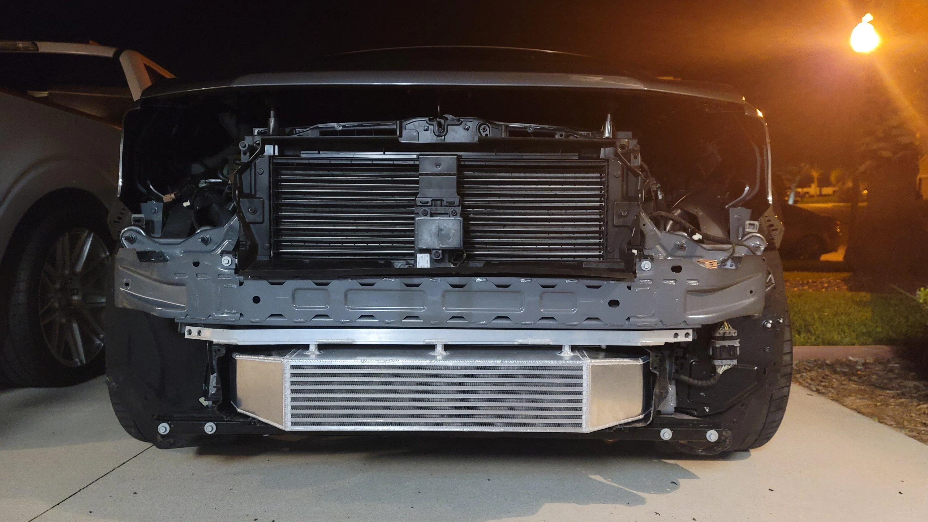

Installed my new Buschur Racing intercooler. ALOT of plastic shroud trimming because Ford made a STUPID decision to make the shroud all one piece that everything is connected to....radiator, grille, headlights. The oem intercooler actually sits behind this shroud and to remove it.... the entire front end has to come off! If it wasn't for the shroud design this wouldn't have been such a pain to do. Learned alot more about the Maverick...specifically how it comes apart, and the new IC looks nice in there! Overall im quite happy. Hella full of body aches but it's in and I'm happy
