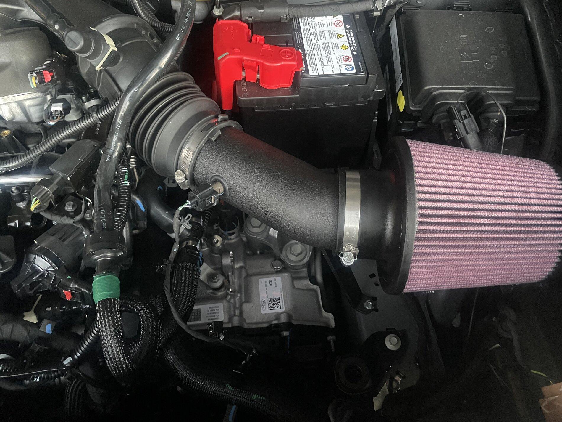

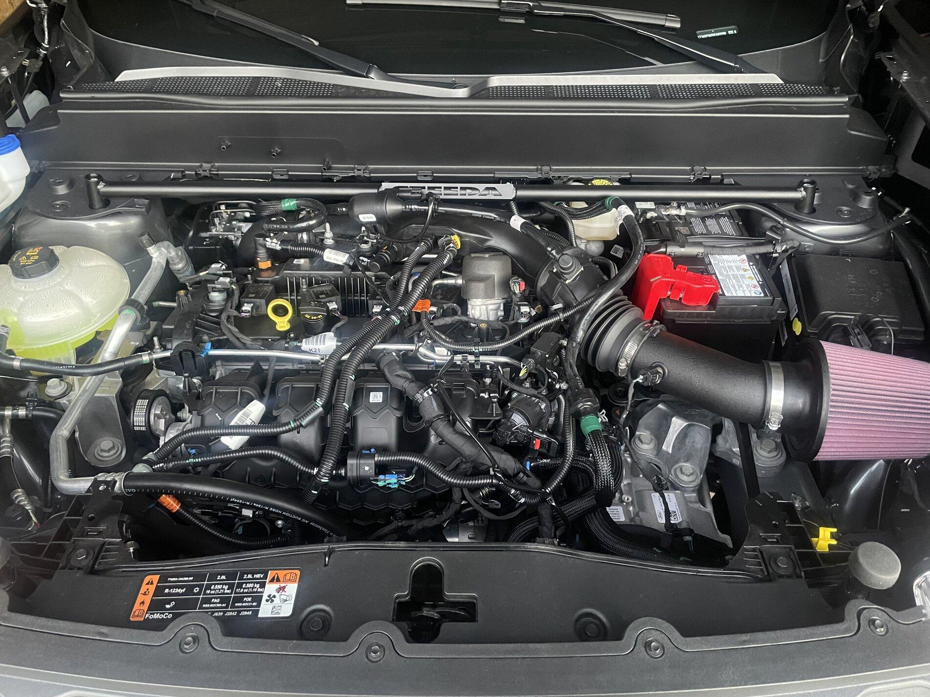

Got and installed my Buschur intake today. So far I’d say the fit and finish are good. Shipping was next day but I’m also pretty close to them. If I could change anything I wish the IAT sensor mounted differently. I’m a little nervous that it could eventually suck the grommet in when it warms up.
Small issue I had with the mounting arm is that the supplied bolt didn’t work. The hole it’s intended for isn’t threaded. I ended up trying to use it to cut its own but that just ended up stripping out the bolt. I used a stainless self tapper.
I can’t speak for the performance yet but I don’t even care. The turbo noises make it worth every penny.

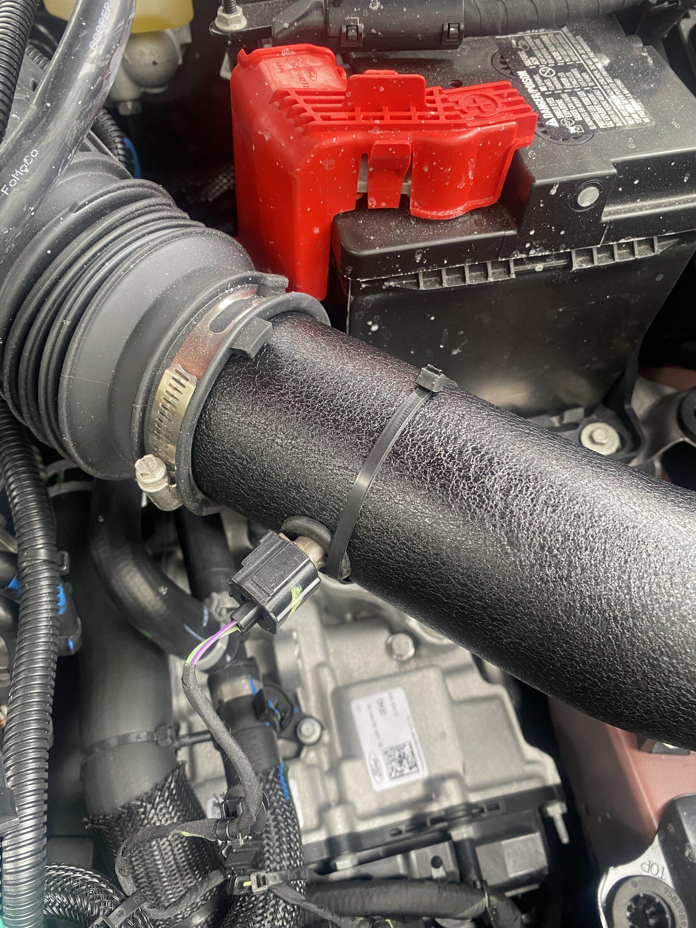

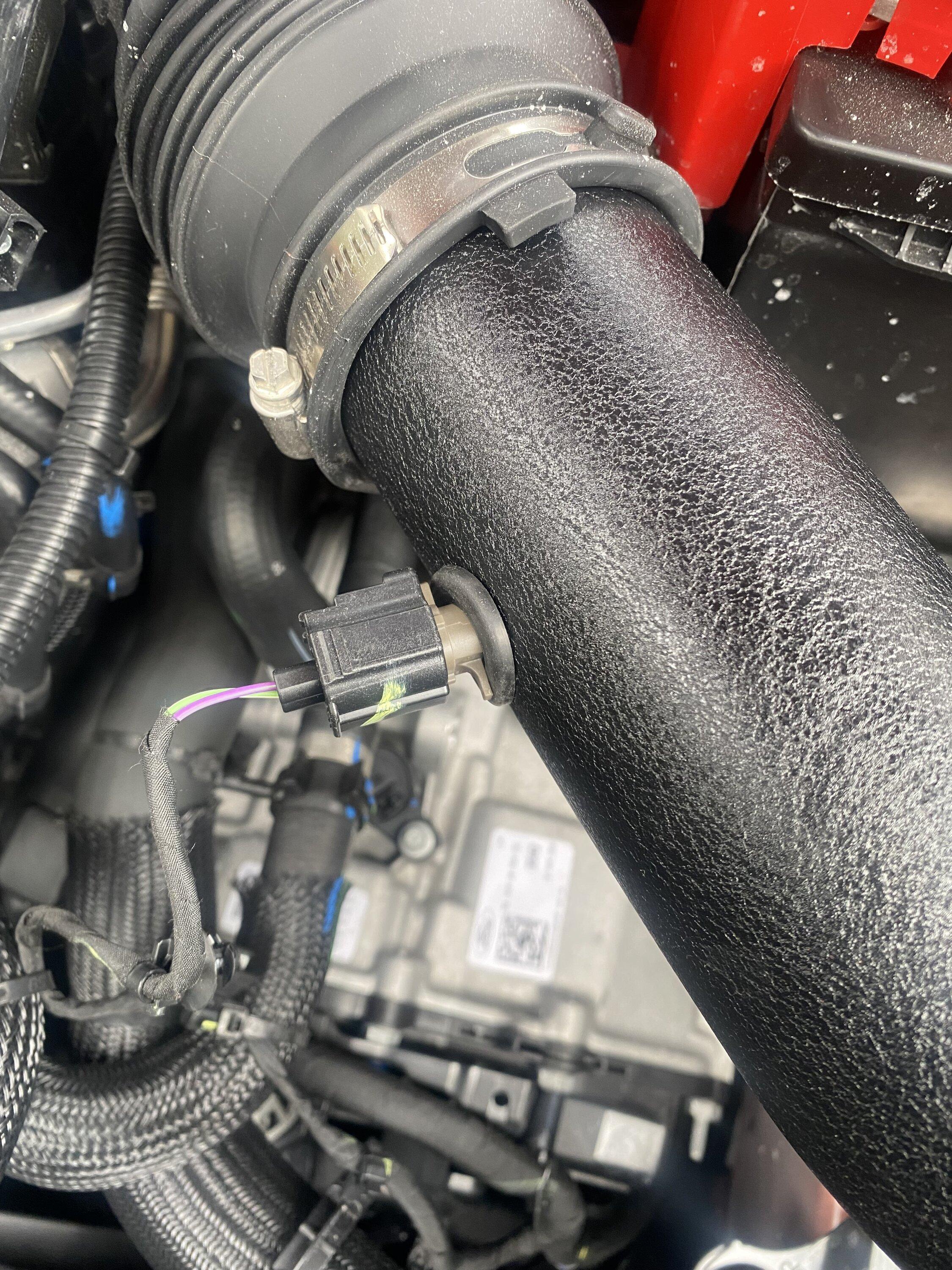

So I finally got my intake today from Buschur. Not very impressive, I mean it looks and feels well made as far as powder coating and the welded bracket. The filter is not a k&n branded one but they are pretty much all the same. My issue is with the MAF sensor placement. It seems very loose and not very secure. The sensor is removed by twisting off and out of the stock air box. Installing on the Buschurs intake pipe is just pushing into the grommet. It also has no way of not spinning around and keeping the element straight for proper air measurement. The sensor has a small tab that allows it to lock securely into the stock air box mount. I don’t wanna break it off to fit flush since that tab also keeps it from being inserted too far into the aftermarket tube. Not sure how long I’d stay with this on the truck. Not too happy with the fitment and how I have to rig it up with a tie wrap.

If you look a couple of posts up his is fully inserted? Pretty sure both tabs should be in there

Dont know if you tried but it looks like there is a release on that insert. Separate the tan from the black and install the tan clip from the inside of the intake, then clip the black side. Would require removing the intake though.

Yes that’s to get the plug off the sensor. I unplugged from the sensor then twisted it to remove it from the stock tube. It’s keyed so I have to turn and pull the sensor out.
I don’t see why it should be inserted from the inside, figure since it came with no instructions it would be self explanatory. It would still be loose as hell that way anyway. Possibly even get sucked in if that little tais not there to hold it back.
Idk
I might keep it on for a bit then remove it for a better set up.
I already emailed the manufacturer.
