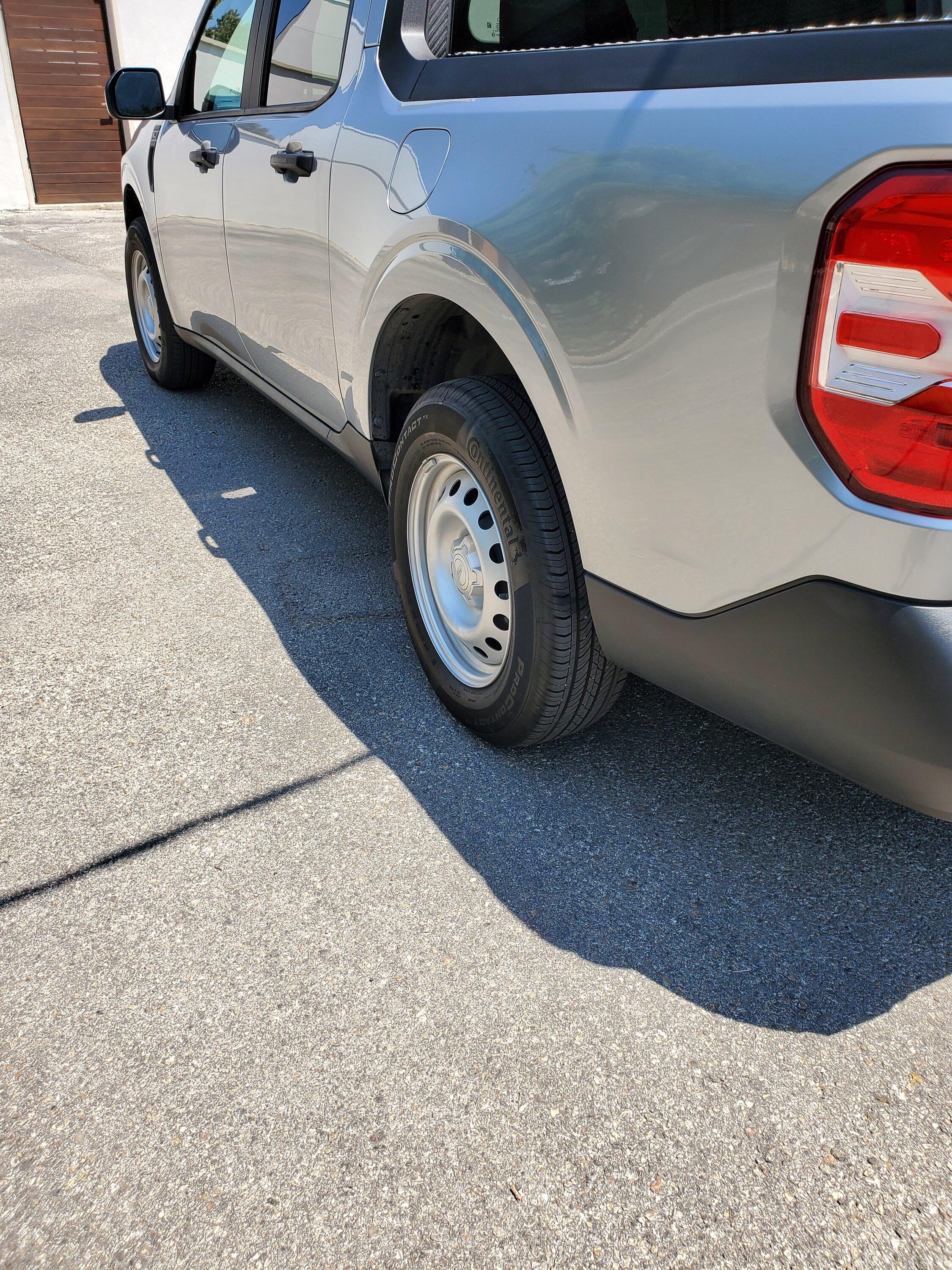

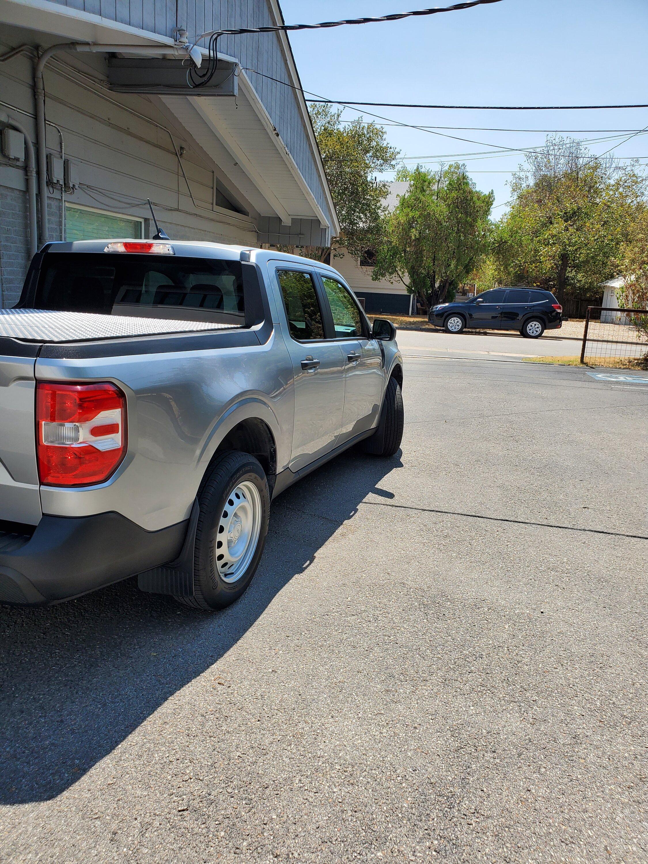

After 10 months and 6500 miles, parked mostly outside in Texas sun. Yes my black trim was fading. So I sprung for ceramic detailing (Next Level Ceramic in Lakeway, Tx) So far just spritzing with soap and rinse at the self serve carwash has recovered the waxed look. They said the trim drank up lots of coatings, was very very dry. I just drive to dry though they recommend a micro fiber rub down.
