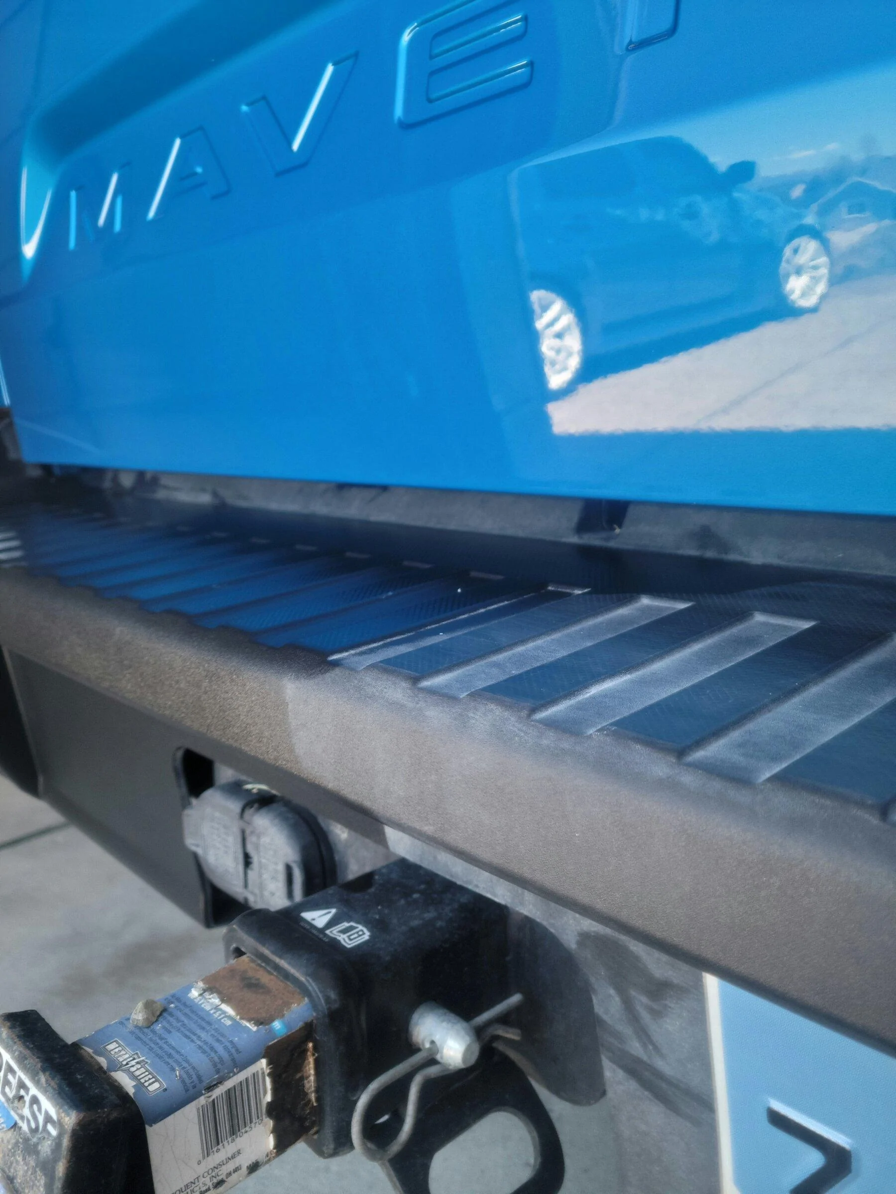

Ford Maverick Exterior black plastic panels fading from sunlight? 20220515_133252
About 4k miles on it. All the plastics looked like this. Figured I would take a picture to show how bad it was this last weekend during my detail day.
which product did you use?
Wow that's worse than I figured I was gonna see. I live up in Maine where they paint the roads in Salt so thick that your car will rust out in a matter of a few years so mine get washed frequently (also got military grade undercoating and protectant from Line-X) but I have had it for 7 months now and haven't experienced the fading but after seeing some of these I may throw some extra protectant on the plastics too

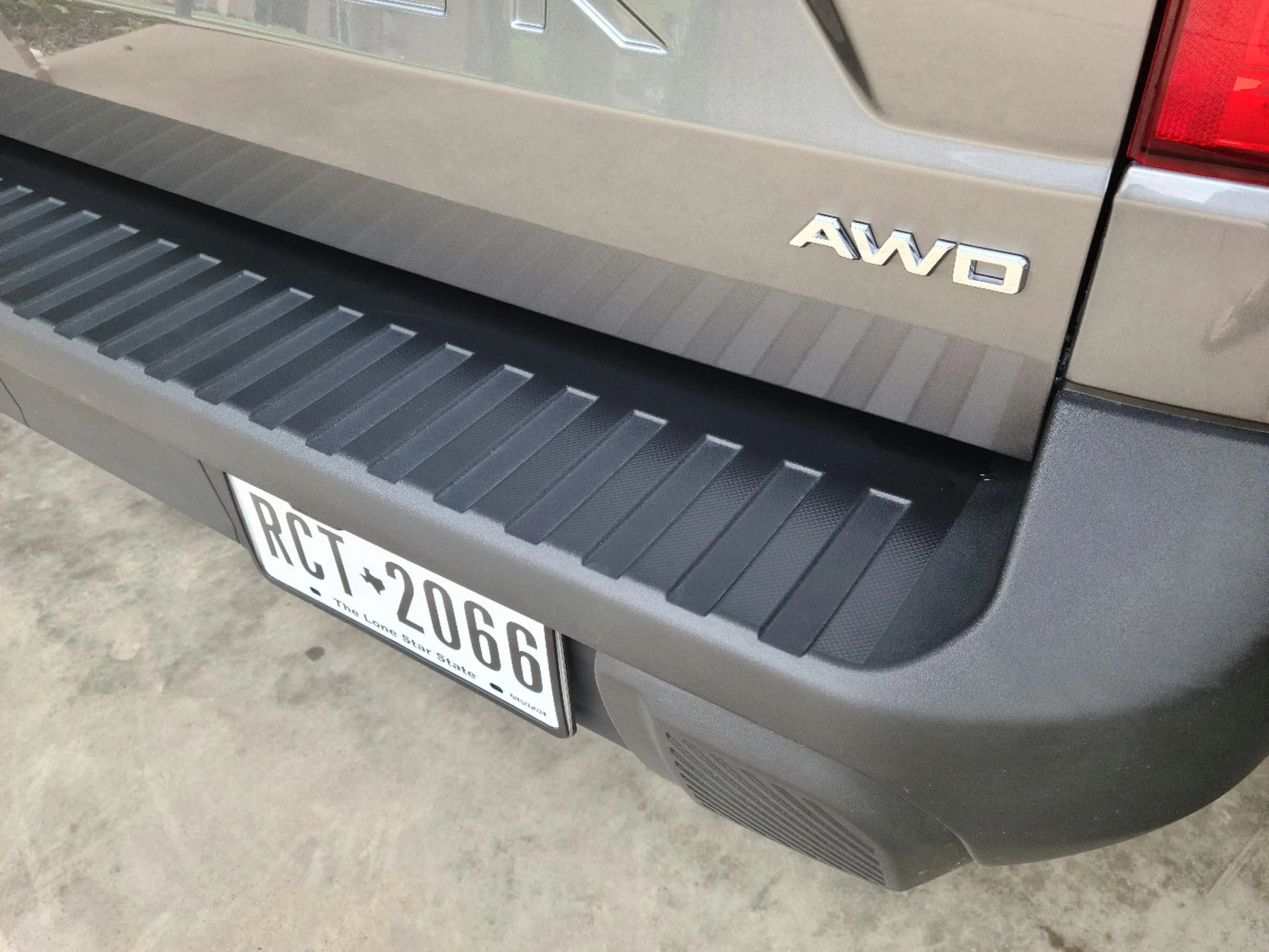

LC48
Oct 24, 2021
456
677
Johnson County Texas
Maverick XLT, AWD, Carbonized Gray. Highlander Lim
Adams Graphene Ceramic spray advanced. Truck has 13,896 miles and spends most of its time on construction sites... I used Meguiars hybrid ceramic spray as a part of my normal wash routine until i finally had the time to strip it clean and use the Adam's. Super easy to wash now
Ford Maverick Exterior black plastic panels fading from sunlight? 20220521_122655
